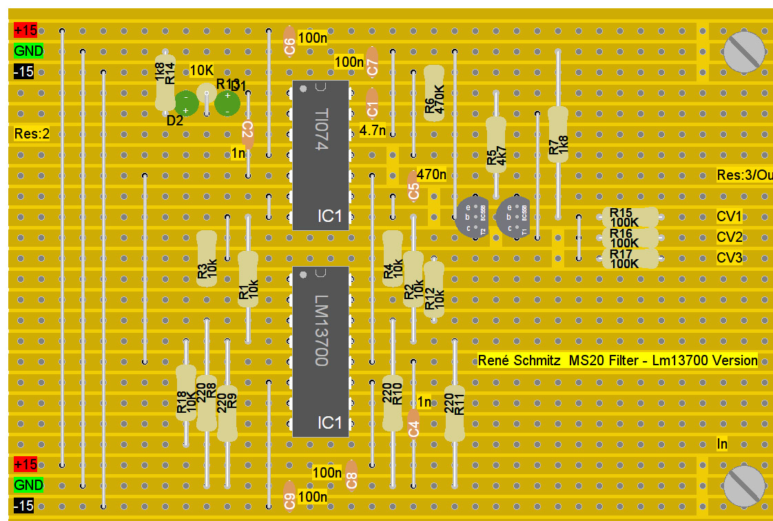

PostPosted: Mon Jul 19, 2010 6:01 am    Post subject: Reply with quote  Mark this post and the followings unread
Funny I was just working on this one by René Schmitz
http://www.uni-bonn.de/~uzs159/rs20.png
It doesnt have any de-coupling caps and I havnt tested it yet but your welcome to have a go, not everything is labelled but I can get back to you on that -Ben

PostPosted: Thu Nov 04, 2010 4:17 am    Post subject: Reply with quote  Mark this post and the followings unread
Sorry if its to late but here it is - still not tested - but I can confirm it soon
Panel Potentiometers
if viewed from the back and lugs counted 1 to 3 connections go like this
Resonance 100K LOG
1 Res:3 - Output jack connect to this lug
2 Res:2
3 GND
Cutoff 4.7K LIN
1 -15
2 -CV1
3 +15
Jacks
Input connects to in
Output connects to pot 1 lug 1
extra cv jacks on CV2 and CV3
a 4,7k potentiometer can be connected across the cv inputs to attenuate it like so
1 - GND
2 - CV1 or 2
3 - CV input jack
Schematic found here http://www.uni-bonn.de/~uzs159/

Cheers! Smile Just hope it works now! D1 and D2 is 0.47uf am I right?
mark_olson
Joined: Oct 26, 2006
Posts: 177
Location: Lawrence, Kansas
PostPosted: Thu Nov 04, 2010 6:47 am    Post subject: Reply with quote  Mark this post and the followings unread
Kritical Audio wrote:
D1 and D2...?
Green LEDs.
Clack
Joined: Aug 08, 2005
Posts: 438
PostPosted: Sat Nov 06, 2010 3:58 pm    Post subject: Reply with quote  Mark this post and the followings unread
yes sorry they are green LED's , you can use pretty much any standard signal (1n914, 1n4148 etc) diode though, still trying out how to make lochmaster do clean layouts, might start translating them in illustrator so I can stylize them better. let me know if you get it to work! mine isn't up for soldering for a few weeks as I have to get a vco to work first! -Ben

PostPosted: Sat Jan 01, 2011 8:14 am    Post subject: Reply with quote  Mark this post and the followings unread
Any confirmation yet? I'm thinking there are meant to be cuts under the three resistors, R15 R16 R17... and one too many solder points on the three hole jumper beside them.

PostPosted: Tue May 24, 2011 12:23 am    Post subject: Reply with quote  Mark this post and the followings unread
Should there not be a cut between the two transistors bases as well?
//s
hoyager
Joined: Feb 16, 2010
Posts: 27
PostPosted: Mon Oct 03, 2011 3:00 am    Post subject: Reply with quote  Mark this post and the followings unread
Hey, I've built this with the cuts between the 2 transistors and between the cv resistors, and have also soldered in the base of one of the transistors where on the layout it is floating.
I am wondering if someone who knows can verify these possible errors, if they are?

PostPosted: Mon Oct 03, 2011 10:58 pm    Post subject: Reply with quote  Mark this post and the followings unread
OK sussed it, funny how the act of asking somehow brings a solution on its own. There is not supposed to be a cut on the layout between pin 11 (TL074) Vee (-15) and the jumper to -15v, which should get the -15 to the chip.
I've used red leds, and the resonance is too much at low settings so I *think* the 10k resistor in the feedback loop needs to be lower? Or I might string 1n4001 diodes to lower clipping level.
Also the BC558's need to be reversed. I've used 2n3906's too which will work orientated the way shown in the layout.
This as well as the cut between the 2 transistor bases and between the cv resistors (just incase for anyone in the same boat as I was building)
Thanks for doing the layout Clack
Choice one
Andy

PostPosted: Tue Oct 04, 2011 2:19 am    Post subject: Reply with quote  Mark this post and the followings unread
Hey thats good! no problem. Wow big caps!
Looking at it the LED's are a bit close aren't they!
I will update the layout , how does it sound?

I used a 10k pot for the cut off, but I think it doesnt matter what value you use, since it's a voltage divider anyway, or?
I used green leds and I really like the strong self resonance. You can use it as a sine wave oscillator too.
Thanks a lot for the layout clack. I am sure the positon of the two 558- transistors on the stripboard is correct though. It also matches the circuit layout from rene schmitz.
By the way, mine is powered by two 9 volt batteries and it works just fine.
