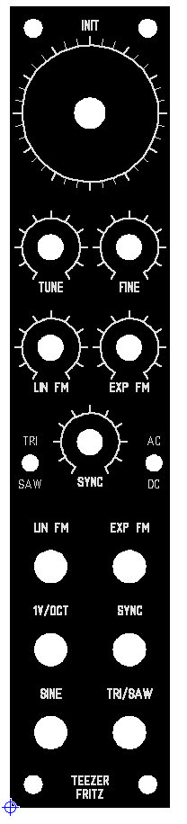

PostPosted: Sat Nov 05, 2011 2:38 am    Post subject: Reply with quote  Mark this post and the followings unread
WOW. Got a new sound palette.
Got the Teezer up and running behind a muck-up panel,
a ten-turn pot for Init was really helpful for dialing in some of that magic.
Still unsure if I go for a ten-turn pot for tune or the course/fine combo.
Tried a switch for sync but I was missing some mojo.
Thank you Fritz for this great VCO.
