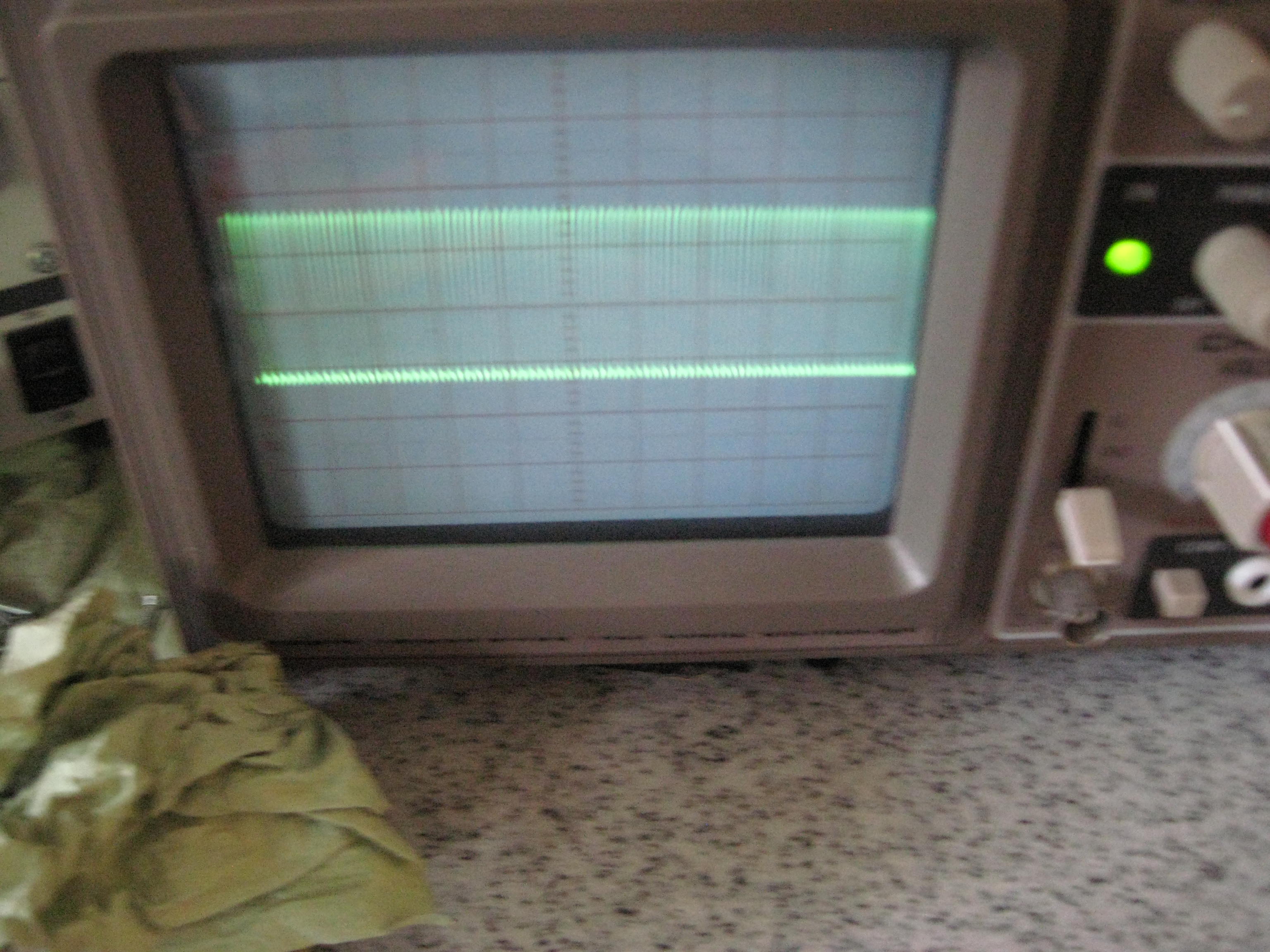

PostPosted: Wed Oct 12, 2011 5:53 am    Post subject: Reply with quote  Mark this post and the followings unread
All the percentages are aproxomations.
It was one of those cases where you wish you had a third hand!
0% or 100%
 Filesize:  841.68 KB
 Viewed:  165 Time(s)
20-30%
 Filesize:  738.09 KB
 Viewed:  160 Time(s)
50% (Best it gets!)
 Filesize:  785.47 KB
 Viewed:  173 Time(s)
Around 50% Distortion
 Filesize:  834.59 KB
 Viewed:  148 Time(s)
The highest frequency I can trace before it flattens
 Filesize:  780.4 KB
 Viewed:  169 Time(s)

OK the waveshapes are weird and interestingly the amplitude depends upon the frequency. These are clues and I will try to figure out what's wrong there.
