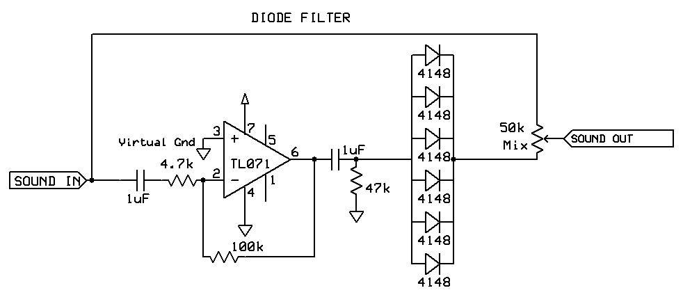

I was messing around with diodes while in chat, and came up with something interesting. A schematic was demanded, so here it is.
It does work with just one diode, but the sound seemed to be very unstable (it would cut in and out and be filtered more or less). The extra diodes seemed to stabilize it (on breadboard at least).

Thanks. I was told that it creates an amplified feedback loop and the diodes act as highpass filters.
I also added a 0.1uF cap to ground right before the first cap near the sound in. The feedback loop was boosting the system noise when no note was on, and the cap stops that from happening.

The cap at the sound in was changing my source, so I moved it to pin 2 on the opamp. It moved the spike to be at the front of the squarewaves instead of the middle. It makes some really cool sounds when combined with lowpass filtering. I'll record a demo and post later.

The only thing adding extra diodes SHOULD do is allow more current through that path. It may be that if there is a parasitic capacitance involved, that adding the extra diodes makes it bigger, allowing some sort of high-frequency bypass to occur.
It would be interesting to change it to one diode and a small capacitance value in parallel and see what that does...
Alternately you could try a large value resistor in parallel.

Under small signal conditions, when diodes are in parallel, only one will actually conduct - meaning that the other diodes are really doing nothing at all.
You can test this yourself with several LEDs. Put them in parallel (all facing the same way) and power with a 9v battery and a resistor (like 270 ohms). Only one will light. Now remove the one that lit up and a different one will light, but only one.
This happens because each diode is ever so slightly different. When a diode turns on, it presents a voltage across it's terminals (about 0.6 volts, the "diode voltage"). Let's say diode A is 0.600 volts and diode B is 0.610 volts. If they are in parallel, diode A will prevent diode B from conducting because it won't allow the voltage above 0.600 volts.
Diode parasitic capacitance is extremely small and not sufficient to cause any perceptible effect in an audio filter.

maybe 1 diode was getting overloaded, and having 2 gives a way for it to pass voltage once the threshold is met so that the first one doesn't overload.
I actually didn't notice any difference from 2-6. I had 6 holes in the breadboard so i filled them...
But just 1 would often be very loud at the start, and it would randomly cut in and out with some noise.
Not sure what an "overloaded" diode is.
This is not something that a diode does. I would suggest that "cutting in and out" is an intermittent connection or another problem. Same with the noise, there is something more going on than exactly what is drawn in the schematic, some bad connection, some resistive solder connection, something intermittent, something that is hooked up in a different way than what you show.
Here is a question to answer - can you make another one, just like it, that performs exactly the same way? If not, then there is something that deviates from your drawing.

Yes - my breadboard is old and often doesn't make good connections, so it is possible that was the cause of the wierdness with one diode, and having a second one gave it another path to go through when the first wasn't connecting.
If you want to use this circuit, then try it with one diode first.
I have it soldered up now and it behaves similar, but the mixing pot has lower resistance and I moved it closer in the circuit to the sound source, so a little bit of the source sound always comes through unless I add some lowpass filtering to it. Also, as I mentioned in a previous post, I added a cap to ground at pin 2 of the opamp. It lowered some of the system noise, but also moved the spike to the front of the wave instead of the middle (I have no idea why that would happen).

The screenshots of the signals don't give voltages, but if i'm reading the schematic right, with an amplification of about 20 on the opamp, it's likely the output from it is a rail-to-rail square wave. That's then being high-pass filtered by the 1u cap/R combination, and then only the positive-going part of the wave will get through the diodes.
