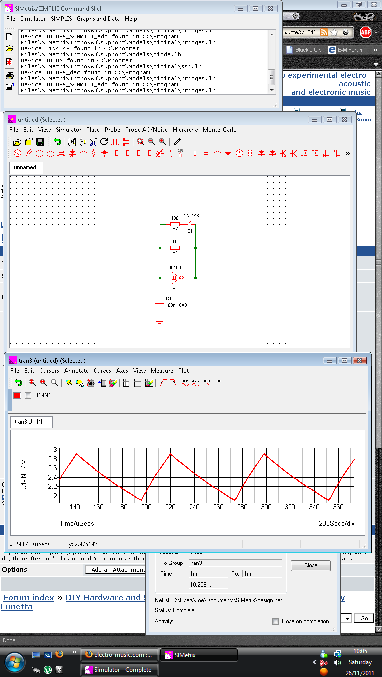

The triangle wave doesnt sound like a bad thing though. What sort of frequency range do you get with the triangle? Can you take a shot of the waveform on your scope?
The frequency range is pretty small, at best I got about an octave and even then with alot of "pulse width" change.
The wave itself was tiny though, only about half a volt peak to peak when using 5V supply and it's peak to peak voltage would increase and decrease as it's frequency changed, untill it became a wonky square wave then finally a pulse wave.
I could stick it through one of the other schmitt triggers to get a pulse wave, never got totally square though.
See attachment below for wonky waveform example.
a simetrix simulation of a circuit which produces the same waveform I observed

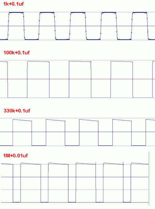

The attached recordings were made from an actual 40106 with actual resistors and capacitors. I will never completely trust simulations.
With a 1k feedback resistor the waveform looks 50-50. At 100k symmetry is beginning to slip, and gets more and more unequal as R is increased. This pattern held for different value caps. The ramp waveform available at the capacitor would likewise be asymmetric.
Although I have a nostalgic fondness for TTL, I wouldn't give myself headaches trying get a predicable or consistent squarewave from a 7414 as an oscillator.

I'll get the ibuprofen ready because I broke my 4093 CMOS chips Rolling Eyes and all I have in the schmitt trigger area are these 7414's.
Those comparisons are great to see, very intriguing, I managed to get pretty jolly symetrical triangle waves/square waves from a 4093 based oscillator.
