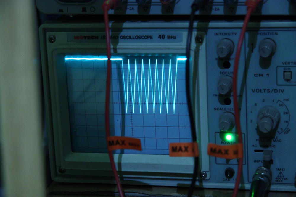

Ok, there's something odd going on, they both seem to generate waveforms correctly, but in quad mode they don't seem to do anything except occasionally I can get it to switch A on and off from B, it stays at +10V constantly then pulses A on and off leaving the DC offset at +10V.. It is literally an ON-OFF pulse, even though it should have an attack/decay slope, not a square modulating it
For example, it is absolutely impossible to create a waveform like this:
Also if I switch modes away from cycle, it will not start again in cycle mode unless I kick start it with an external trigger
This is the best I can get it to do:

PostPosted: Tue Nov 30, 2010 4:01 pm    Post subject: Reply with quote  Mark this post and the followings unread
The three pots (from top to bottom) are amount of external signal in to the PEAKcircuit (not on your panel, so ignore the pot and just go PEAK IN thru a 1N4148, amount of A to PEAK circuit, Amount of B. If you don't have pots ignore them, as it says on the blog.
V2 vs V3 - they look the same to me in this area apart from R47 being on the V3 board, if you compare them you would see that.
So do both boards cycle if left in cycle mode? or do you mean they just stop after a while? Mine stops unless triggered once, which I thought was a feature?

PostPosted: Tue Nov 30, 2010 5:06 pm    Post subject: Reply with quote  Mark this post and the followings unread
all seems to be sorted now, have it syncing some oscillators in a crazy fashion.
Many thanks for all your help, I'm off to build the other pair now Smile

My PSU is exactly +/-15V, but still these strange problems on all four of my 281 V3. End pulse will just work sometimes on some of the 281s, but then only when ASR is selected, AR doesn't give any end pulse. Quadrature works sometimes but usually just gives a continuous gate to both 281s. Cycle mode doesn't work properly either, most of the time it cycles twice then stop.

PostPosted: Sun Mar 24, 2013 2:00 pm    Post subject: Reply with quote  Mark this post and the followings unread
Bump
I still having cycling issues when driving the module on 15V
I took the module apart and checked with just one 281pcb because I tought It had something to do with using one voltage regulator for 4 pcb's but I have the same problem with just one pcb ?? It stops cycling when I go above 14V on the positve rail ? I have the same problem with the 4 pcb's ?
Sombody can help me out plz ?
I tryed to read the schematics I guess it has something to do with the CA3080 IC ?
