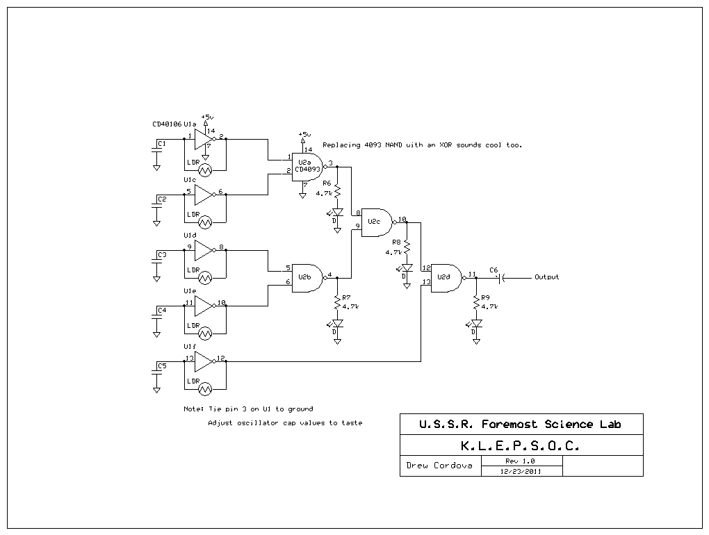

It's just a 40106 with five oscillators running into the inputs of a 4011 NAND. LDR's in place of pots for frequency control. It's got a pretty gnarly range of sounds for being so simple! Oh, and the antenna is completely aesthetic... Couldn't figure out a use for it in time. Oh well!

Thanks for the interest guys! I had fun knocking the thing together. You guys could have this thrown together on your modular lunettas in like a minute! Let me know if you have any questions!
Also, I shipped it off yesterday, so cross your fingers with me that most low-some kapitalist parcel service do not mix up secret package in comedic snafu. Pig-dog end up with clandestine espionage weapon---secret Kremlin agent receive forthwith cheap trinket of Taiwanese origin ensconced gaudy paper.

I made a similar device today which I already had in the works, with LDR control, however the circuitry is differenter (thats a real word Wink ) I used a 4051 and a 4093 as the oscillators.
Your design is lovely and simple, just to clarify; Are the nand gates are used to combine the signals? and make them sort of like this:

Wow, I didn't know you could use a 4051 as an oscillator! Isn't that a multiplexor? How does that work? But yeah, your diagram is accurate as far as I know haha. I suppose this configuration would produce an interesting data stream slowed down huh?
Another thing I tried was to send the out to the clock of a 4040 divider, and then patch some of the slower outputs along with the original output, to a passive mixer. Mixes in some lower frequency stuff which is kinda cool!
While I'm on the subject of the 4040... What happens if you tap two different inputs into the clock? Does it mix them and divide the sum? Does it produce acrid blue smoke?

I really want to agree with you, but I can't think of any way the 4051 could be made into an oscillator with just passive components added ... unless ... some sort of capacitive phase shifting was used, but there would be losses along the way without additional amplifiers. I think it would end up as some kind of analogue bit shifter but it would be a bastard to make.
The truth is I worded that a bit wrong, I used the 4093 as the oscillatoirs, and the 4051 used those oscillators as the binary inputs, the 4051 being wired up as a voltage divider sort of thing with the ... you know what? I'll just post a shcematic in another thread when I have drawn it.
Also I'd go with:
Spacebones wrote:
acrid blue smoke
however you could connect two inputs to the clock via diodes or a gate. This is the concept upon which one of my latest designs works, still in the works, it makes interesting waves ... but thats all, it's about as tuneful as a brick.

probably to make the wave voltage logic level, as the XOR doesn't have schmitt inputs (we could make a fun oscillator with it if it did!) and the output of a lunetta schmitt osc is usually a bit crap from a logic level perspective, especially at high frequencies.

The noise generator XOR thing seems to work fine without the buffers. The outputs of the XORs oscillate at high frequencies, even when you give low-frequency inputs.

Ah that is what my simulations revealed, I thought they were wrong, but this could be acheived by gating a high frequency 4093 NAND oscillator with an XOR too, the four XOR gate method seems a bit over the top to me thinking but whatever boats your float. Laughing
