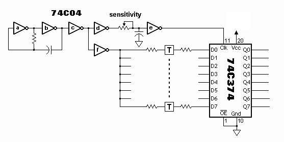

richardc64
Joined: Jun 01, 2006
Posts: 679
Audio files: 26
PostPosted: Sun Jan 08, 2012 7:35 am    Post subject: Reply with quote  Mark this post and the followings unread
I'm always fascinated by the willingness to put one's body in direct electrical contact with active circuitry -- low-voltage, static-sensitive or not. See this:
http://www.paia.com/ProdArticles/touchsw.html
The advantage of this type of touch detection is that since it relies on changes in capacitance, the contact need not -- and indeed SHOULD NOT -- be a bare conductor. It could have a coat of polyurethane or some thin insulating material and still operate.
Rather than tinker with the time constant of each touch plate, varying the clock rate, via R2, should provide a Sensitivity adjustment.

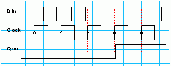

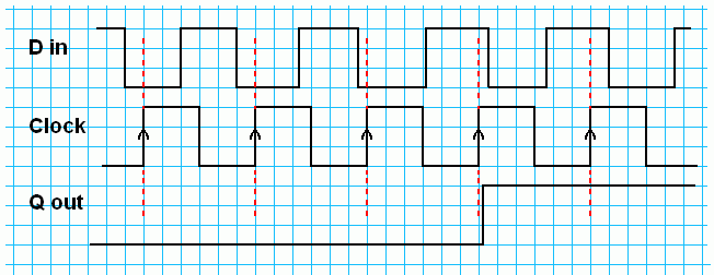

As for circuits that never made it off the breadboard, I've attached one of mine. Resistor and cap values were missing from my original hand-drawn schematic, so experimenting will be necessary. In operation, as long as D is low when Clock goes high, Q will be low. When point "T" -- which should be insulated -- is touched, the rise and fall of D are delayed. When they're delayed long enough that D is high when the rising edge of Clock arrives, Q goes high. To get 8 more contacts only requires another 8-bit latch. 74Cxxx is getting hard to find, but 74HCxxx should work.
There's a similar Ian Fritz circuit here somewhere, but I couldn't find it.

highly exaggerated
