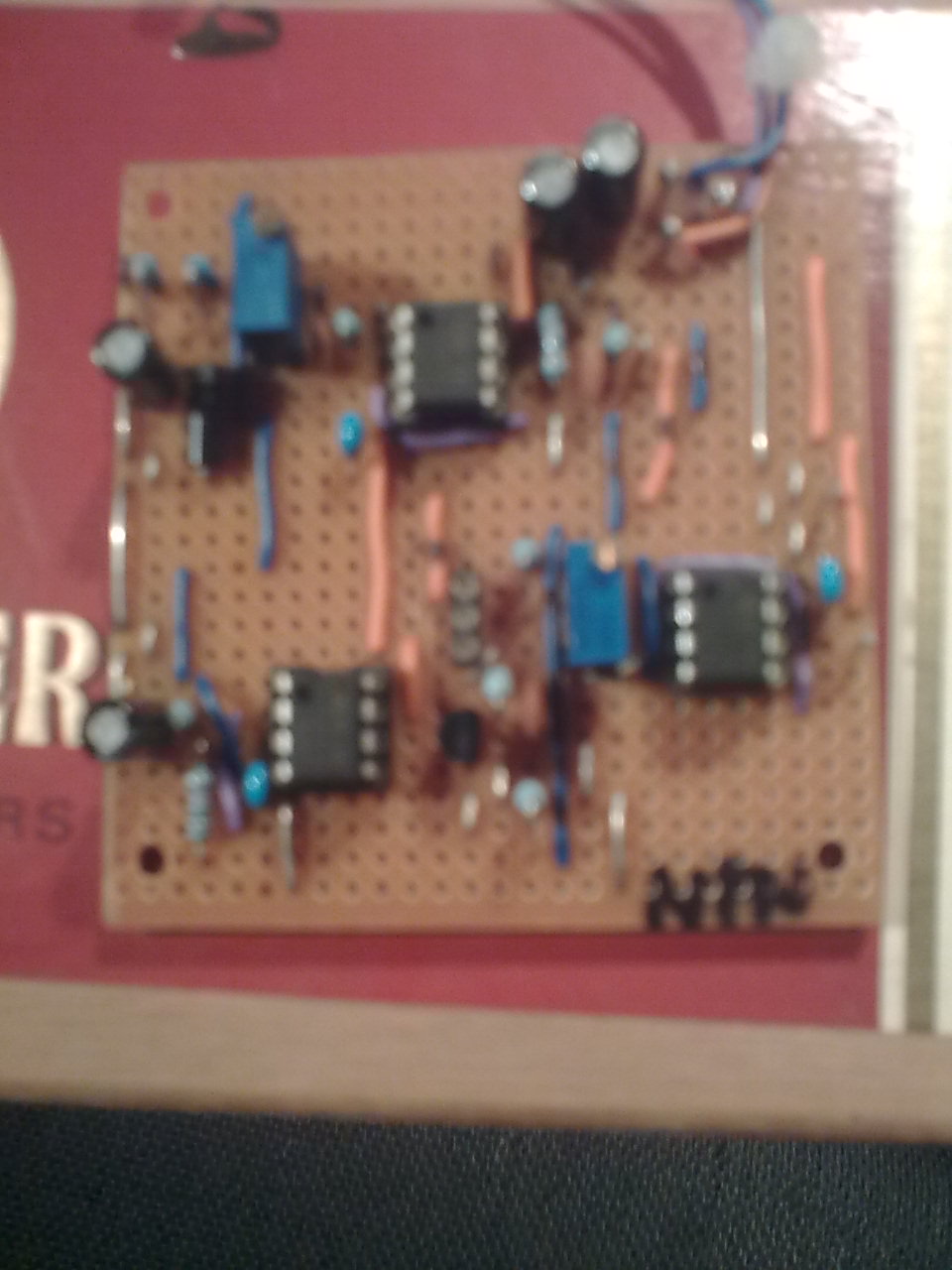

I built this npn matcher from Ray Wilson's schematic. this ones good for VCOs. i built the Moog NPN/PNP matcher aswell which i use for filters, etc.. Very Happy Very Happy
Sorry about quality crappy phone cam.
