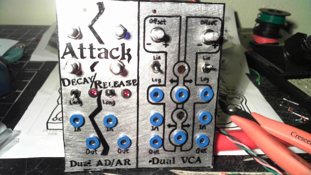

Surprised no one has created this thread yet!
Just finished a Dual AD/AR - Dual VCA modules. EG is Ian Fritz's design made with BugBrand's PCB and the VCA is MFOS design with a board made by myself.
This last panel should wrap up my latest suitcase build! Whoo hoo!
Edit: Video here: http://youtu.be/yUUQjkOQDQA

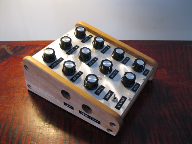

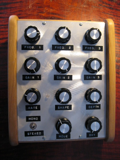

Finished up a triple bandpass resonator, very much like the clone of the korg fonik has documented.
I added a level control for each BPF, dry signal level, and an LFO that I like which fades from triangle to sine to rounded square.
I also did the trick where there are actually two LFOs, one running slower than the other, and a switch to select three modes of LFO action, very much like the MOTM triple resonant filter.
Stereo mode just pans two of the BPFs to the sides, while panning the remaining one in the middle.
Thanks fonik for the idea! Sounds great on everything, especially nice on a rhodes or wurlitzer.
Keep em' coming:)
jordan

that's awesome! can't wait to get my hands on one of those quantizers!

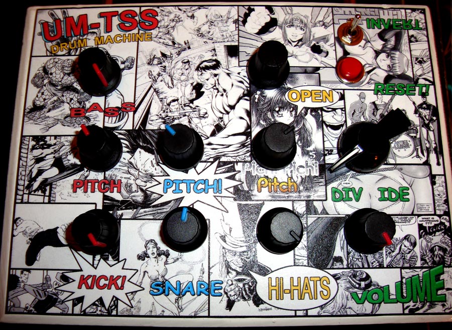

PostPosted: Sat Jan 28, 2012 7:29 am    Post subject: UM-TSS Drum Machine Reply with quote  Mark this post and the followings unread
This is a simple drum machine that takes a clock signal, sends it through a divider, and uses the first three divisions for the rhythm. The first division filtered to be the hi-hats, the second is the kick and the third is the snare. This creates a "four on the floor" dance beat. I filter all the divisions to get the desired sounds.
More info in the build thread: http://electro-music.com/forum/topic-49054.html
And on my website: http://www.jacobwatters.com/um-tss.php

Cynosure: I love the artwork Very Happy Lots of detail and attention went into that didn't it? It's great Very Happy

Looks amazing!!!! Can't wait to hear you use it in a performance / improv Smile

This is a great idea; I had been thinking of similar ideas of using clock dividers for simple drum patters. I have a MiniPops that I wired up to produce a similar beat, which I've added switches to create vatiations and cancels.
I was thinking about trying to insert a pulse delay circuit to add "shuffle" to certain divisions

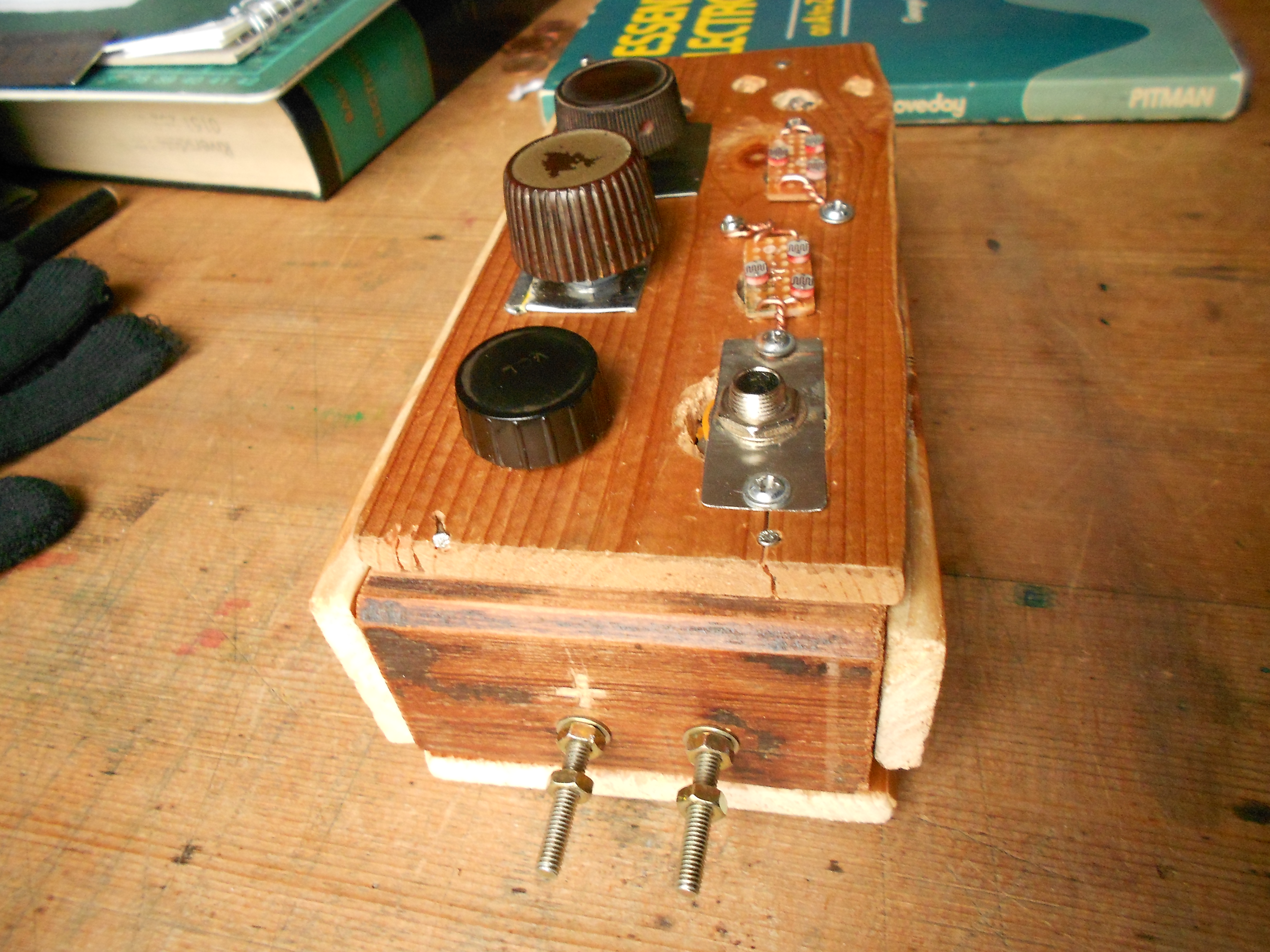

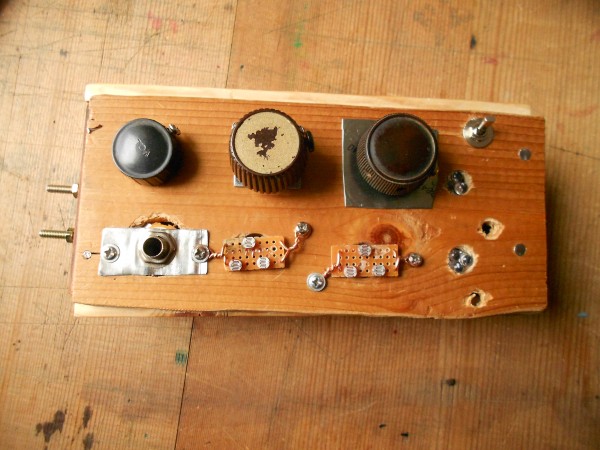

This is my luminescent heterodyne-somethinger something or other, I can't remember what I called it now ... I'll make a thread for it in the lunetta forum with a circuit diagram and more info, go see!
This one is a genuine junk synth Very Happy
P.S. Luminescent Heterodyne Signal Decoder, thats what I called it!

Haha ! I like that style ! What do you call it ? I guess the extra holes are for advanced inner temperature regulation, right ?
Me too. The knobs are perfect. Very Happy

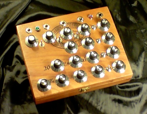

In a way less avantgardistic style than Jingle Joe's production, let me proudly (euphemism here) present my cigar box Mutant DS7 clone !
I'm happy with the result, happy that it's finished, happy with the process of doing it. I learned a lot, thanks to those here who helped (richardc64, metal_head_82, Jingle Joe and Fonik among them).
There's more about this project in the last pages here.
Complete with the pedantic black satin background.

well... let hear it!

Yeah, let's make some art !
I already posted some sounds, like this one or that other one, which among others can be found at page twelve of the mentioned topic.
But. I've just been playing with the loop feature, including the output of a glorious if not performant Redson DU-106 © echo unit in the feedback path, and man it just takes me to another domain that I didn't even suspect… (main word here : NOISE) It's weird to build something to only discover its actual capabilities afterwards ! Now I NEED to explore that further !
