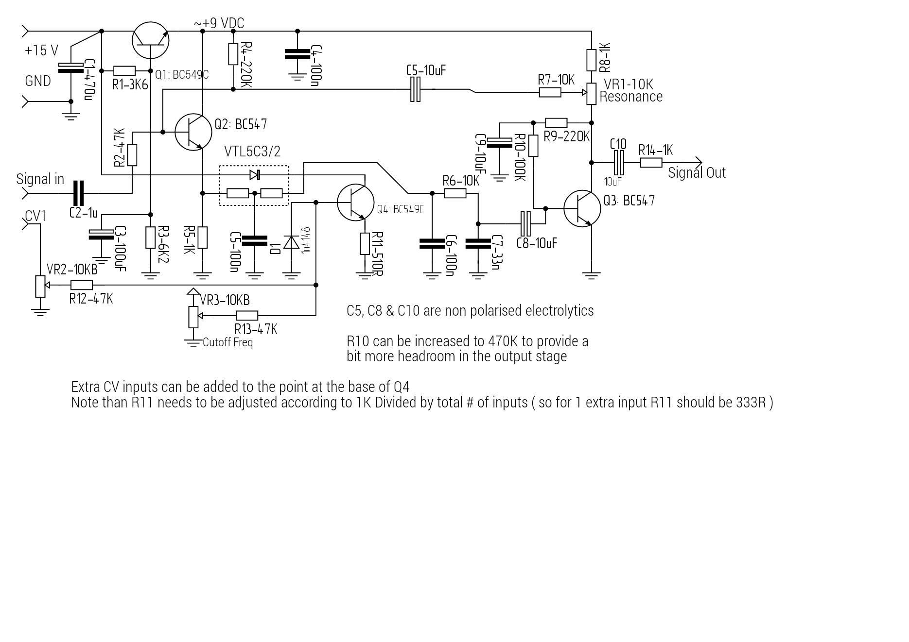

I've done a fresh schematic showing the vactrol and a simple driver for the vactrol LED. I also included a simple voltage regulator to keep the supply around 9 volts ( assuming a +15 volt input. If using a +12 V supply change the 3K6 resistor to 3K0.

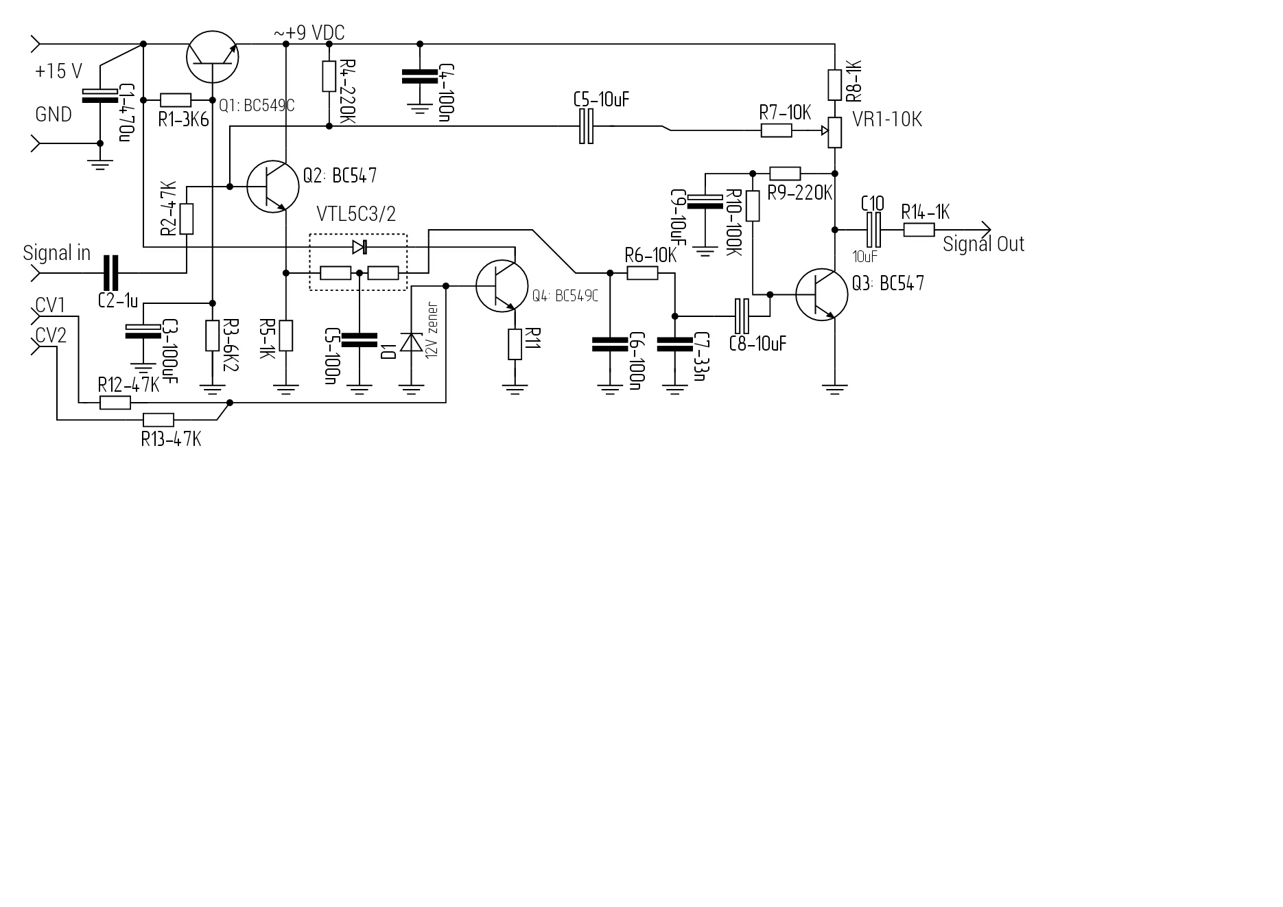

This makes a great little VCF when adapted with vactrols! Have made a few wee refinements to the schematic. Perhaps someone could design a PCB for the vactrol version as I'm not great at that type of thing, though might build it on stripboard, ATM it is on a breadboard.

I don´t know if you´re interested in the sound of the whacky transistor configuration *which probably guarantees strange behaviour* or in the simplicity of it...? Because it would be easier with opamps, which I have built several times.
On both outer legs of your double ldr you could put a little series resistance like 2k or 3k3, because the resistance of a vtl5c3 can become very small and the transistor (or opamp) won´t be happy driving a capacitive load to ground (aka instability/squeeling). That´s for the first resistor and the second to keep the resistances of the RCsections equal in value.
With one or two transistors you can build excellent lin or log led drivers: look at Scott Stites Multiphase project! (or René Schmitz´ cmos vco) thumb up

Simplicity is always very seductive, but on closer inspection there are often limitations that are unavoidable without the addition of more complexity.
I had thought about adding series resistors as personally I don't like the misbehaviour of this circuit that occurs with high cut off and high resonance settings.
Do you think there is merit in using an expo converter to drive vactrols, as they are inherently non linear in nature?

I tried with a bc547a (should be 220 HEF max)
I do get very faint variation at the end of the cutoff pot. By the way, I used a lin pot, could it be this?
Otherwise, i guess it's my layout... It's the first I made so I might need to have a second look Very Happy
Thanks for the help!
