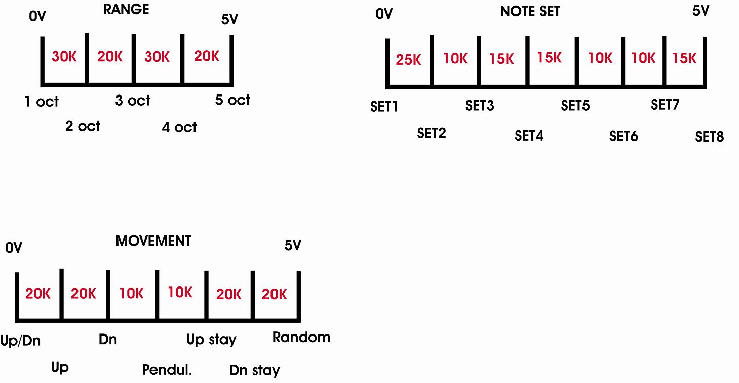

Here are the resistor choices i made , which work great for my build , you may need to adjust them if it doesn't work on your builds.
They all total 100K just like the control pots in the suggestion diagrams in the build PDF.
Remember , you may want just the Rate (Tempo) pot which doubles as the divider control when you plug a jack into the ext clock 3-pole socket , i finished my panel before i read this Smile , when i want internal clock tempo i use the rate pot , when i want external clock division i flick a switch to use the rotary instead of the rate pot.

I've just built this Arpeggiator as "the works" (example 3), but the build docs don't actually indicate what each control or socket does, only where to wire it to the PCB. (I'd really like to see round the front of the example to see what's going on)...
I'm just plugging stuff in and out but not really knowing what is going on with it since nothing is labelled properly.. the socket connected to XCLK and CKEN (I'm presuming it is a clock of some description), is that an in or an out? I connected it to an external clock and it does some weird rhythms, like it is taking the rhythm from both internal and external at the same time, is this normal?
There's also 3 CV in sockets and 4 controls connected to various CV connections on the board. Turning the dials has different effects for each, but I have no idea what they are really doing.
Also, the 3rd & 7th sockets, are these outputs? Do I need to connect these and the main CV out to a CV mixer to make them work?
If anyone knows what the labelling should be on "the works" (3rd example in build docs), please let me know, I'm scratching my head here. scratch
Posts: 1226
Audio files: 161
PostPosted: Sun Mar 04, 2012 9:49 am    Post subject: Reply with quote  Mark this post and the followings unread
Hi Rich , how are you .
The 3rd & 7ths sockets are inputs , i think it's a sort of digital input to switch between Major and minor , high / low switching.
The control dials.... have a look at my rotary diagram up above , they represent a flattened out pot track , the resistor joins are roughly where the range / movement / note set would change function if you are using pots only turning the dial .
The internal clock for stand alone mode is wired to a stereo panel jack wired up for internal clock (no jack plugged in) or external clock (jack in & disabling internal clock , when that is done the internal rate pot now acts as a variable divider for the external clock pulse .
I remember i had a bit of head scratching planning this one out , but its great once you understand it , it really thickens out my sequency music i do , great pcb & pic Very Happy

Is this like a gate signal, or should I send something else? I tried a few different things going in and out, but nothing seems to do anything significant.
I'm not really clear on which pots are doing what just now.. I'll keep playing with it and see if I can work it out.. I wish the docs were clearer.
I've definitely got the clock thing wired up wrong with what it's doing. It's really hard to tell what's going on with the type of sockets depicted in the diagram.
