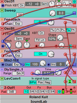

PostPosted: Thu Mar 08, 2012 8:17 am    Post subject: Reply with quote  Mark this post and the followings unread
Nice Tim! I was softening the sync a while ago with use of a modulated delay module with feedback. But you can make the sync sound harder too:

PostPosted: Sun Mar 11, 2012 3:02 am    Post subject: Reply with quote  Mark this post and the followings unread
And don't forget PLL sync. Normally this is done with a S&H module. Now I used this logic trick and a delay module. The funny part is, you can ditch the syncing osc in this pch too:

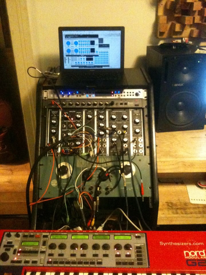

PostPosted: Fri Mar 23, 2012 8:07 am    Post subject: Reply with quote  Mark this post and the followings unread
My filter solution..
Neat. Smile Would you mind posting it in the building blocks section? Laughing
