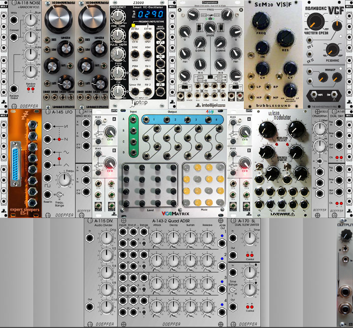

May I please have your esteemed and learned opinion on the following modular design. For what its worth I've also attached a screenshot of my proposed layout.
It will be used mainly for auditory exploration and as an instrument controlled by Ableton Live.
    doepfer A-118
    pittsburgh modular oscillator

My only suggestion would be to take it slow. Focus on building the fundamental parts of your synth before you buy things like wavefolders, delays etc.
As you build your synth you might find your needs are far different than you thought they would be at the start.
Good luck, and enjoy your journey!

@Gary: Thanks for the reality check. I did just throw the wave multiplier and BBD into the mix on an impulse. I think I was acting on someone's advice to buy one of everything to learn what it does. I am removing those and replacing them with blank panels.

OK after taking in account a few pieces of advice and the lack of stock for doepfer's VCLFO at Analogue Haven (I live in Hong Kong so I can't ship one module at a time from all over the place, the shipping would kill me!) I decided to modify my system.
You'll notice that I have a lot more empty space in my 9U cabinet now for future expansion after getting my feet wet. The way I look at it, its essentially a 3 VCOs+ 3 VCFs system with the very cool VCA matrix as the command center. All the other modules are bread'n'butter. Well maybe the vulcan modulator is more boutique then bread'n'butter but since I couldn't get any doepfer VCLFOs from Analogue Haven I replaced those modules with the vulcan modulator (dual VCLFOs!) and a A-145 LFO.

My first crack at a layout in modularplanner attached.

mixers and envelopes - at least 2. I would get at least one mixer for control signals A-138B (best the polarizing mixer from Doepfer A-138C). You thought of multiples but then you need mixers for control and audio signals. I think it makes the difference between a nice module-collection and a experimental modular system. I definitely haven't enough mixers. Isn't it all about splitting and combining and splitting...
and envelopes.. the A- 141-2 is nice but wouldn't you want also envelopes for controls?

@lebenspuls, thanks for the pointer on the mixers, I thinks its a good point, however I thought I could use the VCA matrix as a CV and audio mixer (just don't insert a control on the left)? Let me reread the manual on it.
As for the EGs, I count 5 EGs in my setup (Quad ADSR 143-2 plus VCADSR A-141), and I am assuming I can use all of them for both audio and CV signals. Is this not enough EGs or are they not all interchangeable amongst CV and audio signals? I'm a bit confused.

@lebenspuls, so the VCA matrix says "suitable as a 4x4 mixer, splitter, as well as dynamic signal router/processor" in the description. So if you don't insert any controls in the 4x4 grid then it just acts like a mixer, with the matrix of knobs allowing manual level adjustments. This is my understanding at least.

I am sorry, I don't know much about vca-matrix. I thought you would use it as your "output-vca's". I don't see the A-141, so please excuse me being too quick. I personal would prefer 2 or 3 separate 4/1 mixers but that fits just better my work style. If you use your modular only monophonic your are right about EG's. The vulcan-modulator is great but also look at Intellijel's Mind Meld. Both together are incredible versatile.

@lebenspuls, oh crap! You are right about not having the A-141 in there. I'm getting mixed up between LFOs and ADSRs. I think I meant to put in the A-140 (ADSR) because AH didn't have A-141 in stock but instead I accidentally put in the A-145 (LFO). I'm going crazy with all these options. I love it though.
I am beginning to see where you are coming from when you mentioned monophonic vs polyphonic. I guess I was just hoping for a very versatile monophonic that can be stretched to do 2 voices for now. So I counted 2 EGs per voice (one for the VCA and one for the VCF) for a grand total of 4.
I checked out the mind meld and it does seem useful, I especially like that you can patch in other signals to use the min/max/sum/diff operators! It costs $160 at AH which is a bit steep for an extension module? Do you see anything in my current setup that you would swap out for the mind meld? Perhaps get rid of the A-115? Trying to at least respect my initial budget. Wink

I didn't think your first choice was that bad, sometimes you do want a couple pieces you are very interested in just as long as you don't skip basics to include them. Anyway it is good to use a system a bit and have the room to add something you find you need.
You might have multiples to spare though as you get more modules you never know.
I don't know the VCA Matrix module that well, maybe you can get it to achieve your mixing needs but you may want something straight forward. After all maybe you want to use it as a 4x4 mixer but still need to combine signals
