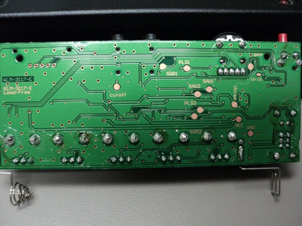

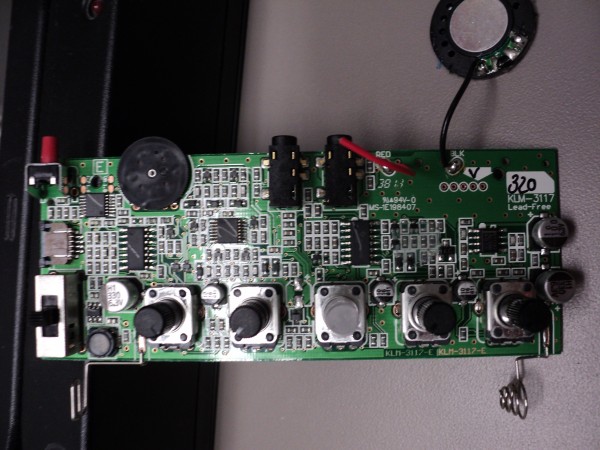

Here's the top and bottom of the PCB. Crap resolution on the top, but uh.... I can't imagine it would be too useful to anyone anyway since you ain't tracin' this out from a photo.
Here's the ICs:
Working left to right we have TI MSP430 G2231 microcontroller (surprise!), an LM324, an SN74AHC14 hex schmidt trigger inverter, another LM324, and finally a TPA6111 headphone amplifier.
Given the fact that there's a couple blank pads for missing ICs and caps, additional waveforms and a seriously underutilized microcontroller, I think it's safe to assume that the Monotron Delay uses essentially the same board.

Hi that's the point where I am at now. I noticed right away the Duo is laid out a little differently. I opened up the Duo and can clearly see the "gate" point but no "pitch" point labelled like on the original. While I have mine opened I would like to solder the wires for the simple note on/off for CV/Gate etc so I can play or sequence it with something. What point do I need to solder for pitch? Confused

I haven't got the measurement results with me now, but I remember the following:
The pads labeled SAW1, SAW2, SQU1 etc. gave us steady voltages no matter whether the ribbon was pressed or not or where on the ribbon.
The pad labeled Vrib gves the output of the ribbon voltage (hence the name) and it goes from a low voltage (I don't remember if it was zero volts) to full voltage (3V).
There also is a point we found using the schematics but there's no real pad connected to it, only one of these really small hole-y things (don't know what they're called - solder-hole?).
This point is at the joint of the pitch output from the MSP430G2231 (pin 4) with R7 (56k). R7 is located in an array of resistors on the side of the board near the MSP430G2231. It's the resistor in the right bottom corner.
Without pressing the ribbon this point puts out some changing voltage much like an lfo (it sounds like an lfo too when you send a gate to the monotron but no pitch CV).
When the ribbon is pressed it puts out varying Voltages. We found out that it uses 0,23V/Oct. but mirrored, so that for instance the low C is 0,23V above the high C.
However when we tried to input some Voltage there nothing changed, the monotron was just playing the same low modulated tone.
