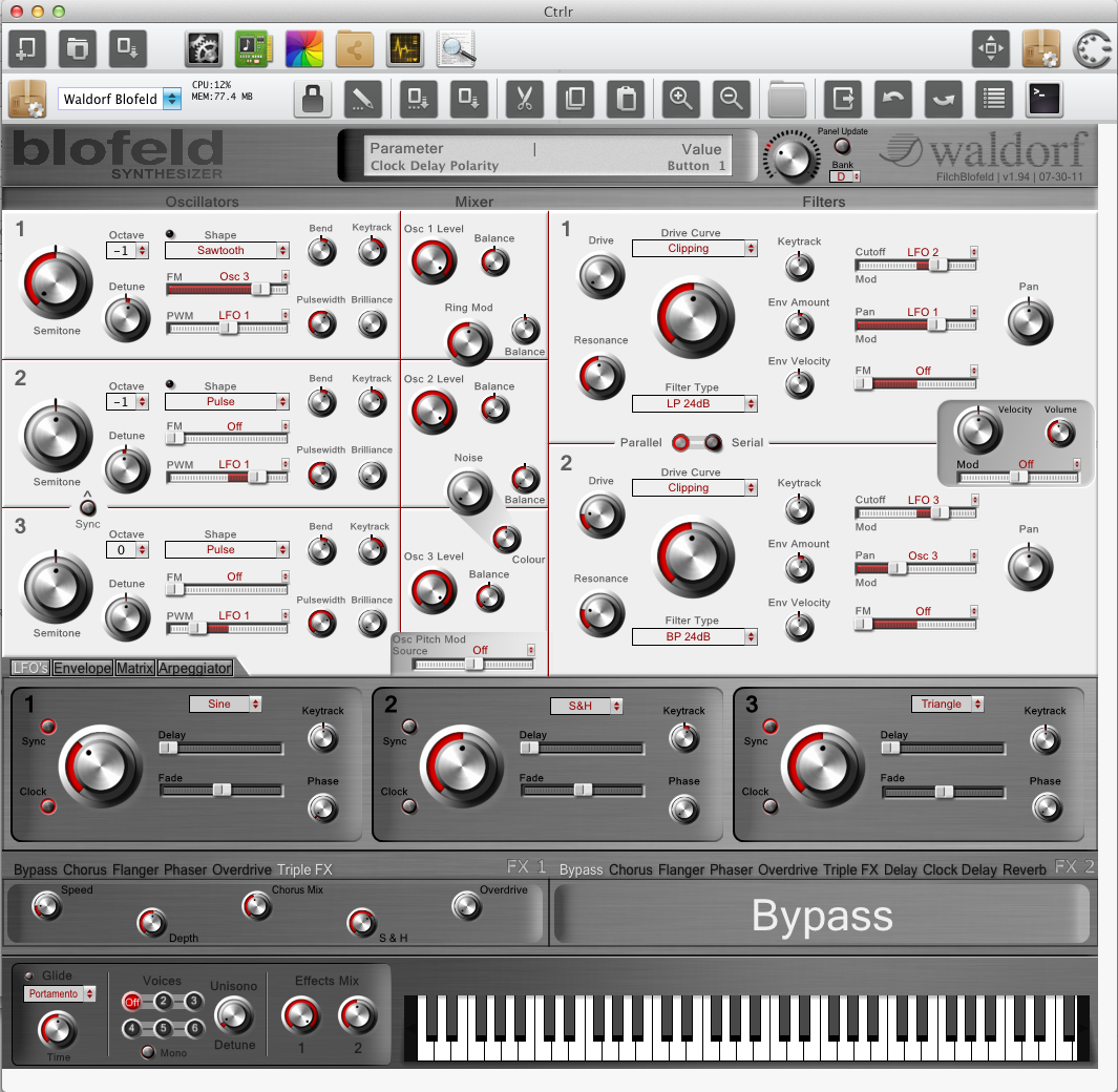

PostPosted: Sun Mar 25, 2012 2:13 pm    Post subject: Reply with quote  Mark this post and the followings unread
Editor now working on my Mac! Needs some extra software though to make it work. Midipipe.
http://www.macupdate.com/app/mac/10541/midipipe
http://www.ctrlr.org/viewtopic.php?f=48&t=704&p=4166&hilit=mac+filchblofeld#p4166
 Filesize:  499.15 KB
 Viewed:  459 Time(s)
ACHTUNG!
v-un-v
Joined: May 16, 2005
Posts: 8932
PostPosted: Sun Mar 25, 2012 2:21 pm    Post subject: Reply with quote  Mark this post and the followings unread
"filchBlofeld v1_94.bpanelz" xml specify "Walforf Blofeld" as MIDI OUT and MIDI IN but "Devices" dialog proposes different syntaxes : "Waldorf Blofeld - in" and "Waldorf Blofeld - out"
The solution is using Midipipe to create 2 pipes :
- "waldorfCTRLRout" : "Midi In" tool > create new virtual IN named "Waldorf Blofeld" / "Midi Out" tool > select "Waldorf Blofeld - out"
- "waldorfCTRLRin" : "Midi In" tool > select "Waldorf Blofeld - in" / "Midi Out" tool > create new virtual OUT named "Waldorf Blofeld"
Save as a Midipipe file. Open it before using "filchBlofeld v1_94.bpanelz" in CTRLR.
