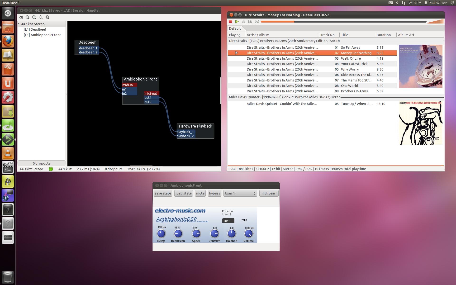

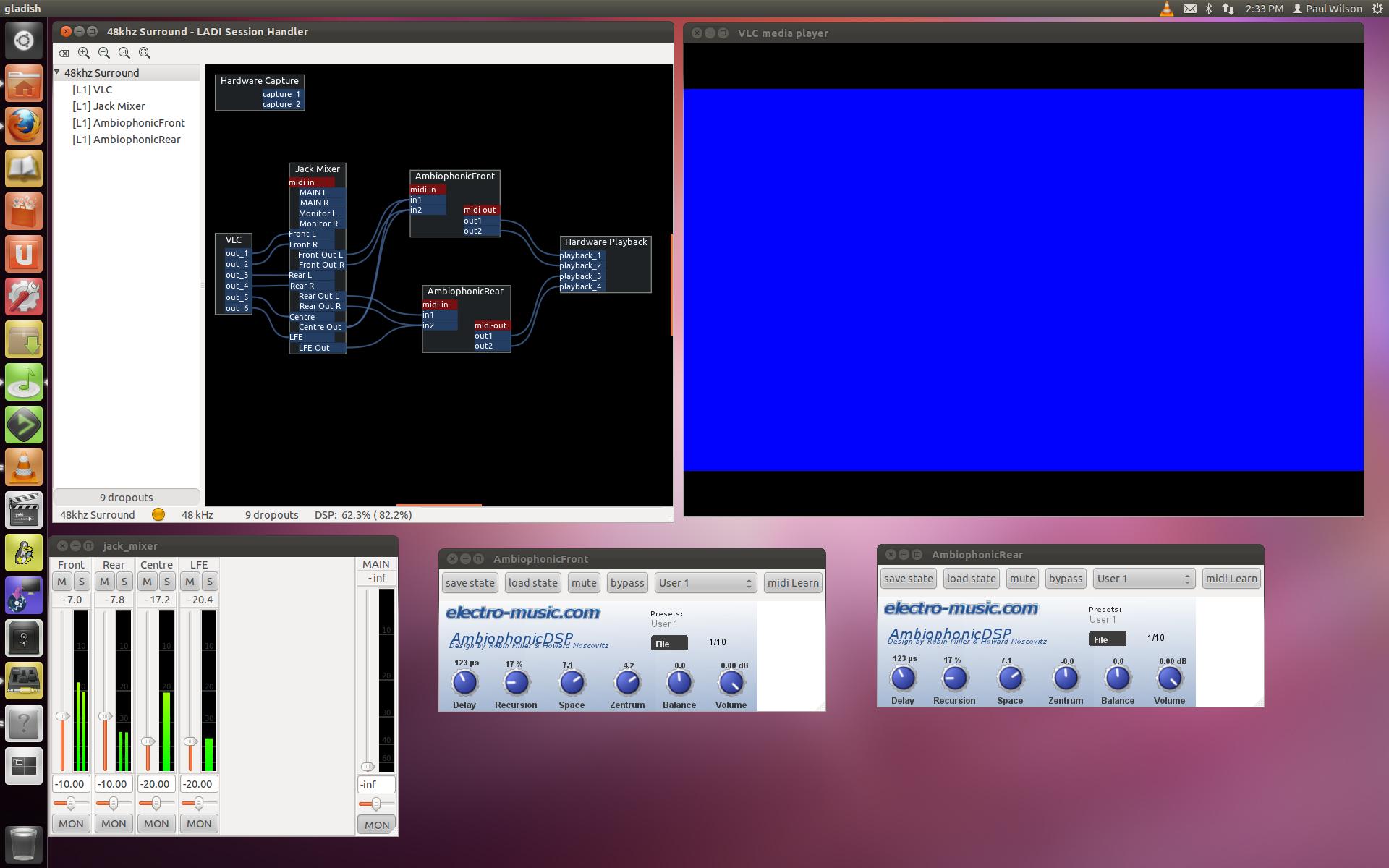

In case you or others are interested here's an outline of my setup running on Ubuntu using several open software packages.
Ladish - This is a jack session handler and works as the patch bay for all
the apps. Also handy for reassigning conflicting channel
assignment layouts. (Linux uses FL, FR, SL, SR, C, LFE instead of
the usual FL, FR, C, LFE, SL, SR.
Jack - Audio connection kit that allows you to connect jack compatible apps
together.
Jack Mixer - Controls the output levels and therefore the downmix of the
5.1/7.1 source to 4.0 for Ambio surround.
Festige - A wrapper that allows you to run Windows VST effects in Linux.
(Requires Wine - a Windows operating layer for Linux).
I'm using an audio player called Deadbeef for stereo music sources. It is simple but powerful and supports many features and formats. Very similar to Foobar actually. It only allows stereo output to Jack and doesn't support video, therefore I use VLC for video and multichannel sources.
The setup may sound a little convoluted but in practice it works really well. I have several Ladish session presets for various stereo and surround sample rates. I just open Ladish, load a session preset and it automatically opens all the apps and I'm ready to go. I've included a few screenshots of the system in action. (The screenshot doesn't capture the video but you get the idea).
I cannot tell you how much I'm enjoying the Ambiophonic plugin and its ability to elucidate the hidden gems within the soundscape. It's like the fresh eyes analogy applied to your ears! Thanks for sharing it with us.
All the best,
Paul

Hi!
From the screenshots I see you have set the delay value from the Ambio plugin to other than the default number.
Have you been able to store this value from one execution to another? I've tried several windows VST hosts and the delay parameter is always reseted to the initial value which is very annoying.
This does not happens with the other parameters whose values are correctly stored.
Regards

janderclander14 wrote:
Hi!
Regards
Unfortunately the delay setting is not stored between sessions and as you say this seems to occur across different hosts. Because my speakers are spaced at about twice the distance of the standard setup I simply double the delay setting each time. Another quirk I've noticed with the delay setting is that the default setting changes depending on the sample rate you are using. i.e. a higher sample rate will produce a lower default delay setting. It still functions correctly but the scale of the numbers is different. Sorry I couldn't be more helpful.
Kind regards,
Paul
