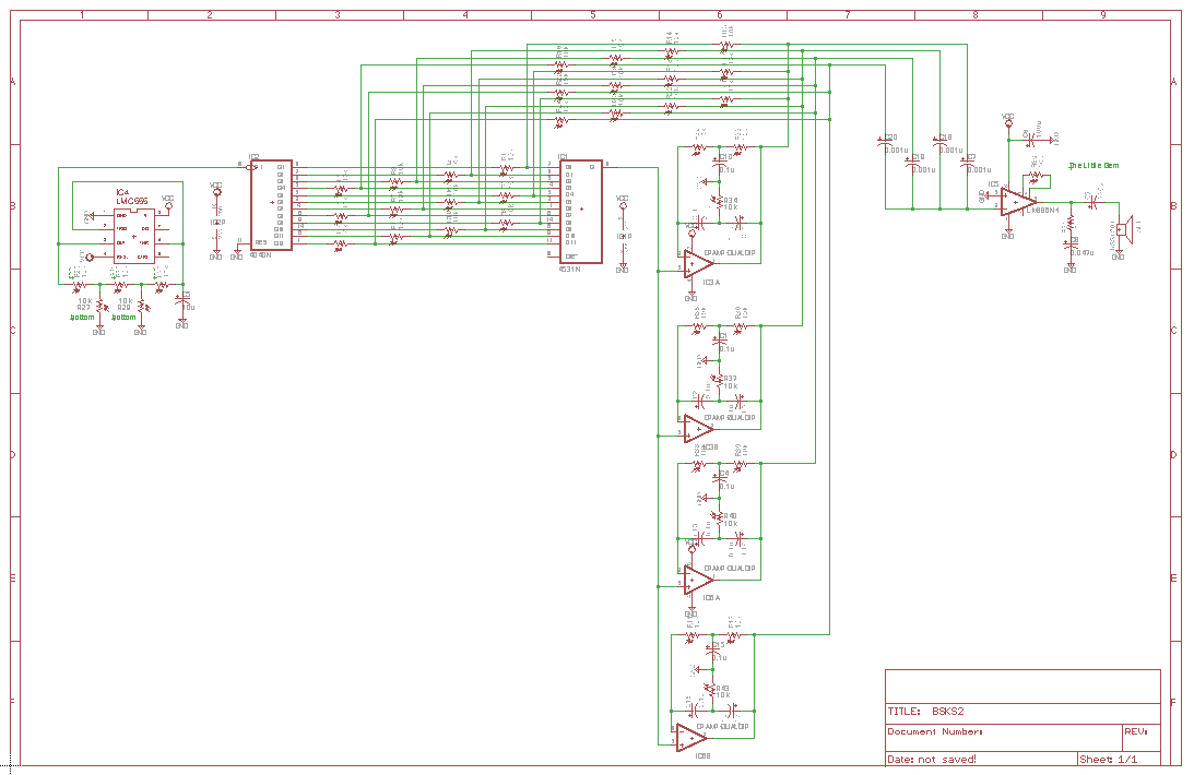

PostPosted: Fri Mar 30, 2012 10:43 pm    Post subject: Reply with quote  Mark this post and the followings unread
Here is the BS section that I just dreamed up with 25 CDS cells. It's a take on the linear cmos logic but with a 12 bit parity generator chip as the logic and CDS cells at both feedback and input positions.
This circuit is cool because it has that groovy XOR based sequencer logic, plus it's all analog with feedback and input signals controlled by the CDS cells, plus it's only two chips (well, need a tempo oscillator too). I think I may change it a bit because it's still too much drive current for the TLO74, so i might use the full quad with three outputs each - wild huh?
Should sound really freaky!

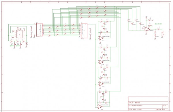

Well here i have been up all night fueled by energy drinks and I have come up with another wacky design, shown below. I'm not sure if it will work but I can breadboard it and see once I gather up all the parts. I'm not sure if there is a correct inversion structure or if the combination of all inputs to one output in the parity generator is going to work, but the idea is as follows.
The four twin-tee filters will have component values selected to produce not a bandpass or notch filter, but a wideband filter result. The idea there is that they can produce tones within a range, and four separate bands can be selected by component value choice, covering the audio range of the output transducer. These filters combine with the parity chip to form an XNOR based linear CMOS amplifier.
If it is stable and works like i think it will, it should certainly make some unique sounds! Design critiques anyone?
Les
i don't think you'll have any, this is too small to read. Very Happy
almost like politics! Very Happy

drapdap wrote:
LOL, yes, I was just hoping folks could look at the topology, the values are not finalized. Essentially all of the resistors are CDS cells.
Les

Ah, ok, i see it now. Please post a bigger if you get on with this, i like to read schematics. Very Happy

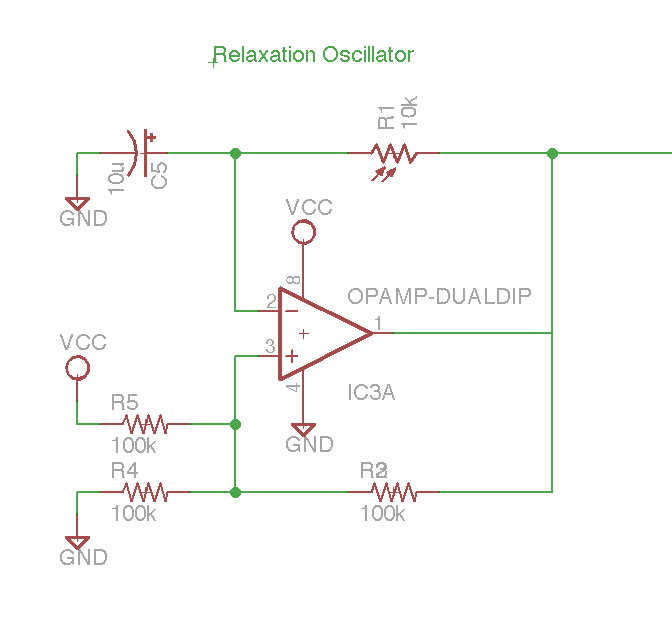

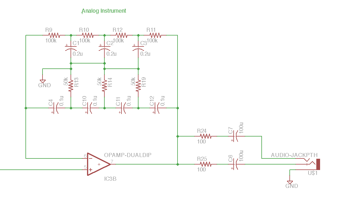

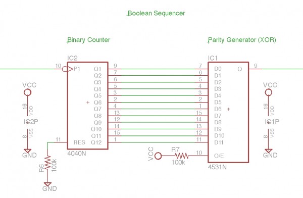

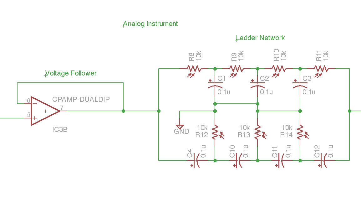

PostPosted: Mon Apr 02, 2012 11:58 pm    Post subject: Reply with quote  Mark this post and the followings unread
ask and ye shall receive, drapdap! Here are close-ups of the current, simplified design. I found some problems with my previous design so I scrapped it and created this simpler one. The design works as follows:
1. Relaxation Oscillator
This is a classic square wave oscillator whose frequency is controlled by the light incident on the CDS cell. The tempo will increase with decreasing light.
2. Boolean Sequencer
I was very excited to discover the CD4531 12 bit parity generator IC as it is the perfect companion to the CD4040 12 bit binary counter, generating an XOR sequence on a 12 bit count with only two chips. I have tested the XOR of all bits in ChucK and it makes a pleasantly musical sequence. Nice!
3. Analog Instrument
The concept here is that it's a twin-T network extended into a ladder network. I don't know what the frequency response will be but it should be periodic in some sense, yet controlled by the CDS cells, it will change with the incident light. I will mount the CDS cells close to each other so they have similar values for proper periiodic response.

Critiques and suggestions are very welcome!
Les

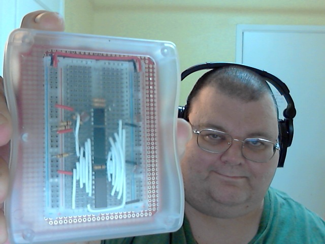

PostPosted: Wed Apr 18, 2012 8:56 pm    Post subject: Reply with quote  Mark this post and the followings unread
OK folks, here is the constructed prototype minus the output stage. I have made a few design changes, but first let's talk about the physical construction.
The box is a Sparkfun clear project case, which i truly enjoy working with (on two projects now). The red board is a printed through-hole prototyping board which mounts in the case with perfect alignment, dividing it into a top and bottom section. I am not using the board to solder parts onto, but rather as a structural element. Adhering to the top of the board is a small breadboard that fits nicely with chips, resistors, and wires in it (no caps in inventory yet). On the flip side (not shown) is just barely enough room for a 4.5V solar cell designed for Sparkfun.
So in the physical situation we have a nice tightly packed arrangement showcasing a breadboard with chips running down the middle and the noticeable white wires on the sides. The use of the breadboard instead of soldering into the protoboard allows me to easily make design changes, which I have done a few times.
Electrically we have power from the solar cell with intentionally zero power conditioning circuitry such as bypass caps (might add those later) for maximum weirdness in the sound. The 8 pin opamp chip at the top has a relaxation oscillator with LDR (CdS cell) frequency control on the right side and an incompleted output amp on the left (more later on that). Then we have my old friend the CD4040 counter with a 12 bit output + clock in is 13 bits of counter bus, or 8192 step sequence. The third chip (on the bottom of the photo) is a CD4531 parity encoder chip which is pretty much just a giant 12 bit XOR dealie with a separate XOR input for odd/even parity.
Rather than wire the parity chip as shown above in the schematic, with bit 0 goint to bit 0 and so on, i put bit 12 (the MSB, or most significant bit) on the even/odd parity control and assigned all the other bits including clock to the remaining 12 inputs according to physical proximity on the board. This makes the board neat and clean instead of the tangled wire mess it would have been, and also makes for a different sound than the pure parity would. This is because there are upper bits in lower places and lower bits in upper places, resulting in a scramble of the even/odd parity function which affects only the upper 1/3 of the bits as near as I can tell from the schematic.
Anyway so we have a boolean sequencer with light-dependet frequency control (brighter slower, dimmer faster) and a funky XOR output of one bit from all 13 input bits. This will go into the modified twin-tee bass drum analog section powered by the left half of the opamp chip. More on the twin-tee modification in the next post since this post is getting long.
Finally, I have decided not to use the speaker transducer thingie to vibrate the case for sound, and instead to have a 3.5mm (1/8") jack for headphone, computer, or mixer output. That's it so far, read on for info about the analog section.
Les

PostPosted: Wed Apr 18, 2012 9:05 pm    Post subject: Reply with quote  Mark this post and the followings unread

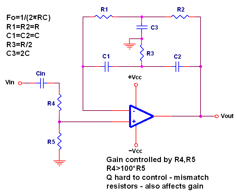

You know you've got a pretty good stronghold of experience in a particular category of knowledge when you can imagineer something in that realm and then find it in the collection of existing knowledge in the world according to Google. That's why I was pleasantly surprised to find the exact circuit that I thought up in the below image in Google Images. It's got a comment about not being the best of it's kind for the Q control practical issue, but I'm willing to take that chance and we'll see what happens. Anyway patting my own back there, sorry.
Anyway, I'm modifying that circuit to include three tees squooshed together to create a multi-resonant structure that will create multiple voices of drums depending on the frequency of the stimulation at the time. When the music changes a lot it will trigger the upper drum harmonics and slower, lower ones if you get my meaning.
My friend just walked in the door and we are going to record some Gospel Rap, so I'll have to get back to a more thorough discussion of the circuit later, but suffice to say it should be a drum cacophany of music, I hope!
More to follow,
Les

PostPosted: Wed Apr 18, 2012 10:23 pm    Post subject: Reply with quote  Mark this post and the followings unread
Ty elmegil, I'm having fun to boot! The circuit is quite interesting as well, to me anyway.
In the illustration below we have the analog section detailed. I have made a generalization of the twin-tee circuit shown two posts ago, making it into a ladder network or more accurately a pair of ladder networks combined together. in a twin-tee fashion.
The idea here is that the ladder networks will form a notch filter with multiple notches due to the multiple resonant points that are formed by the network. For example, we should have resonances at RC, RRC, and RRRC at least, and probably other cross-resonances if you will permit that term.
In this way the circuit is not just a drum, but multiple drums of different sizes related by harmonic intervals, all being struck at the same time. It should sound rich, full, and unique.
That is, if the thing doesn't self-oscillate because of runaway Q, we shall see.
Les

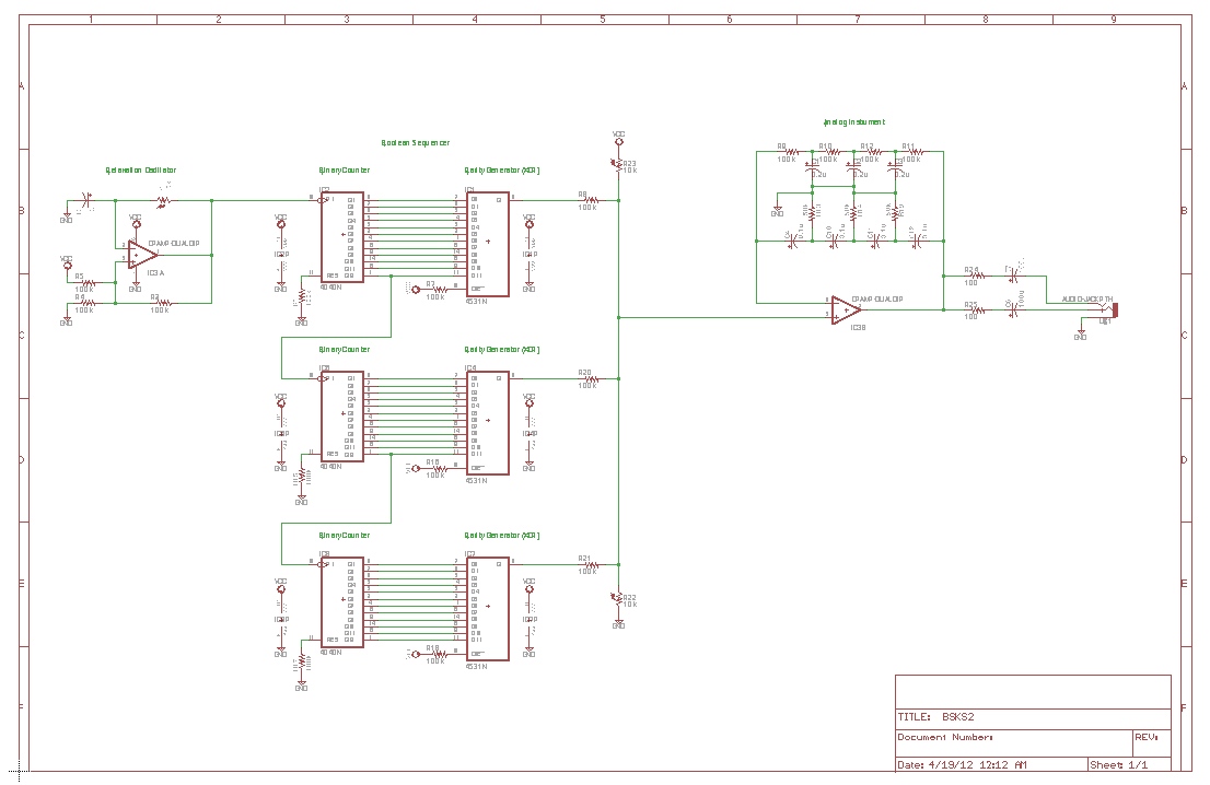

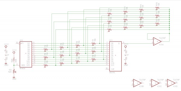

PostPosted: Wed Apr 18, 2012 10:28 pm    Post subject: Reply with quote  Mark this post and the followings unread
Here in the illustration below we have the whole circuit including extension to three counter chips with three logic elements. This way the circuit does not repeat it's sequence for well over 100 years of music playback, wow!
In the prototype, however we have only room for just the one counter and logic chip pair. The rest of the circuit is previously described.
I am ordering some capacitors tonight and an audio jack for completing this project, and will do so when they get here.
Les

PostPosted: Thu Apr 19, 2012 3:46 pm    Post subject: Reply with quote  Mark this post and the followings unread
How are you going to change the battery quick enough so that the pattern doesn't restart? Smile But seriously, that is a rather long sequence! Good stuff.
It's beyond my understanding right now, but that resistor network ladder thing looks really cool.

PostPosted: Thu Apr 19, 2012 4:36 pm    Post subject: Reply with quote  Mark this post and the followings unread
wmonk wrote:
Way cool Les!
Bbbuuut where did you leave the beard? Shocked
wmonk, the beard got trimmed 5 months ago and the head hair is now gone also! My head is an egg, i'm an egghead! (scrambled inside)...
Les
Joined: Oct 13, 2007
Posts: 6221
Audio files: 267
PostPosted: Thu Apr 19, 2012 4:37 pm    Post subject: Reply with quote  Mark this post and the followings unread
RingMad wrote:
It's solar powered, so just keep it lit for 100 years...
Yeah I like that Twin Ladder filter, I just hope it works!
Les

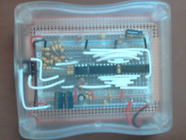

PostPosted: Sun Jun 10, 2012 2:27 am    Post subject: Reply with quote  Mark this post and the followings unread
I finally finished wiring up the circuit and tested it at night by holding it up to a light bulb (incandescent), and guess what? It works! well, I just heard some thumping bass-drum-like sounds but that's enough to verify that at least something is working right.
The circuit does not have the LM386 driver, instead I chose to send the output to an 1/8" stereo jack directly from an opamp. Since the opamp can drive 25mA, it does a good job delivering the signal to my 64 Ohm Sennheiser Headphones. So at sunrise I'll be walking around the place with my headphones on carrying this little box in my hand and wearing a big smile on my face!
In marginal lighting conditions there is a slight buzz/hum type sound which quickly changes into a soft thumping sound when the light becomes sufficient to power the device. I can't wait to try it in bright sunlight because there will be better control of frequency and offset for varying sounds.
Unfortunately the design has only two output levels, on and off, however I can easily improve that with the addition of more CDS cells from the binary counter output to the summing node. I'll play around with that tomorrow. How exciting!
Les

Here is a photo of the completed Solar Music Box.
Les

Well, after 3 tries I now have a circuit that I'm happy with and will stick with as my first completed music box. It's got a nice bass rhythm to it which I like. The attached audio sample has a voiceover of me playing with it for almost 20 minutes. Unfotunately the right audio channel is silent for some reason, I think a loose wire. I'll fix that soon. But I wanted to get this audio sample posted to you now so that you can hear it.
The cost to me including shipping of the box is right around USD$50 including case, solar cell, breadboard, and everything. I'd be willing to sell it for USD$100 + shipping so that I could buy parts for two more boxes in exchange for all my time and effort in developing and assembling the music box.
I'll work up a schematic soon and post it.

Nice bass rhythms indeed! I could not tell from the photos where the LDRs are located, but a fun thing to do with such things in a darkened room is to have each one looking at a candle of its own, and the random flickering and light changes as it burns down makes changes in the sounds. Distance from the candle to the LDR is also a factor. If one uses the "LED tea candles" found in dollar stores, the flickering is generally faster.
Candles worked well with my Triowaverator (triple oscillator sine/triangle dronebox), and perhaps could produce nice results with this box.

Candles and other flickering light sources - what a great idea! I am realizing as I play with this new toy that I shall have to build and/or obtain a collection of light sources as I go down this path... Nice ideas!
