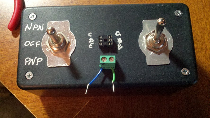

PostPosted: Mon Apr 23, 2012 5:45 am    Post subject: Building Tools... Reply with quote  Mark this post and the followings unread
I'm just getting started, so I'm building tools before I do more "actual" building...This one is Ian Fritz's transistor matching circuits, combined with a big honking switch Smile ... using a pair of 9V batteries to make the box simple.
 Filesize:  112.21 KB
 Viewed:  277 Time(s)
 Filesize:  131.44 KB
 Viewed:  298 Time(s)
PostPosted: Mon Apr 23, 2012 5:53 am    Post subject: Reply with quote  Mark this post and the followings unread
simple is beatiful!
(reminds me of 70ies gear: heavy gauge wires flying around)
PostPosted: Mon Apr 23, 2012 6:08 am    Post subject: Reply with quote  Mark this post and the followings unread
Ha! Smile I think my pictures distort the view, that's only 22gauge...
Thank you for the kind words Smile

PostPosted: Mon Apr 23, 2012 7:14 am    Post subject: Re: Building Tools... Reply with quote  Mark this post and the followings unread
elmegil wrote:
This one is Ian Fritz's transistor matching circuits...
thumb up Gotta build me one of those! Printed out the symple schematics but haven't put it together yet.

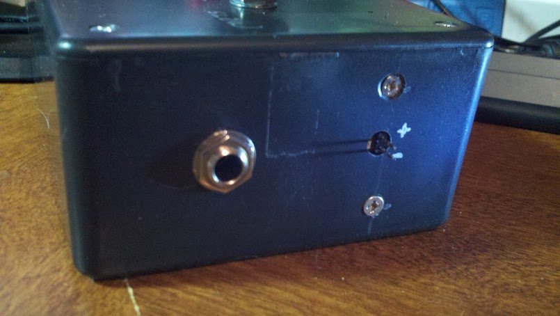

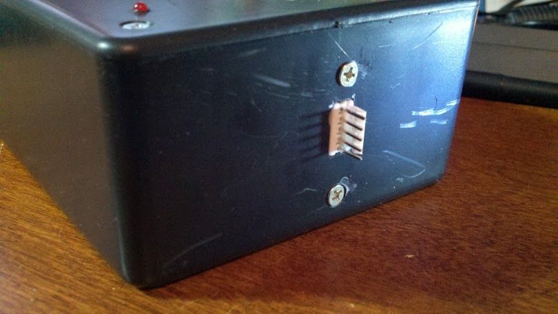

PostPosted: Tue Apr 24, 2012 9:44 pm    Post subject: MFOS Precision Oscillator Calibrator Reply with quote  Mark this post and the followings unread
Modded fairly heavily... added a manual reset switch and a clock LED, changed a cap in the rate circuit so I could go slower, used a different counter...added a pin header output in addition to the 1/4" jack. Using a +/- 15V supply and a different zener (didn't have any 9.1's handy).
On the breadboard it adjusted perfectly, but soldered up on protoboard for some reason I can't get the second op amp position to null all the way to zero. With one amp it went to 4.8mV and swapping them it went to 2.2mV. But both of them nulled to zero in the first position.
Learned a lot about case drilling/mounting pin headers doing this. I need to get a bunch more 1/4" #4 bolts Smile
