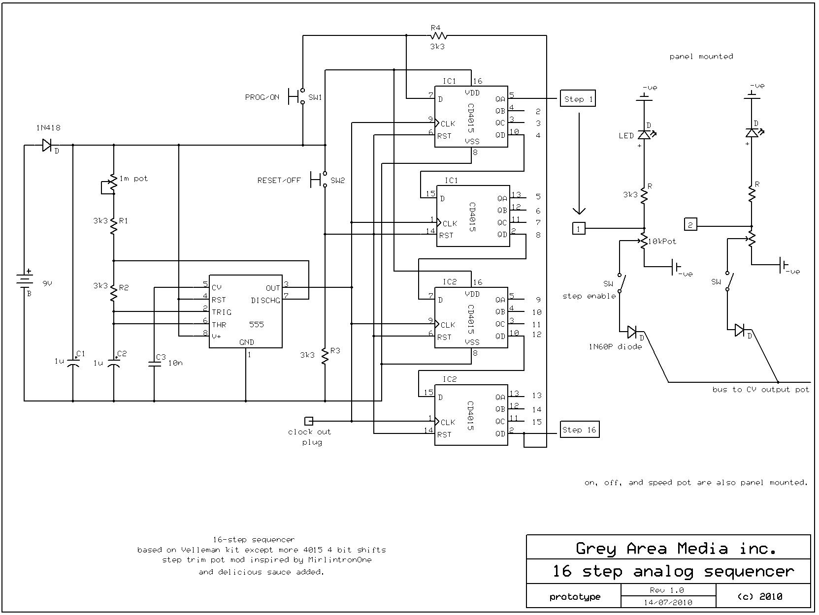

On the internet i found a shematic that uses 2 4015 ic's for sequence 16 steps.
I tryed it on breadboard and it works.
Grt,
Chris

PostPosted: Thu Oct 04, 2012 10:06 am    Post subject: Reply with quote  Mark this post and the followings unread
Hi!
Yes this is very clos to the centipede. Is a very simple build but it can be the center of something more complex.
I've developed the PCB but for now I have stopped the project for a while. I have to much work here now and no time. As soon as I can I will share everything and work on a v.2 with some cool options (still in my mind Smile ).
