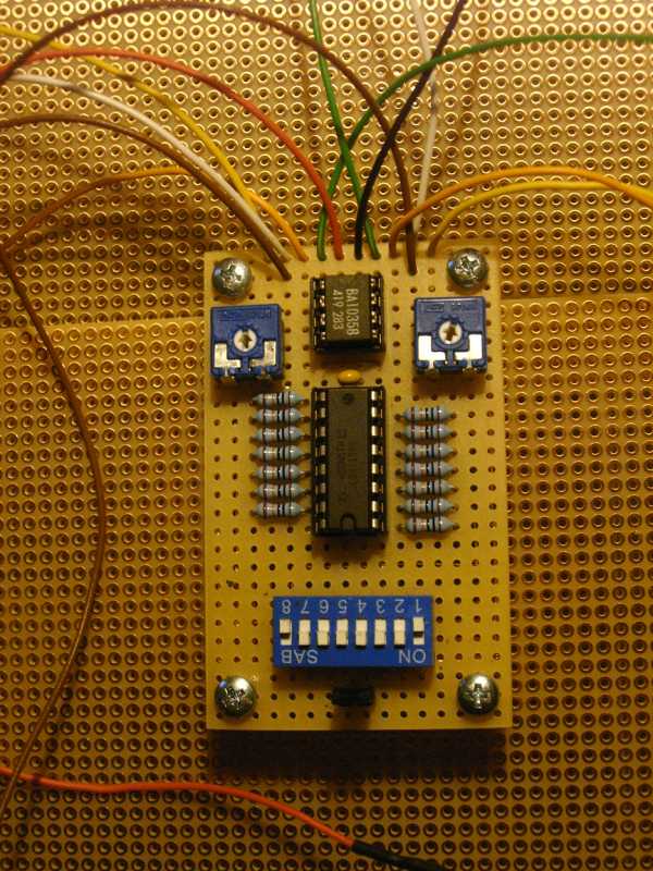

I just finished my module for this. Of course after I put it in the case it didn't work right, but after troubleshooting it all day, it's finally done!
I ended up making a module with 2 of the original circuits minus the clock. I also added a switch so the clock input into the 4040 & 4006 could be the same clock (like in the original) or 2 different clocks.
I'll try to post a picture when I can.
 Filesize:  28.41 KB
 Viewed:  1314 Time(s)

Here's pics... sorry they're crappy
 Filesize:  61.46 KB
 Viewed:  598 Time(s)
 Filesize:  55.08 KB
 Viewed:  597 Time(s)

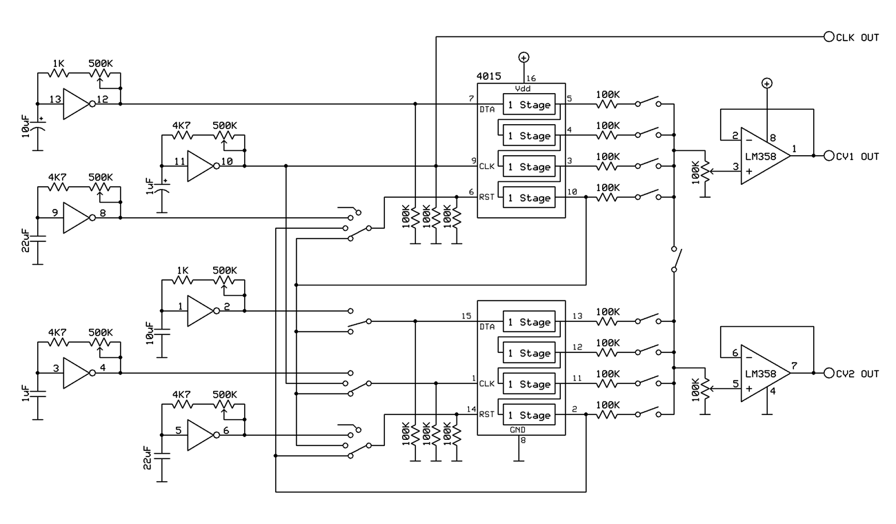

PostPosted: Tue May 15, 2012 9:44 am    Post subject: 4015 Stepped Wave generator Lunetta module Reply with quote  Mark this post and the followings unread
ok here's an idea for a versatile 4015 Stepped Wave generator Lunetta module. It's setup as a dual
4-stage 'wavegenerator' , but I added some switches so it can be used as an 8- stage aswell. (all 3 switches closed).
My first idea was to use the switches to select either a seperate input signal or link the 2 together,
but I decided to add some diodes so you can do some weird modulations aswell.
The opamps are configured as a voltage follower and act as a buffer. And because of the high impedance inputs
I changed the resistors to 100K which reduces the current draw. I'm not sure which opamp would be usefull,
a single power rail to rail makes sense, but not I'm sure, I 'll have to do some tests to see what works.
The 4040 is not included since there are many ways to patch it and it deserves it's own module anyway.
just as the oscillators. I also didn't include the caps for sine and spiked outputs, they can be added
but probably have to be smaller because of the 100K resistors, it also depends on the frequency
you use it for, so experiment! Wink
some extra options:
- wire all the outputs of the 4015 to the panel
- add switches between the ouputs of the 4015 and the resistors
- use pots Cool
btw this is only meant as a LUNETTA module,. not as a synth module (yeah I know a Lunetta is a synth too).
In that case i would add comparators for each input and some extra opamps to get a 10Vpp (or whatever
you like) output signal.
 Filesize:  42.27 KB
 Viewed:  781 Time(s)

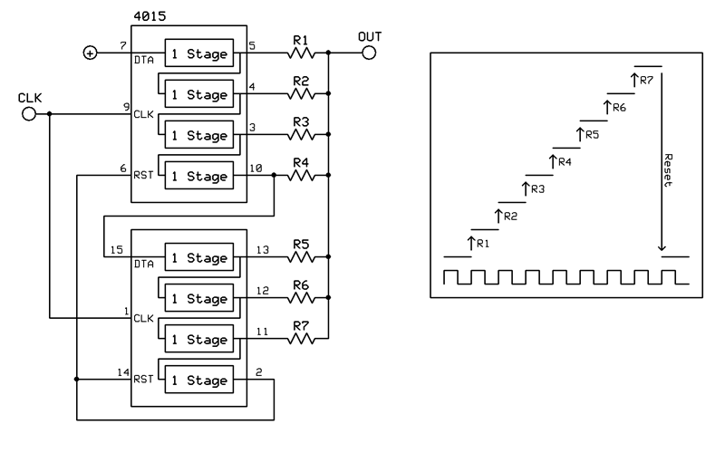

PostPosted: Tue May 15, 2012 2:01 pm    Post subject: 4051 Sawtooth generator Reply with quote  Mark this post and the followings unread
You can also make a sawtooth* wave with it. Cool
You could leave the resistor attached to pin 2 in place (so you can do this with the lunetta module),
the amplitude will just be a bit lower.
hmm, just got another
so there migth be another schematic coming up (if it's possible)
*I thought it was called a ramp and the other way around a saw, but according to wikipedia that's called an inverse saw Neutral
Stepped Sawtooth wave with a 4015
 Filesize:  25.71 KB
 Viewed:  677 Time(s)

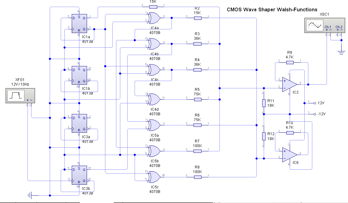

Walsh-Functions
 Filesize:  277.97 KB
 Viewed:  681 Time(s)

Nardu, that's interesting stuff about the Walsh functions. I notice something strange with the schematics / simulations you posted... IC1 seems to be
labelled a 4016, which is a bilateral switch. Shouldn't this be a 4015 shift register, which is what it looks and behaves like?
James.

PostPosted: Thu May 17, 2012 7:09 pm    Post subject: LFO test Reply with quote  Mark this post and the followings unread
I made a little testboard to save some breadboard space and I added a dipswitch so I don't have to keep
pulling out/adding resistors. (and no more dodgy connections). For the opamps I tested a TL082, uA741, and
LM358 (= 1/2 LM324). That last one worked ok so I didn't test any other ones. I did need to add an extra
pulldown resistor else the signal clipped. 100K for each set of 4 works nice, but instead of just a resistor
I added a pot. (one side to the resistors, other side to GND, wiper to opamp) which makes it possible to
adjust the amplitude of the wave. Smile
This allready proved to be very usefull when doing some tests with it used as an LFO to control 2 VCO's. Because
I can adjust the amplitude I can also control the voltage of the steps, so I tuned it untill I had a nice sequence.
I did record somes sounds but have to edit the file first, So I'll post some later.
Here's a schematic of how I used it as an LFO, I did change it a bit while I was playing with it so i added some
switches to show what I think are the different connections I made.
and a picture of the testboard Mr. Green
waveshaper setup for LFO test
 Filesize:  53.74 KB
 Viewed:  864 Time(s)
4015 waveshaper testboard =)
 Filesize:  88.95 KB
 Viewed:  594 Time(s)
