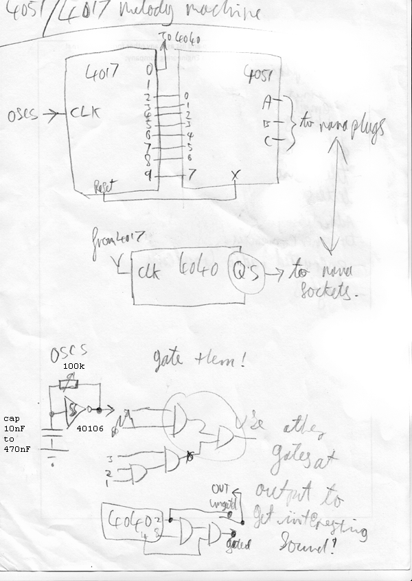

I think the best introduction for this device is this video or the attached sound file Wink
It is based around slacker's melody generator circuit which uses a 4017 and 4051. I'll find a link to a forum post I made about that because I made some modifications which made it more tuneful ... Then some more which made it less tuneful Very Happy
Schematics coming soon! For now I'll give you a bit of an explanation, slacker's melody generator divides the input frequency by any integer between 2 and 9 ... I think ... maybe, 2 and 10, anyways it doesn't matter for now.
Then I added a 4040 frequency divider/binary counter which is clocked by the input frequency/2, this then controls the division of the initial frequency. So there is some kind of weird feedback loop going on there Very Happy It makes jolly spiffing sounds!
I have also added a 4001 NOR gate (any other of the usual gates could be used) to combine three oscillators for the initial frequency divider clock (using two of the gates) and then to get "space invaders mode" the /2, /4 and /8 outputs of the 4040 are combined with the remaining two gates.
Oh, and also, the output of the whole circuit comes from the /2 output of the 4040, otherwise it's not very square.
The oscillators get really spacey when two of their frequencies are very close together, the phasing waveform produced a sound as though the device is being modulated by a sine LFO! Very interesting indeed Smile

I found my original schematics under a pile of datasheets and the remnants of today's delivery of components (I'm sure we're all familiar with the debris of small plastic bags and anti-static)
They are a bit messy so I will translate some of the illegible messy writ- I mean, secret code Cool
At the bottom thats a note about gating several oscillators for the input to the 4017, thats the trick to making those really interesting sounds Wink
There's also a messy circuit diagram of how my gates are connected at the bottom. I crossed some bits out because I realised they wouldn't work well or something like that.
The "1,2,3" on the inputs of the gates are the 3 oscillators. A SPDT switch is used on the 4017 input to change the clock input between one of the oscillators and the gated oscillators.
The output is achieved in a similar way; it is switched between the divide by 2 output of the 4040, and some outputs of the 4040 gated together, by a SPDT switch ... oh actually there's an unclear diagram of that at the bottom Smile
Also, "nana" is shorthand for 4mm Banana, as in banana sockets or plugs. Thats the patch bay you can see on the device.
I'll draw up a nice clear version eventually.

It took me all evening to do this for some reason Neutral messy schematics are much faster Smile
However I can have solace in that I built a ramshackle signal generator last evening because I was sick of making oscillators every time I wanted to test an audio circuit! It's only square wave but it uses 90% scavenged bits, the core is a 4060 from some broken electronics, basically a 4040 with built in oscillator Very Happy tried to build the oscillator to the datasheet component specs but they went out the window eventually and it still works Wink
I took the output from two of the divide-by outputs giving me a half frequency clock synced to the full frequency output Very Happy
