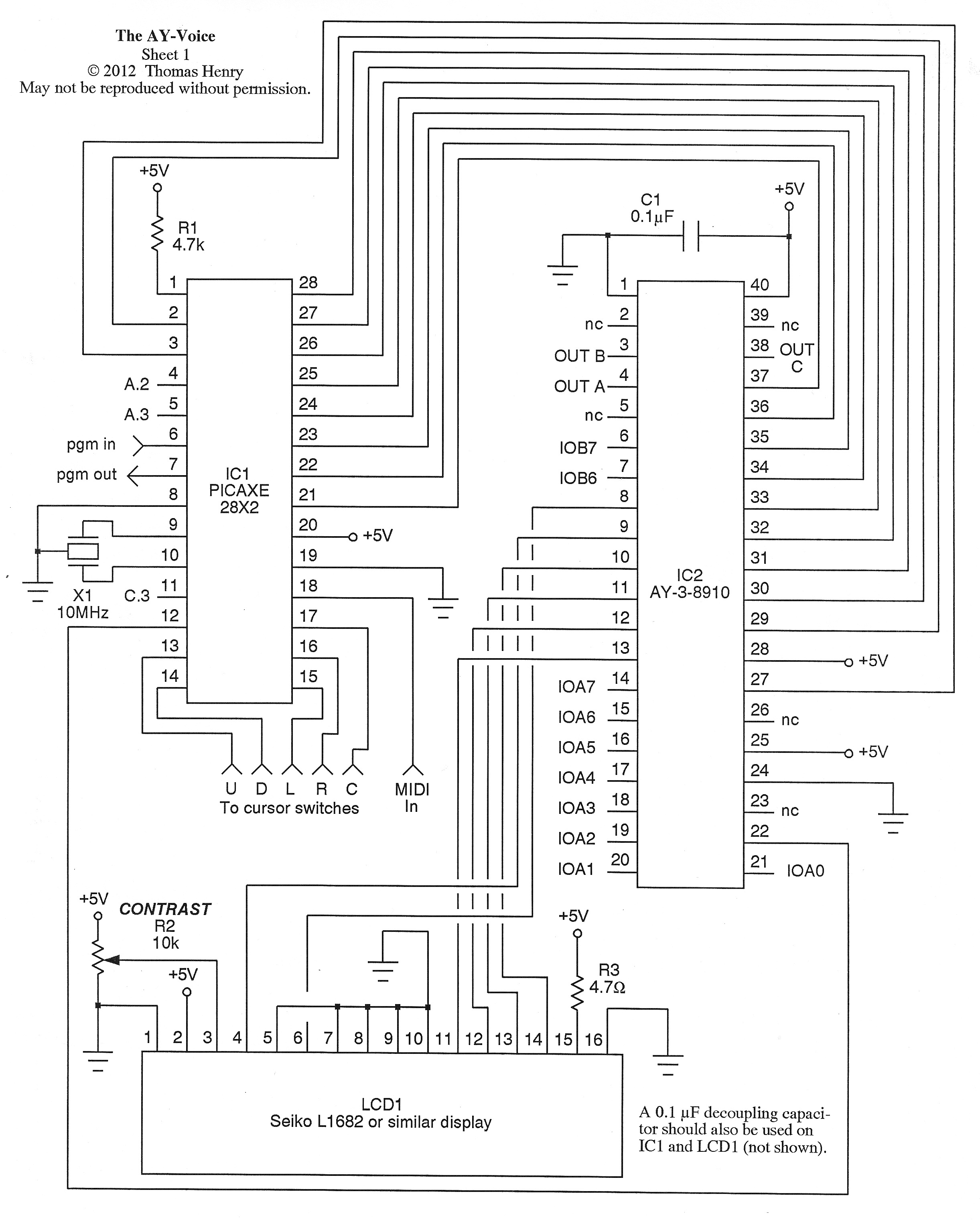

Hi gang,
I finished up the input test rig today (hardware and software). The cursor navigation buttons work just fine. Attached are the new schems, code and a picture.
For testing purposes I built up a small button arrangement on perfboard; you'll notice it in the picture. Just imagine it's been rotated 45 degrees to give N-S-E-W and center.
Not much to say here other than both the LCD and cursor keys work just fine. The code isn't particularly elegant, but the goal was just to see if the input structure works okay. In the AY-Voice I'll spend a lot more time making the code a bit more praiseworthy.
Next on the docket is mapping out the menu structure. The algorithm will be a state machine and will probably be the hardest part of the project. I'll begin on it tomorrow.
I usually only release projects when they are polished, especially after having them completely vetted by the redoubtable Scott Stites. He's a world traveler at the moment and not near the workbench, hence this piecemeal approach. What do you think? Do you like seeing the genesis of a project?

Schematic, Sheet 1
 Filesize:  850.95 KB
 Viewed:  644 Time(s)

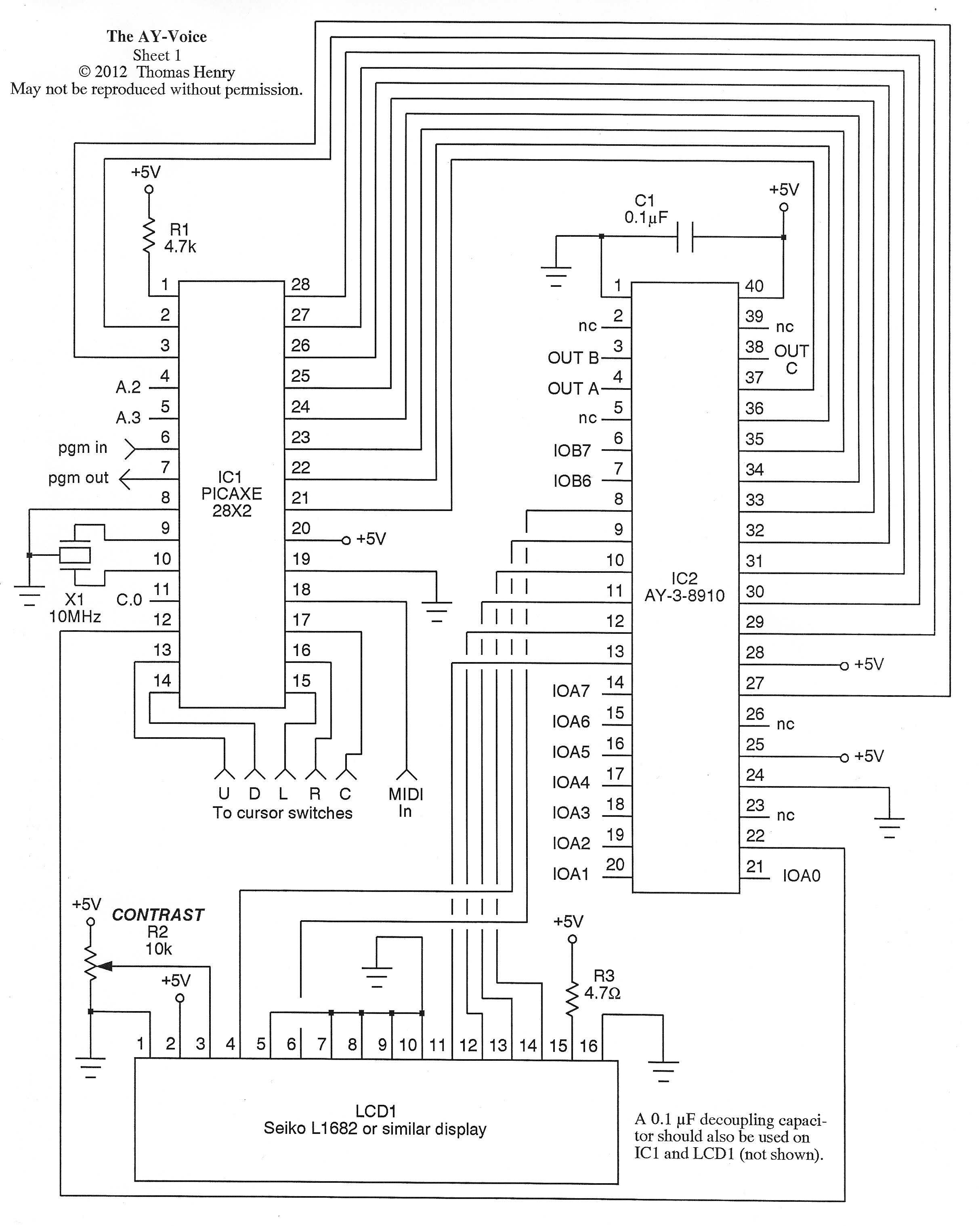

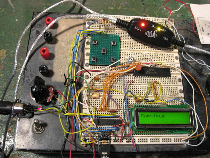

Anyway, here's the newest update. The MIDI interface works wonderfully. I've attached the updated schems, code and a snapshot.
For testing purposes the code only responds to MIDI Start, Stop and Continue, for several reasons. First, these are only one byte commands and hence fast to parse and handle. And then, this way I could keep the code really short, as you'll see. Also, I didn't have to worry about channel numbers. But even with bigger MIDI commands (three bytes, say), I'm still reasonable optimistic the Picaxe can keep up. It's the background serial receive and the 1024 byte queue that makes me feel that way.
But, if we do bump into a brick wall with the timing, I do have a backup plan. Uncle Krunkus, you said you were interested in how I do these things. Well, there's my biggest secret: always have a backup plan.
For testing, I used a laptop connected to a USB MIDI converter, running MIDI OX. I had MIDI OX send all manner and combinations of Start, Stop and Continue, and everything worked perfectly. The LCD display shows which command has been received in real-time. What made this test particularly impressive is that I didn't have to filter the incoming data. In particular, those meddlesome MIDI Clock signals just kept flowing in and the queue had no difficulty dealing with them.
So, give it a try and see if you agree.

MIDI interface in place now
 Filesize:  307.25 KB
 Viewed:  592 Time(s)
Schematic, Sheet 2
 Filesize:  457.09 KB
 Viewed:  630 Time(s)
Schematic, Sheet 1
 Filesize:  866.74 KB
 Viewed:  606 Time(s)

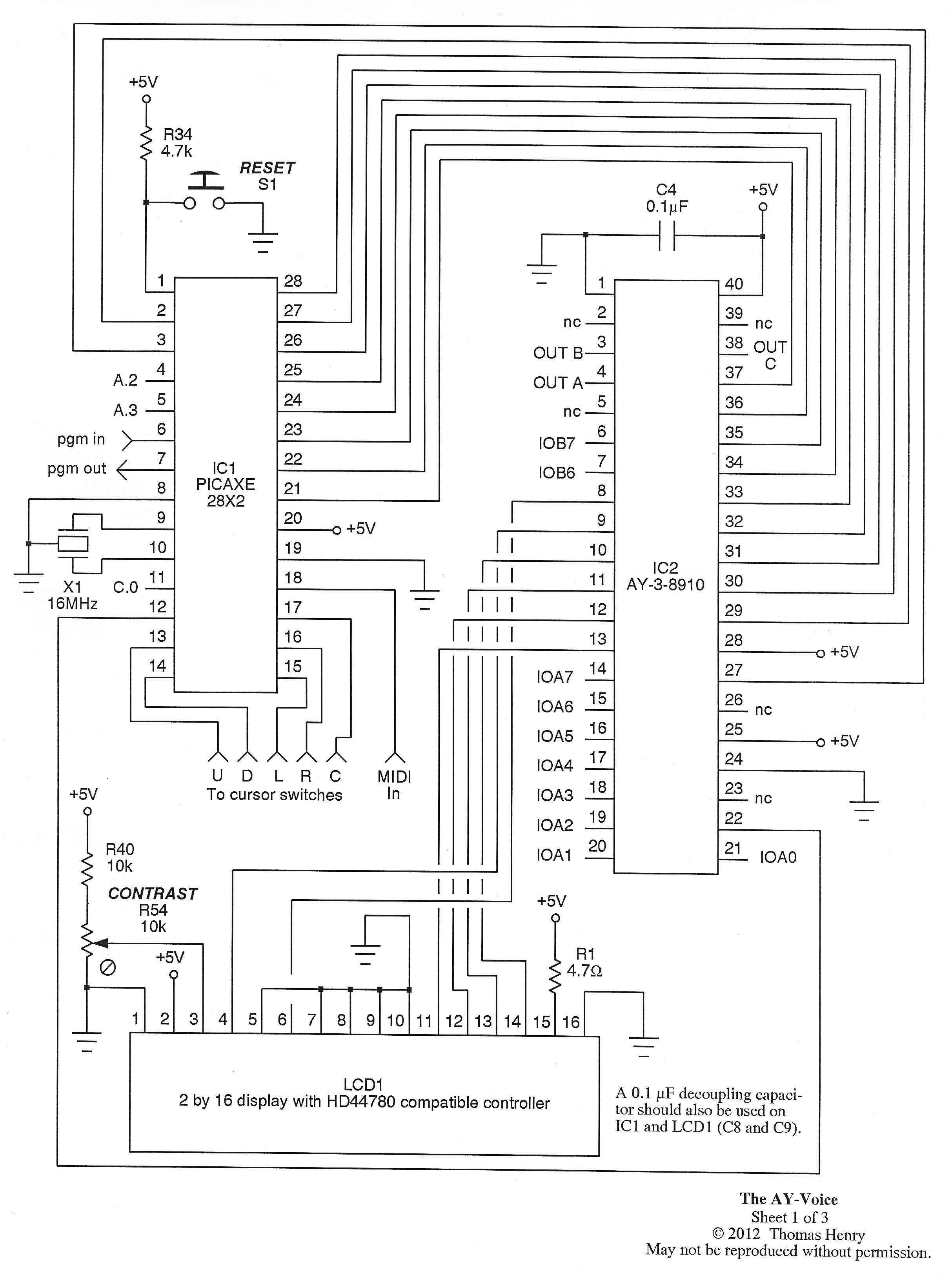

Okay, the gates are in place now, so the digital design is complete. They work just fine. You can try them out with the sample code attached; it sweeps the LEDs as a marquee.
The gates outputs are +5V, of course, with a 1K output impedance; this is the usual Electronotes standard. Notice too that they are short circuit proof and the transistors protect the AY from anything goofy happening on the outside.
Keep in mind that I used negative logic to bring the parts count down. So, a zero means on. You can use the NOT command in the code to reverse this.
The gates can also be configured to give trigger outputs, just with a change of software. In either case, the gates or triggers can be assigned their own MIDI channel, separate from the sound generators.

Schematic, Sheet 2 (Sheet 1 is unchanged)
 Filesize:  601.65 KB
 Viewed:  547 Time(s)

Well, the design is done now. I've attached the three sheets of the schematic and the parts list. I'd appreciate it if you don't copy these, but just link back to EM.
This design took nearly 100 hours, but was a real learning experience. I hope you were interested in seeing what was involved. Time is limited for me now, so this'll be the last major update on EM. In any event, the project doesn't seem to have garnered much interest, so I'll pull back and work on the firmware for myself in the odd moment. Thanks to everyone who contributed an idea. If someone is interested in doing a PCB please PM me
Thomas Henry
