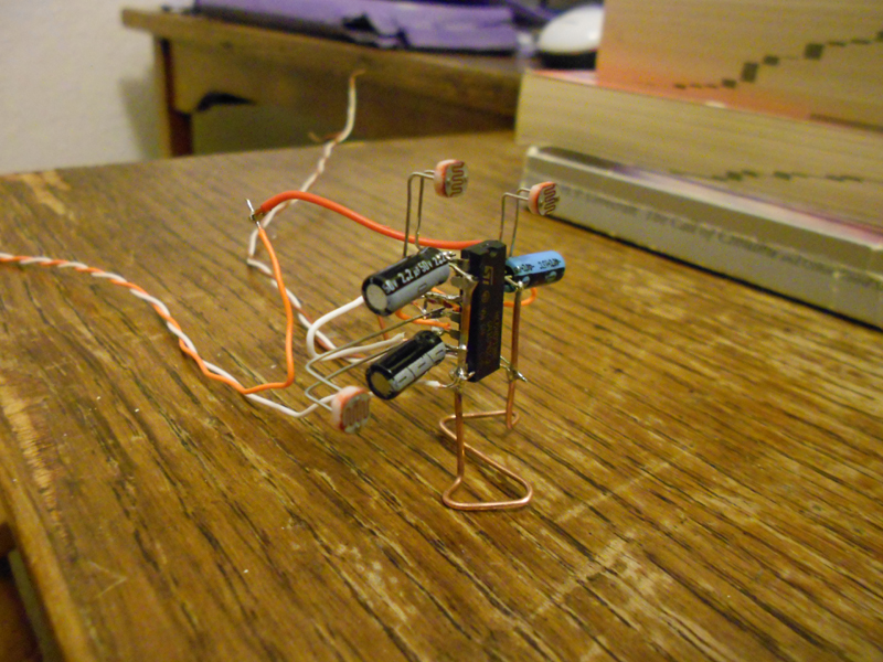

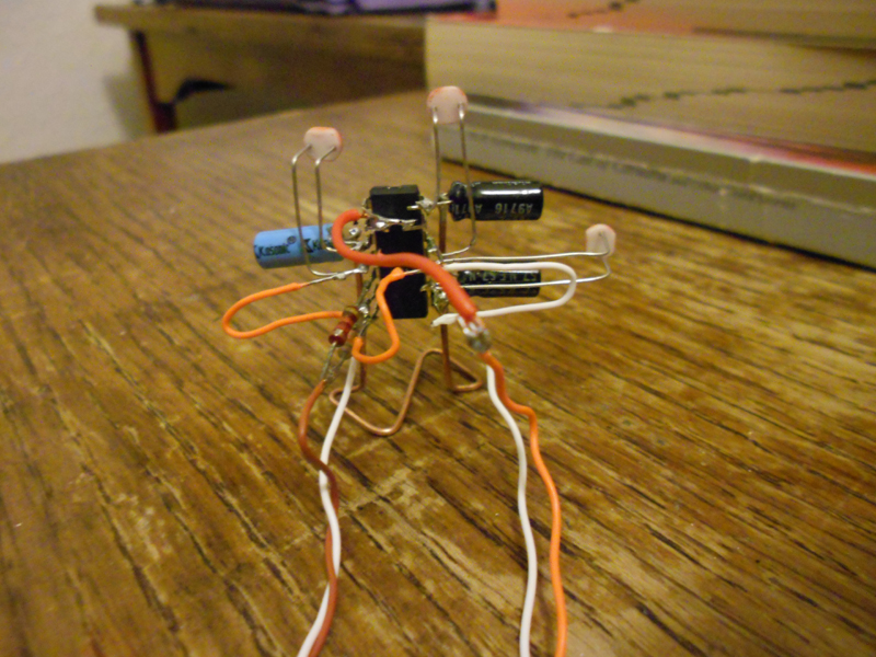

How long was I gone? About 2 hours? I think that's a pretty good conception to completion time Wink Three LDR controlled oscillators on a 4093 chip, two are heterodyned with one of the remaining gates and then used to gate the third higher frequency oscillator.
The wires coming out of it are the output and power connections. It is powered by a 3V coin cell and output was through a resistor voltage divider so it wasn't giving full 3V output (I thought that might be a bit much for my computer's line in) after the voltage divider it was more like 300mV, it was happy with that Smile
I think I'll call it Graxnorgrath; "The thing from another world, of junk"

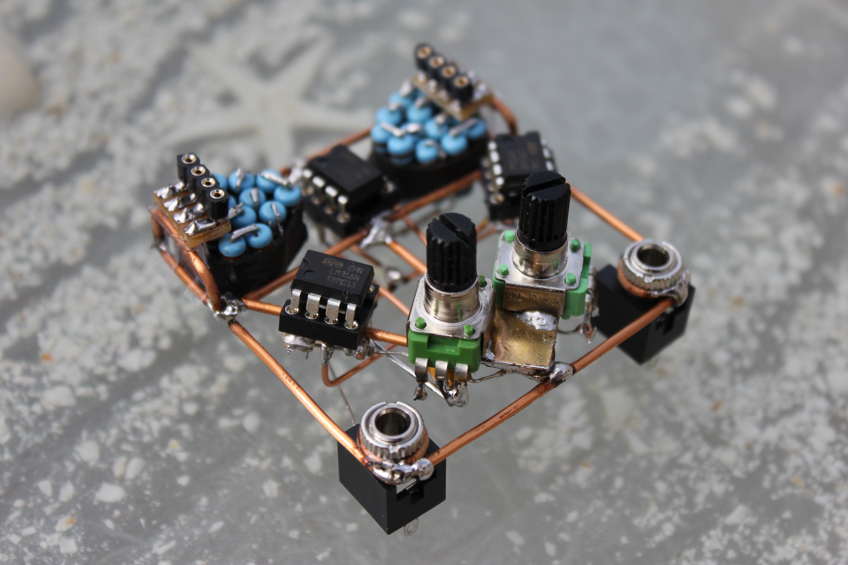

Here is the latest freeformed module for my Lunetta Guitar.
It has 2 x 4Bit R/2R Ladders at the top to change Digital Gates into Control Voltages then these are spat out to 2 Slew/Glide circuits - out to 2 minijacks that I can connect to my outboard modular gear.
This module works real well and Im very happy with the results.
Might up a video of it if there is interest.

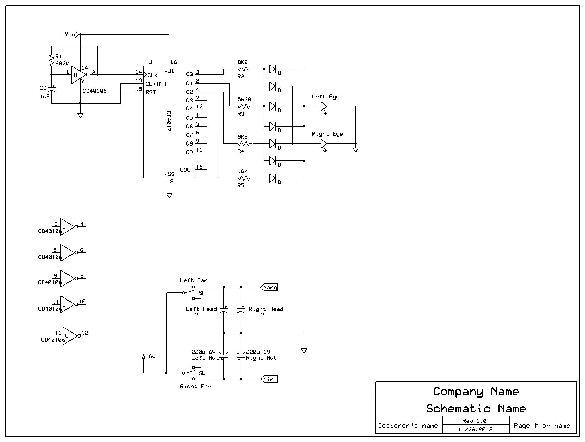

I've breadboarded the circuit so far and the schem looks like this.
Not sure if I should replace all those diodes with a quad OR gate, cos I think the diodes will fit in better, and probably look better too. There's already about 5 * 14+pin chips planned which I have to find places for.
