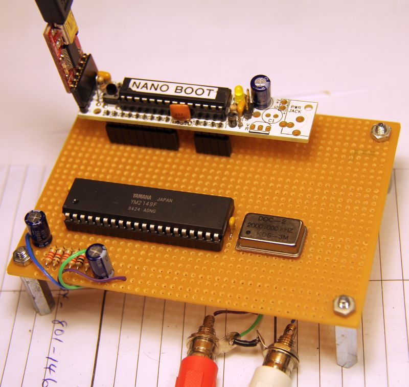

PostPosted: Tue Jul 03, 2012 8:53 pm    Post subject: Reply with quote  Mark this post and the followings unread
I am pleased to report that MIDI, all three oscillators, noise, and the cursor keys are all working for me with the correct resonator Embarassed and the serial debug output is at the correct baud as well. The LCD, still not so much.
I'm wondering if the piece I'm using (scavenged, not a direct match for what Thomas' design calls for) may not be pulling too much current or some such ... and of course I could have wired something wrong too.
I have another LCD on its way, but I think I have enough functional here to start messing with/testing the MIDI code.

Greetings,
I exhausted all of my ideas trying to get the YM2149 SSG chip to generate sound on the AY-Voice. I was determined to make sure these chips were good after the AY chip experience. Looking around the web I found this:
http://electronicfields.wordpress.com/2012/04/09/ym2149-sound-generator-arduino-fast-pin-switching/
I decided to try and get the YM Streamer setup working so I connected the Arduino as seen in the picture. The MP3 file which is attached proved imediately that the Yamaha chips are good. With this testing and analysis I have come to the conclusion that the PicAxe is not able to meet the 50nS timing constaints that Yamaha has stated in the datasheet. The AY chips have the same constraint but apparently is much more forgiving.
Unless I am missing something, I don't see anyway to speed up the data control sequences since you cannot embed assembly code into the basic.
I have to say that I am a little disappointed with the PicAxe since it does not allow assembly inserts, and that it does not scale the timing (Pause instructions) and baud rates based on the clock frequency that is clearly defined.
I know that Thomas has expressed that a new thread be started if the AY is connected to an Arduino in place of the PicAxe, so I will not discuss it here anymore.
I think the MP3 file is pretty impressive and has been recorded with no effects added. It's a good way to know what these chips are capable of if you were't around in the 80s when Atari and arcade games were in full force. The YM2149 was wired up for stereo with Ch A on the right, Ch C on the left, and Ch B mixed to both L & R. The song was one that I found on the web called LED Storm1.ym. It is streamed from the PC/USB port to the Arduino at 115.200 kB. The 16 AY registers are dumped to the AY chip at a 50 Hz rate.
To summarize:
Both the AY & YM chips work with the YM Steamer, but only the AY chip works in the AY-Voice. I do not hear any real differences between the AY & YM. I see no reason to go with Yamaha chip over the AY if you are building the AY-Voice. Don't forget to add a 10k pull-up resistor and a 10uF capacitor to ground on pin #23 (Reset) of the AY-3-8910 chip.
Hope this helps someone,
THeff

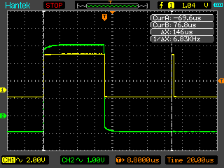

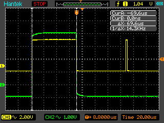

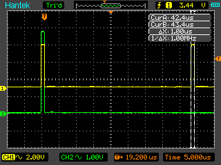

PostPosted: Tue Jul 10, 2012 12:44 pm    Post subject: Reply with quote  Mark this post and the followings unread
elmegil,
I believe the PicAxe Basic is the timing bottleneck. The PIC hardware should be able to handle this timing with no problem using "C", or PicBasic Pro with maybe some assembly routines.
The pictures I have attached show the Arduino running in a streaming mode (playing a song), and the PicAxe is running a small loop that only executes the AY-Voice "Store:" subroutine. From what I see the time issue is related to placing the "Value" on the bus and the latch width. The Write pulse seems fine and can even be shortened if needed. The setup time for the Inactive state is also quite long. If you look at the "Store:" subroutine there are no delays except for the AY_Pulse which Thomas set to 2.5uS. The scope shows that this is right on the money with a width of 2.4uS.
On all the images the yellow trace is BDIR, and the green trace is BC1. The pulses on the left indicate the latch mode, and the pulse on the right is the write pulse.
Regards,
THeff
