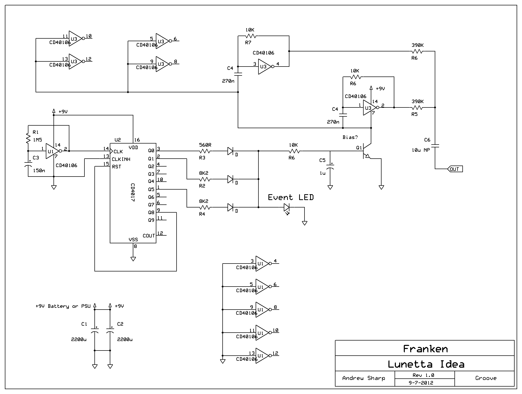

PostPosted: Mon Jul 09, 2012 6:46 am    Post subject: Reply with quote  Mark this post and the followings unread
Here's the schem,
I'll update soon with proper designators, and there are some ideas I want to add as well, but for now, all the values are what I've got on the breadboard.

PostPosted: Mon Jul 09, 2012 9:33 am    Post subject: Reply with quote  Mark this post and the followings unread
Ah You're power starving the 40106 Smile makes sense now, one could also add interchangle outputs from the 4017 for a different sequence.
PostPosted: Mon Jul 09, 2012 8:39 pm    Post subject: Reply with quote  Mark this post and the followings unread
Oh yes,
The sequencer part could be expanded to enable any type of 1-10 stage pattern, and the resistors from that matrix could be variable (like a baby 10 -> APC).
The diodes really don't do much at the moment, I included them because they are on the breadboard, and I've assumed they are having an effect (although small) on the "instant biasing" of the transistor. I'm more interested in that biasing, and how they could give controlled starvation of the 40106 oscillator. The diodes would be needed to send a separate pulse stream to a second transistor/40106 oscillator block. This will follow soon hopefully.
I also want to try a three stage oscillator (using the unused inverters of U3) This could then have extra "filter" components tapped off the middle inverter. I'm thinking capacitive coupling, diode clamping, partial bypass with high value resistors, or, more likely, a combination of these effects. But I wanted to get the basic idea going first.
The decayed starvation of Q1 with the cap to ground from the base, is also a major part of getting this kind of sound. It too could be tweaked, or mixed with other conditioning of the pulsestream.

PostPosted: Fri Jul 13, 2012 2:01 pm    Post subject: Reply with quote  Mark this post and the followings unread
I got disenchanted with the filter circuit I was working on so I did this tonight instead. Turned out to be brilliant Very Happy
I've got some serious control going on too, I made an LFO to control the transistor and got some incredibly crunchy sounds out of it, I will post a video of them tomorrow.
What I'd like to try is wiring up the transistor like the simple transistor inverter; 10k~100k on the base, 470ohms~1k on the collector, power the circuits from the collector.
Reason being that things got a bit perculiar (which can be good) but this resulted in very high frequency oscillation when the transistor was in the "off" state. Also the output wave was pushed up against the top rail of the PSU, due to the circuitry being "on top" of the transistor. To summarise all problems observed; the transistor is on the ground side of the circuit, so pushes the resulting output wave up untill it gets very small and biased right up to the top rail, then it all oscillates in really high frequency. The inverter method should remedy this Smile

PostPosted: Mon Jul 16, 2012 11:26 am    Post subject: Reply with quote  Mark this post and the followings unread
A little update, the transistor-inverter method does work, and with better control. With that method, earlier today, I made this sound I've wanted to make for ages, but it turns out I was accidentally powering the starved portion of circuit through an un-used cmos gate IC. So that was going wild and adding new timbres.
