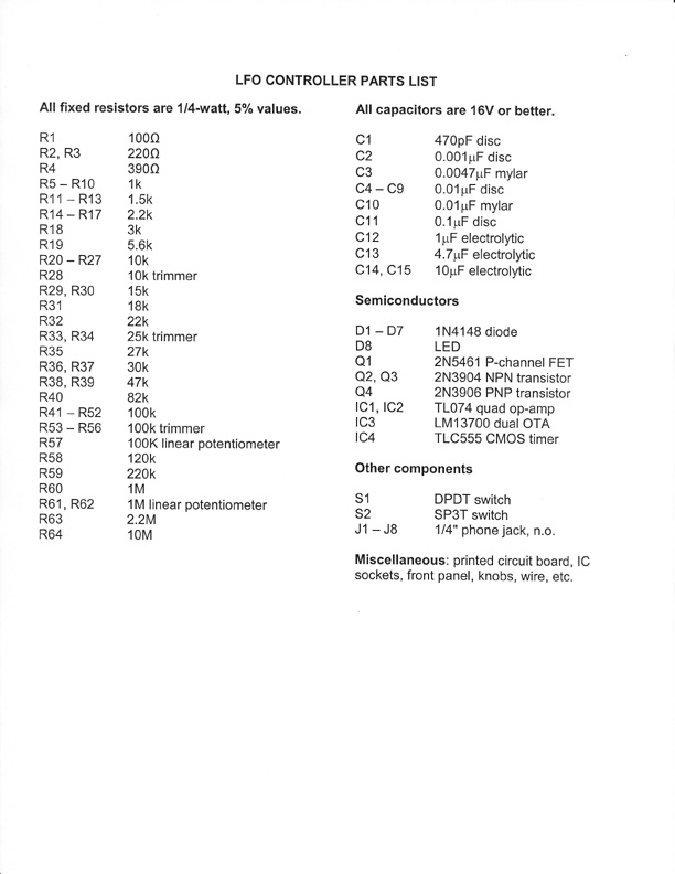

Hi gang,
Well here we go again with another project. This really is the best LFO I've done to date, from a musical point of view. There are lots of features and its behavior is very smooth on all fronts, if that makes sense.
Also included is a complete article I wrote up for it. I had originally intended this to go to a magazine, but somehow things got in the way.
As usual, I would appreciate it if you keep this stuff for your own personal use and not pass it around or try to go commercial with it. Always link back to the source in EM. Get in touch if you feel the need to do a PCB or something.
Dig in!
Thomas Henry
Schematic --- Sheet 1
 Filesize:  130.05 KB
 Viewed:  1680 Time(s)
Schematic --- Sheet 2
 Filesize:  101.42 KB
 Viewed:  1637 Time(s)
Front Panel
 Filesize:  33.68 KB
 Viewed:  1297 Time(s)
Parts List
 Filesize:  78.28 KB
 Viewed:  1623 Time(s)
LFO Controller.pdf
Article
 Filename:  LFO Controller.pdf
 Filesize:  41.88 KB
 Downloaded:  1987 Time(s)
