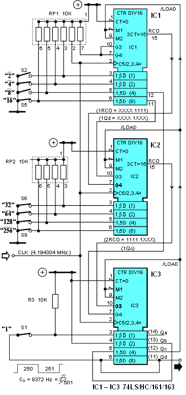

If you inter-connect three '163-type counters in the quirky configuration shown here, then you have a switch-programmable divider with an output that is always either a square-wave (even divisors), else a pseudo-square-wave (switch S1 closed for odd divisors).
Achieving this result is harder than it sounds, and exploits the exclusive dual enables of the 74HC163 plus its almost-unique synchronous load together with a highly unorthodox connection scheme, used to overcome problems often encountered with stand-alone programmable dividers, viz.:
 Pulse or spike output.
 Switch setting n may equate to divisor (n+1) etc.
 Extra “glue-logic” required.
 Operational frequency must be doubled in order to derive square output.
The operation of the circuit is not easy to understand (and even its designer got confused more than once!) and although it was rejected by Elektor as being “too simple for our readers”, there is not much point trying to understand how it works unless you need to keep your brain active. The simplest way of explaining it is that IC1 & IC2 count half-periods (first the Space, then the Mark) so that switches S2 – S9 assume double their usual binary value (“weightings”). IC3 functions as timing control and output toggle stage. With S1 closed (on), an extra clock period delay is injected into the output “space” (i.e. IC3/Qd = LOW) period.
With all 9 switches closed (divide-by-511), the output mark-space ratio is 255:256.
A limitation to “what-you-see-on-the-switches-is-what-you-get”, is that the minimum divisor is 6, even if the switches are all set open/off (value = zero).

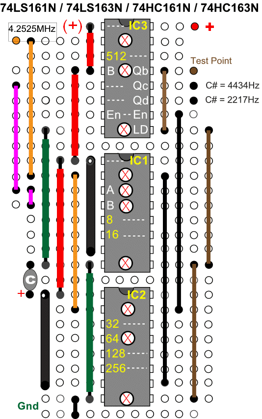

To prove the design as quickly as possible, the prototype used 4-way switch-banks suited to the data inputs of the ’163N. The switches are sandwiched between a 10K pull-up SIL pack and a 220R pull-down (inverted, pin 1 to ground). These can be found on the surplus market (in various lengths) remarkably cheap and make a quick, neat job of wiring the switches to pseudo-ground.
The strip-board track is left uncut at all pin 16s and at IC1 pin 7, and at IC3 pin 6 (including underneath pin 8 of the unused switch). (You may also wish to limit track-cutting under IC3 so as to allow a link from pin 13 to pin 5).
This layout is unsatisfactory in that three out of four switches in one switch-bank are un-used. It would be more aesthetic to use a 10-way switch-bank, perhaps aligning switches 2 - 5 against IC1 pins 3 - 6.
This layout is convenient in matching the switches to the counter inputs but is unsatisfactory in the isolated position of the odd/even (value = 1) switch, S1, and the 3 switches which have no function.
Showing switch settings to divide 4.19403MHz. by 501 to generate a Top-C pseudo-square-wave.

Those black things are SIL (Single-In-Line) resistor packs of non-critical value, to be found cheap on the surplus market in various lengths.
If you use one of 7 or 8 pins, then IC1 is automatically enabled (by pulling pins 7 & 10 high).
When you build this circuit on a piece of virginal copper-strip board, the output mark:space is 256:257 (i.e. divide-by-513).
Lesser divisors (in quantum multiples of 4) are obtained by using a track-cutter (or drill bit) between the input/output pins of IC1 and IC2.
The pull-up resistors then come into play.
By cutting the track between IC1 pins 4 and 13, the output is reduced by 4 (to divide-by-509, the mark:space being reduced equally to 254:255).
To reduce the counter from divide-by-513 to divide-by-301, it is necessary to cut alongside those pins marked:
301 = 513 -128 -64 -16 -4 [derivation of top Ab from 4.0 MHz by cutting four of seven tracks]
Once the copper tracks are broken, "repair" is made by linking inputs to ground, as required to increase the output from the minimum count.
The minimum count is 5 with the feedback link shown, or 4 if the feedback link is removed (when implementing even divisors).
This minimum figure is an "overhead" which comes from the circuit operation. For the moment, consider it as a supermarket deal, "divide-by-296, get 5 free!"
301 = 256 + 32 +8 +5 (free bonus) [same derivation of Ab from 4.0 MHz, but calculated as linking three of seven pullups to ground]
501 = 513 - 8 - 4 [deriving top C from 4.194304 MHz by cutting two tracks]
501 = 256 + 128 +64 + 32 + 16 [deriving top C from 4.194304 MHz by adding 5 links to ground]
8-3 overflow counter : To be explained in a later posting — things are technical enough for the moment!.
