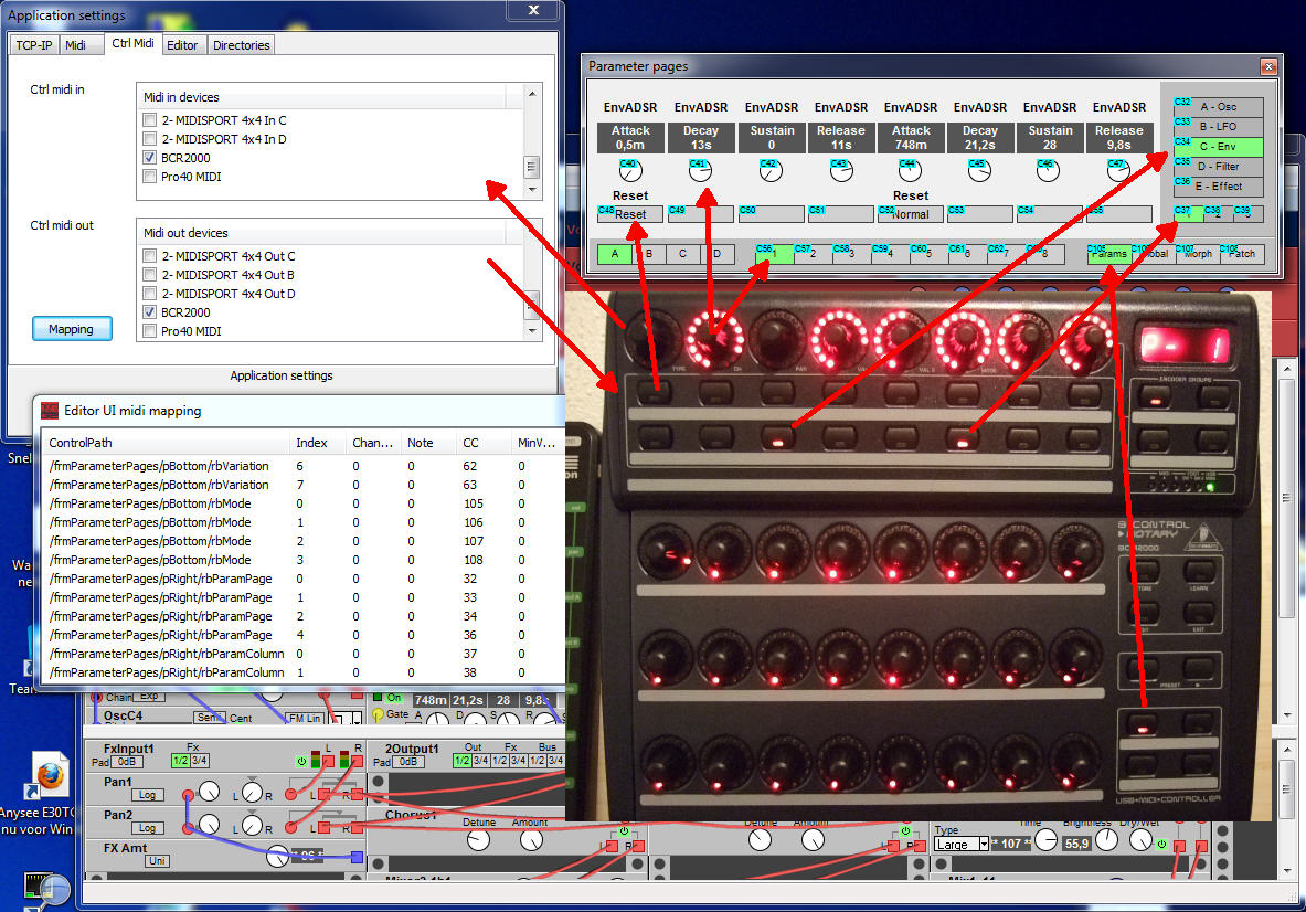

PostPosted: Thu Sep 06, 2012 1:43 pm    Post subject: Reply with quote  Mark this post and the followings unread
Here is a picture of what I'm working on, it's something for engine owners I guess.
On the application settings I made a Tab "Ctrl Midi", there you can specify your midi-controllers. It works like in ableton, after you specified the midi devices, you can turn a knob on the device and with a right click of the mouse you can connect it to a control on the parameter pages form, so that way you can create a midi mapping and the mapping will be saved in the ini-file.
The arrows show how I made my mapping of the bcr2000 at the moment: the top row knobs correspond with the 8 knobs on the parameter pages, then the row of buttons below correspond with the 8 buttons of the parameter pages.
The first 5 buttons on the second row select the parameter page, and the last 3 select the column.
And with the push function of the top row knobs you select a variation.
And finally the four buttons right below on the bcr2000 select the function: parameters, global parameters, morphs or patch parameters.
Don't know yet what to do with the 24 knobs below.
The nice thing about the bcr2000 is the feedback function, so if you specify the bcr2000 in the Ctrl midi output list, the editor will send midi back to the bcr2000, so if you switch for example to another variation, the leds around the knobs and on the buttons will show the new values.
Pity there are no displays to show the parameters your editting.
So not quite like a g2 keys, but maybe getting close...

I've made a new version of the editor (v0.25). The main changes are the following:
- implemented a couple of new messages (voice count, master clock, memory bank functions)
- all the module displays should display values in the correct format
- made a patch manager function
- made a patch browser and parser function
- made it possible to control editor functions with midi
- restructured the code repository
- wrote a help file.
The help file is included in de zip, but can also be read online here:
http://www.bverhue.nl/G2EditorHelp/NMG2_Open_source_editor_help.html
