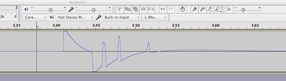

Oh wow - wow wow wow amazing! Maybe I've had a bit too much caffeine tonight, but I am really excited about this circuit that I created. It's basically just an all-pass filter with two components added: a capacitor and a resistor. And it's making percussion sounds! wow!
See the attachments below for a schematic of the unmodified all-pass filter circuit, a waveform captured via Audacity, and a short audio sample with a drum beat every 4 seconds approximately.
The Added components are a cap from the noninverting input to ground and a resistor from a pulse source to the noninverting input. The resistor allows the input of a stim pulse a-la-KS normal stimulus, and the capacitor closes the KS loop with a first order low-pass filter.
Component values: R is 330k, C is 0.1uF, Rx is 1Meg in feedback position and 100k in input position. Added parts are resistor = 330k and capacitor = 2.2uF. That's it! well, that and an LM358 opamp does the job.
This is a fascinating discovery because it is a truly minimal KS implementation if it turns out that I am correct in understanding how it works. The theory is that the all-pass filter acts as a delay line. Adding the resistor merges it with an inverting summing amp for stim pulse input, and adding the capacitor puts a low-pass filter in negative feedback. All three subcircuits are sort of morphed together into one beautiful KS opamp circuit. wow!
I'll play with it over time and report results in this thread.

Audacity captured KS opamp waveform

I don't fully understand KS, but to me it looks like you made a pulse triggered oscillator, similar in function to the T. The difference with yours is that it looks like the trigger pulse come through the circuit too. Which can be a good thing if you trigger it from a white noise pulse and add a lowpass filter on the output. That should make a good kick drum sound.
Have you tried changing the values of C3 and C4? That might change the decay length.

Cynosure wrote:
I don't fully understand KS, but to me it looks like you made a pulse triggered oscillator...
Well, Cyno, I feel that it's not an oscillator because the oscillation is not sustained, and that it is a KS loop because of the merging of the three KS functions as described previously, as well as the way it sounds just like a KS loop synthesizing percussion with a short delay amount.
In other words it looks like a duck and it quacks like a duck, so maybe it's a duck. That's no guarantee though, just my perspective at this juncture.
I dont' have much of a cap collection for varying those caps and the layout is tight, but what I have found is that changing any of the caps shuts it down except the input cap which is optional in most cases.
Les

I added artificial ground and lookee here, nice decaying oscillation riding on the pulse response, sounds good too!
Les

That looks exactly like what I get out of my TR-808 Kick Drum circuit. Very Happy It's damped enough that it doesn't sustain oscillation either.
I think that the two things "Bridged T" and "Karplus Strong" are probably related to each other.....

First, the sound of Les's circuit is very nice, resonant drum like.
As for Karplus-Strong:
The Karplus-Strong theory and implementation is described in great detail in two places, the Stanford University web site and in their patent. Using google to find that is left to the reader.
While I agree that there are similarities between a filter with negative feedback and KS, they are not the same. One is a filter (which exhibits some small amount of delay), the other is a delay line attached to a filter. While they have attributes that are similar, that doesn't make them the same. For example, a bicycle and a car both have wheels, both are vehicles, both can turn corners, but one would never call a bicycle a car, they are clearly different.
In the Stanford documentation, the system is described as a delay line capable of holding a waveform which is connected to a single pole lowpass filter. The output of the filter is routed back to the input (through an adder) which allows injecting an excitation signal.
If the filter described here has a delay line, then it sould be able to store a waveform, but clearly it cannot since it's "memory" (capacitor) can store the voltage value at only one instant in time. The delay line in a Karplus-Strong system holds one entire cycle of the waveform.
Note that "delay" and "delay line" are two different things. If something has the characteristic of delay, that does not mean that it is a delay line.
The point of the work by Karplus and Strong was to model a vibrating string (plucked or hammered). It is explained that the length of the string is modeled by a delay line while the filter models the energy lost when the wavefront meets the string's termination point. Most of the energy loss is at higher frequencies because the filter described is a single pole lowpass type. This gives rise to it's timbre similarity to an actual tight string. I've personally done a lot of work with this in my implementation of several instruments I call "Xarp" (sound clips are on the forum).
All throughout the definition on the Stanford site, you will see math that refers to discrete time, not continuous time. An analog filter does not operate in the discrete time domain, it operates in the continuous time domain. Because of this, the pitch of a Karplus-Strong system is set by two things: the sample rate of the system and the number of delay elements in the delay line. If the described filter is truly Karplus-Strong then it should exhibit the Karplus-Strong characteristics. Can it be tuned by changing the length of it's delay line? (no delay line, so that can't happen). Can it's pitch be changed by manipulating the sample rate? (no, it operates in continuous time, so there is no sample rate).
I realize that one of the timbre types described for Karplus-Strong is "drumlike", but that is not where it ends. As a challenge, if this circuit is a Karplus-Strong system (read the Stanford definition written by Karplus and Strong), then it should, through adjustment of the model, be able to make tight string sounds like harp, guitar, piano, etc.
