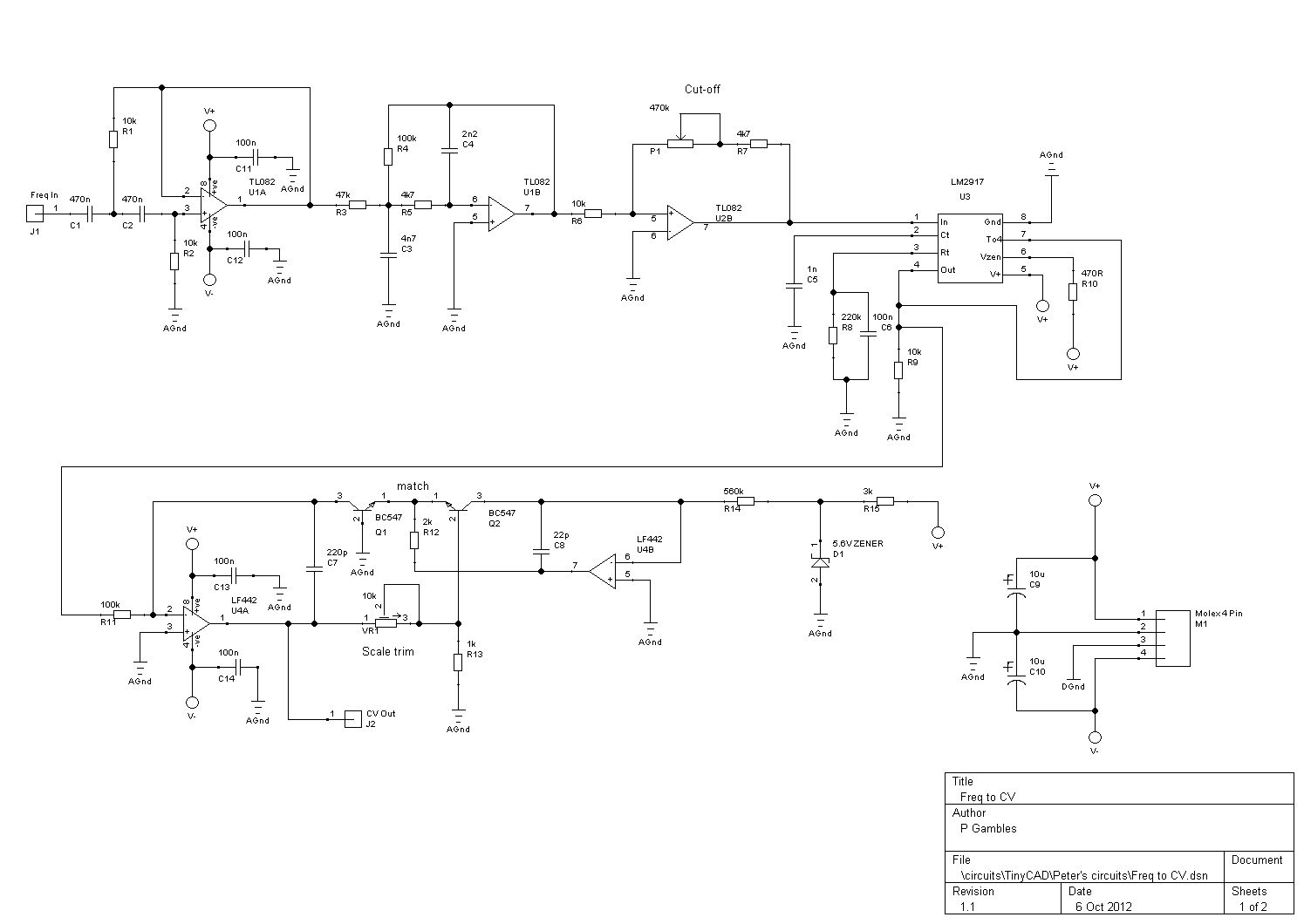

Well, I'd bought a frequency to voltage converter chip, so I thought I'd have a go at a frequency to CV converter module.
HEALTH WARNING: This isn't a pitch to CV unit - though the 1V/Oct tracking isn't too bad. It also isn't a 'play your guitar through your synth' unit, though you can use a guitar as a CV source. There are far more complex designs out there that aim to achieve those goals, and from what I've read, this chip is not the best choice for that more precise job.
My main purpose was in fact to build a reasonably simple circuit so that I could take the audio out from a theremin app on my tablet and convert both frequency and envelope into CV's, to turn the synth into a sort of theremin, controlled by the tablet. It's not too bad at that. It also works reasonably well with a Native American flute, again deriving a CV to control an oscillator. It can be got to work with an electric guitar, though it's... eccentric.
I'm using a polyfusion envelope follower to extract the envelope.
A particular feature [flaw, depending on your point of view] is that it takes a clearly audible time for the frequency to change, especially from no signal - that leads to each note starting with an upward swoop.
Schematic attached. It's basically three subcircuits: a wide bandpass filter followed by a comparator to condition the signal into a square wave, hopefully of the fundamental (this derived from the Slacktave), then the frequency to voltage chip, from the datasheet, tweaked for best performance for this purpose, then a log amp from National Semi application notes (followed by a times ten amp and offset trimmer (the scale trimmer in the log amp circuit is adjust to about 4.6k to yield 100mV per octave, which is then multiplied up to 1V/Oct.
There's no temperature compensation in the log amp, and in my breadboarded circuit I haven't even matched the transistors: the app note says how to provide temperature compensation.
Any suggestions for improvement would be welcome!

Also, since most of the f-V ic's are aimed at control, you might get (even) better results by turning the signal into a squarewave using a schmitt trigger/ comparator.

I do think you are better off using the burr brown f to V IC's, especially the more expensive ones have pretty good accuracy.
You will need to do some pre processing (convert to square, as the IC's are aimed at tacho readout, and are really expecting square waves).
And perhaps do some post processing to convert to log, V/Oct.
