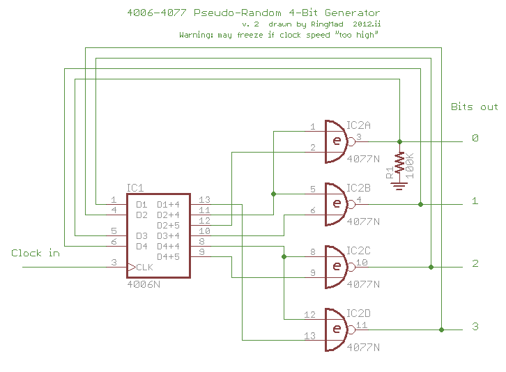

PostPosted: Wed Feb 08, 2012 7:48 pm    Post subject: Pseudo-Random Bit Generators Reply with quote  Mark this post and the followings unread
A friend of mine found some pseudo-random circuits in some books. I sat down and finally figured out Eagle CAD a bit and drew them up in a more Lunetta-friendly way (I hope... admittedly, these circuits are a bit complicated with their connections).
The first one uses a 4006 shift register and a 4077 XNOR . I've already posted about it [here: http://www.electro-music.com/forum/post-323156.html ], since it is a bit problematic and was hoping for a solution. Sometimes it can freeze if the clock speed is "too high" (sorry, I didn't measure the frequency). Usually, I have a switch that's normally "closed" and if the circuit freezes, I use the switch to cut the connection (between 4006 pin 1 and 4077 pin 10 works for me) for a second or two, then it unfreezes.
If anyone else has some circuits of this ilk, feel free to post them in this thread so we can have a collection.
If there are any questions about one, please refer to the chip pair or something so we know which you're talking about.
4006-4077 pseudorandom 4-bit generator schematic (updated 2012.02.17)

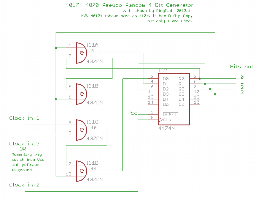

PostPosted: Wed Feb 08, 2012 7:53 pm    Post subject: Reply with quote  Mark this post and the followings unread
Here is another pseudo-random 4-bit generator circuit based on a 40174 hex D Flip Flop (only 4 are used, though), and a 4070 XOR.
This one is "more expensive" than the 4006-4077 circuit, since it requires 2 or 3 clocks instead of just one. I notice that if you use the bits in order, it seems to produce patterns that sortof count (up or down, I don't remember), but not quite. However, this can sound nice. Also, the outputs of the XOR could also be used as bits, thus making this an 8-bit generator.
40174-4070 pseudorandom 4-bit generator schematic

PostPosted: Fri Feb 17, 2012 3:55 pm    Post subject: Reply with quote  Mark this post and the followings unread
Attention to any who might have tried to build the 4006-4077 circuit before 2012.02.17... it turns out that one needs a pulldown resistor on at least one of the output bit lines, otherwise the circuit freezes. I've updated the schematic above to reflect that. Sorry.

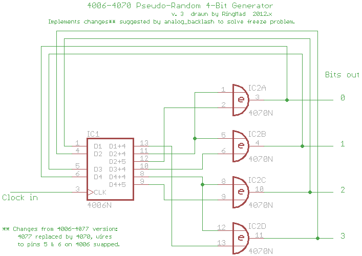

Posts: 430
PostPosted: Sat Oct 13, 2012 4:56 am    Post subject: Reply with quote  Mark this post and the followings unread
It turns out the 100k pulldown I mentioned in my previous post didn't really help on the 4006-4077 circuit. But analog_backlash has finally solved the freezing problem (it seemed to reach a steady state when run with clock speeds exceeding approximately 385 Hz). His solution was to replace the 4077 XNOR with a 4070 XOR (same pinout, just swap the chip), and swap the wires going to pins 5 & 6 of the 4006. Thanks, Gary!
I have redrawn the schematic to reflect these changes... see attached.
Alas, it appears that the 4006 shift register has been discontinued, but you may be able to find places that still have some left in stock.
James.
4006-4070 pseudorandom 4-bit generator schematic
 Filesize:  10.29 KB
 Viewed:  733 Time(s)

PostPosted: Sat Oct 13, 2012 8:08 am    Post subject: Reply with quote  Mark this post and the followings unread
Hi James,
Just noticed that you've updated these threads - thanks for the name check!
The only thing that I've noticed is that due to it being pseudo-random, if you clock it slowly it can seem a bit predictable at first (or am I just imagining this?). What I do is to turn up the clock speed at first and then slow it back down again after a few seconds. I don't know what the bit length of the pseudo-random cycle is, but if I do the above, it sure sounds random to me.
Gary
Posts: 430
PostPosted: Sun Oct 14, 2012 5:19 pm    Post subject: Reply with quote  Mark this post and the followings unread
Yeah, truth be told, I somehow have the impression that your amended version is a bit less random than the original. It almost seemed like it would always come up with the same pattern, somehow. It is rather hard to tell, though, not having some kind of data acquisition & statistical analysis. My method is to have the bits go into an R/2R DAC which feeds a VCO and listen and watch the LEDs.
I thought it might be handy to have some way of resetting or changing the pattern, short of turning the whole thing off. I still didn't come up with something entirely satisfactory.
James.

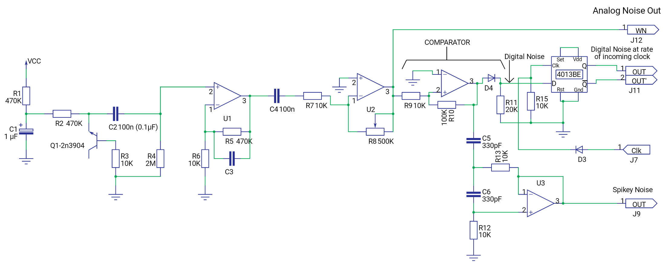

PostPosted: Fri Feb 19, 2016 9:24 am    Post subject: Reply with quote  Mark this post and the followings unread
This is another approach to randomness. A white noise source, in this case a reverse biased base-emitter junction of an npn transistor is amplified and then digitized using a comparator, this is an essentially random string of zeroes and ones at a non specific rate ( limited by the bandwidth of the system I'd expect ) This is presented to the data input of a 4013 ( effectively a 1 bit shift register ) and the 4013 is fed a regular clock ( perhaps 1/16th notes ) and an output stream is provided at the desired rate. By using more 4013's or a shift register 4 or 8 bit more output bits are possible.
Although the distribution of 1's & 0's is essentially random they are confined to finite pockets of time, sort of like quantized randomness.
This circuit was inspired by and partly based on the noise cornucopia circuit by Ray Wilson.
