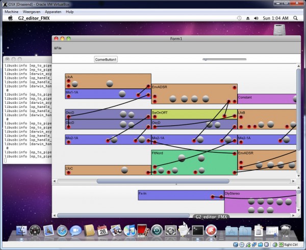

I couldn't help but try out if these cross platform claims of Delphi XE2 where true, and to my surprise, I actually got it working Shocked Including usb interface!
Here is a screenshot. It's running on snow leopard in oracle's virtual box.
Graphics are a bit basic, but the patch there is actually loaded from my engine over the usb interface!
Had to figure a couple of things out of course, but I was surprised how easy it went. With linux and freepascal I had a much harder time.

...yeah! thumb up - that is great news!! - thank you for trying!!!...

Excellent!

Hmm .. about time to order XE3 then Smile
Great news bruno!

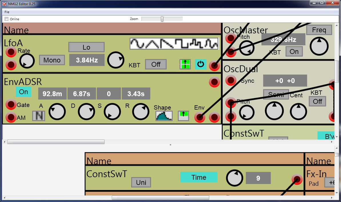

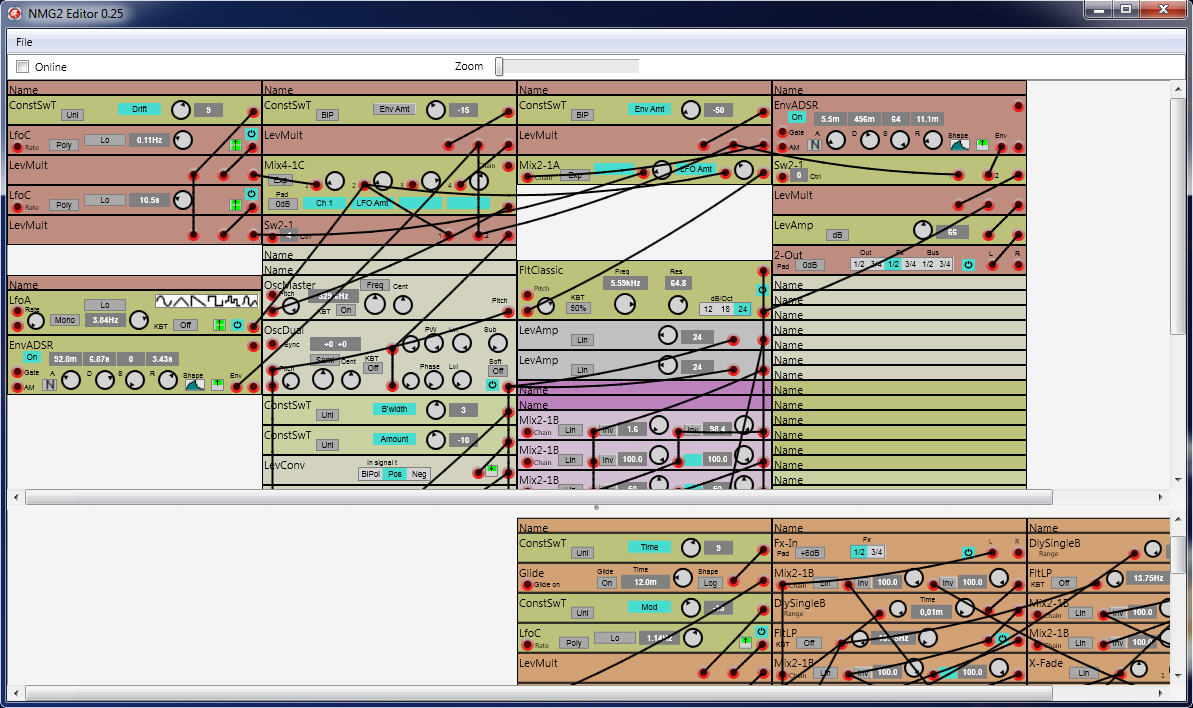

PostPosted: Mon Jan 28, 2013 1:13 pm    Post subject: Reply with quote  Mark this post and the followings unread
Such a pity that you are a programming illiterate Smile But maybe you're an computer graphics artist? I have discovered that I'm really bad at computer graphics.
I think I can maybe do the application code part of an osx application, because Delphi lets me compile for Osx, but when it comes to specific osx knowledge or computer graphics I'll have to throw in the towel.
What I would like to do is make some sort of application framework that is decoupled from the graphics. So someone who is more capable can design a skin for the application. I could reuse a lot of the code that handles the loading/saving of g2-files and sending messages over the usb interface from the windows application.
The main thing that would have to be made from scratch is the gui. I would like something that you can zoom in and pan. That's not so hard to make in the new delphi compiler since they are all focussing nowadays on the growing tablet market. The only thing is that you have to use graphics that allow scaling.
So in the screenshot I made a test application and with the 'Zoom' slider you can enlarge the gui. You can see in the zoomed-in picture that the bitmap/raster graphics become very ugly when enlarged, for example the waveform icons on the LfoA.
What I would like to do is enable the application to load SVG graphics (http://nl.wikipedia.org/wiki/Scalable_Vector_Graphics) in stead of the bitmaps and maybe also for some of the controls and panels. So anyone could design parts of the gui using for example http://inkscape.org/ and then give it the appropriate filename so the application can use it in the gui.
There will be quite a lot graphics that have to be designed.
But that's basically the status right now: a couple of ideas and modest progress on the application.
The main thing is that I don't want to work on it alone anymore, I think the project needs some other people involved not to grind to a halt.
