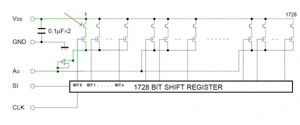

Actually, looking at the datasheet further, pin 4 is for Serial Input. I understand this to mean a voltage/current can be applied directly to this pin and then carried down the delay line. This would be for putting multiple 1d CCDs in a row and extracting all of the final output serially. Interesting, no?

OK, I've had a proper look at the datasheet for the IA2008-MB82A you linked to now.
willi wrote:
...But considering that the photons are somehow converted to electrons when striking the CCD perhaps directly injecting electrons would be a better or cheaper solution, if possible. Smile

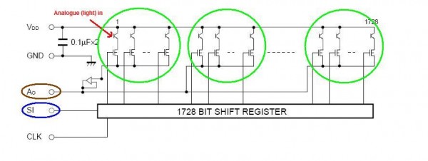

From what I can see, that conversion is done by light hitting the base of the phototransistors (pointed to by the red arrow) which then conducts a current proportional to the light intensity.
As far as I can make out, this device is not a CCD since it does not store a charge per pixel which is shifted from pixel-bucket to pixel-bucket and eventually to the output. I.e. there's no analogue shift register (bucket brigade). Instead each pixel is addressed directly for read out by the digital shift register. I think this would be classed as CMOS Passive Pixel Sensor. In other words it can't be made to function as an analogue delay.
An actual CCD could be made to work as a delay line though, using the laser trick.
It looks like that input (blue) is only for the digital shift register that controls which pixel's voltage appears on the output (brown). I guess the shift register input is for injecting bit patterns at the right moment to be clocked through to successively output the pixel voltages - note how the pixels seem to be grouped (green). The only analogue (light) input(s) is where the arrow (red) points.
DJ

Yes I agree, the red arrow seems to be the point that light enters the circuit. It seems a little confusing because I am under the impression they are more like photodiode, but whatever.
Photodiode or phototransistor, for the principle it amount to almost the same; as light enters the devices, both of them starts conducting in the forward direction. A phototransistor basically have more gain.
It's quite possible this is a CMOS sensor; I probably just searched for 'fax sensor' or something.
Yes it's an old'ish fax sensor - a CMOS PPS.
But, what about Ao? That is listed as an analog output on Pin 1, and the Timing Chart seems to indicate the pixels can have varying values, and those (greyscale) variables can't be encoded digitally with only 1-bit per pixel... I don't really understand why you would want to inject bit patterns into the shift register, but maybe that is for some kind of electronic shutter function. Perhaps it is not the best datasheet to reference for this concept, anyway.
The datasheet does indeed lack a good functional description. Therefore we have to follow the outlined circuit. And yes, it has an analogue greyscale output.
The bit(s) that are clocked through the shift register (BIT 1, BIT 2,...BIT n) will in turn switch on the Field Effect Transistor below each phototransistor (blue conductor), allowing them to conduct a current proportional to the light (red) that currently shines on the phototransistor. The opened path (green) allow the current to reach the analogue output pin (Ao). No charge is stored or shifted along, the light intensity at each pixel is read out instantaneously as they are addressed by the digital shift register.
The reason why we 'inject' our addressing bit(s) into the shift register (at the SI pin) is because we need to be in absolute control of the timing, so that we know exactly which pixel is being output at each clock pulse.
It's a very simple circuit, with a leisurely read rate of 1MHz, which leads me to think it's very old - used in early fax machines. In conclusion, this does not fit our application, but at least we learned how it works Smile

A CCD or CMOS APS (Active Pixel Sensor) will typical store the accumulated charge from the phototransistor in a capacitor. There may be control circuitry to switch on and off the flow into the capacitor (S&H) acting as a 'shutter', and a switch to discharge the capacitor in order to clear the image.
In a CCD the pixel charges are shifted from pixel-bucket to pixel-bucket, and row by row into an output BBD for a 2D sensor. In CMOS APS and PPS sensors the pixels are read out by direct addressing instead, and they can have the same charge capacitor and switches (or not, depending on the intended application of the device) to control current flow and to clear the image.
A CCD with the more advanced control circuitry can be used as a delay line (with light entering the first pixel) if the chip gives us manual control of the shutter and clear functions.
I'm sorry, I don't have time to go through the other datasheets now; it takes a bit of time to study them and prepare the text and illustrations. I may get back to that later if needed.
Still, there are a lot of chips out there. Although the laser trick is neat, it seems like it would be ideal to inject electrons directly. Smile
The problem with that is that there are no electrical analogue input. So we're back to the laser then Very Happy
