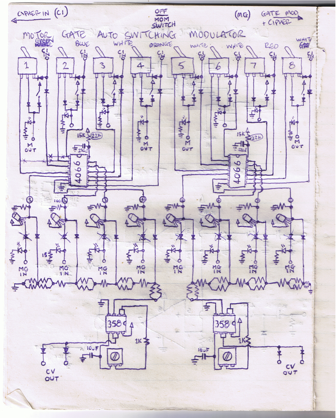

PostPosted: Fri Dec 14, 2012 8:33 am    Post subject: Reply with quote  Mark this post and the followings unread
Always so nice to receive such warm support from you guys here. Thankyou.
I really dont know what my life would be without Lunetta now, I think about this stuff 24/7.
Here is the latest module for the Lunetta guitar. Not sure I can name what it is but I can explain what it does.
I wanted to add more complexity to the plucking of the strings and have the ability to turn the plucker motors off aswell.
With the switch in the up position, the guitar runs as normal :ie each of the 8 motors are live/triggered as normal. Switch in the center turns motors off. Switch down allows the normal triggering to be turned on and off via gates into a 4066.
I imagine an lfo through a divider and the outputs used to bring the motors online and off to add some space, open up compositions with some periods of silence, then bursts of activity...
Momentary switch can be used to manually trigger the plucking.
2 4bit R2R DACs each through a slewing pot to take some CV for future filters and VCAs.
"8Band auto-switching motor gate modulating Duo 4bit Slewed CV source"
As you can imagine it took a while to make. It works and is already fitted on the guitar. Video soon.

JingleJoe
Joined: Nov 10, 2011
Posts: 878
Location: Lancashire, England
PostPosted: Fri Dec 14, 2012 12:10 pm    Post subject: Reply with quote  Mark this post and the followings unread
Sounds like a sort of gate sequencer or signal interrupter Smile
A great little device and marvelous work again, I look forwards to some video Wink

PostPosted: Fri Dec 14, 2012 1:38 pm    Post subject: Reply with quote  Mark this post and the followings unread
nathanxl:
That is completely amazing. How in God's name are you able to plan the geometry etc of such a thing! really beautiful.

PostPosted: Fri Dec 21, 2012 10:51 pm    Post subject: Reply with quote  Mark this post and the followings unread
Yes, to call it a Modulator was wrong, Interrupt is indeed what it does so Ill take your advice JJ.
@ Doug, I guess I just plan placement as I go along, making sure nothing is obscured or touching, Ive been lucky that nothing has needed alteration after construction. It is laid out logically and spends a long time on the breadboard before making it to freeform.
Thanks Mosc, I dont use anything to remove the flux. If there is a build up I can pick it off with my nail.
This module has really opened up so many possibilities for the Lunetta Guitar. I can sit with it for hours and be entranced, as you all can sympathize with. I have now decided on what the next module is... The open strings sustain for a long time which is nice but I want the ability to dampen the strings so... you heard it here first.
The "8Band auto-switching motor gate signal interrupter with Duo 4bit Slewed CV source".
