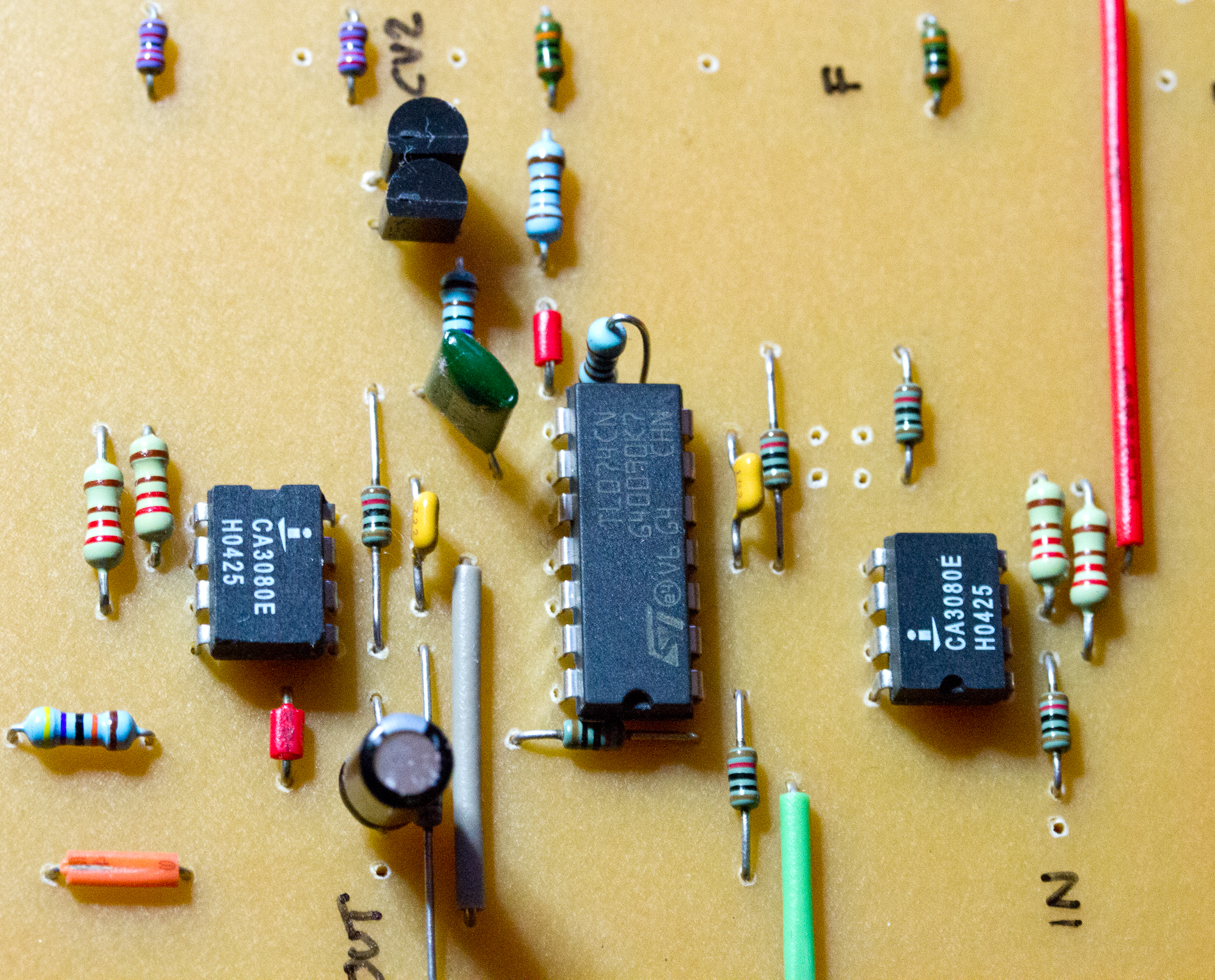

I used BC558C as per Rene's schematic (It was the only info I could find relating to the transistors as there doesn't seem to be a BOM anywhere)...
http://www.uni-bonn.de/~uzs159/rs20.png
Here's a photo I took before I replaced the chips, although they are in the same orientation, and I replaced the electrolytic capacitor for a film one...

Can you upload the full pcb size pic?
If I recall the 470nF at the output needs to be poly.
did checked the led oriontetion?

PostPosted: Fri Jan 11, 2013 10:01 am    Post subject: Reply with quote  Mark this post and the followings unread
The updated photo... I didn't fit the LED's as I thought these were only for display, not functionality...
*Edit*
LED's fitted, makes no difference, except they display when the source is plugged into the output (nothing happens on the input)

LektroiD
isak
Joined: Dec 13, 2009
Posts: 847
Location: Israel
Audio files: 18
PostPosted: Fri Jan 11, 2013 11:30 am    Post subject: Reply with quote  Mark this post and the followings unread
LEDs need to be green, it's important.
Don't plugin nothing to the input, first let's check if it's working right.
the LEDs need to be off (not lighted) when the reso is all the way down CCW.
Is it like that?
If yes turn the F to 12 o'clock and slowly trund the reso CW the LEDs need to light after half way (12 o'clock) and fully lighted when turning the reso all the way.
In this way it suppose to self osc.
Please try that and report back.

PostPosted: Fri Jan 11, 2013 5:03 pm    Post subject: Reply with quote  Mark this post and the followings unread
Green LEDs are in, but I can't do any more tests for two weeks, as I'm away. They only lit when a source was plugged into the output. I'm wondering if I popped the transistors too when I fed it with inverted power...
