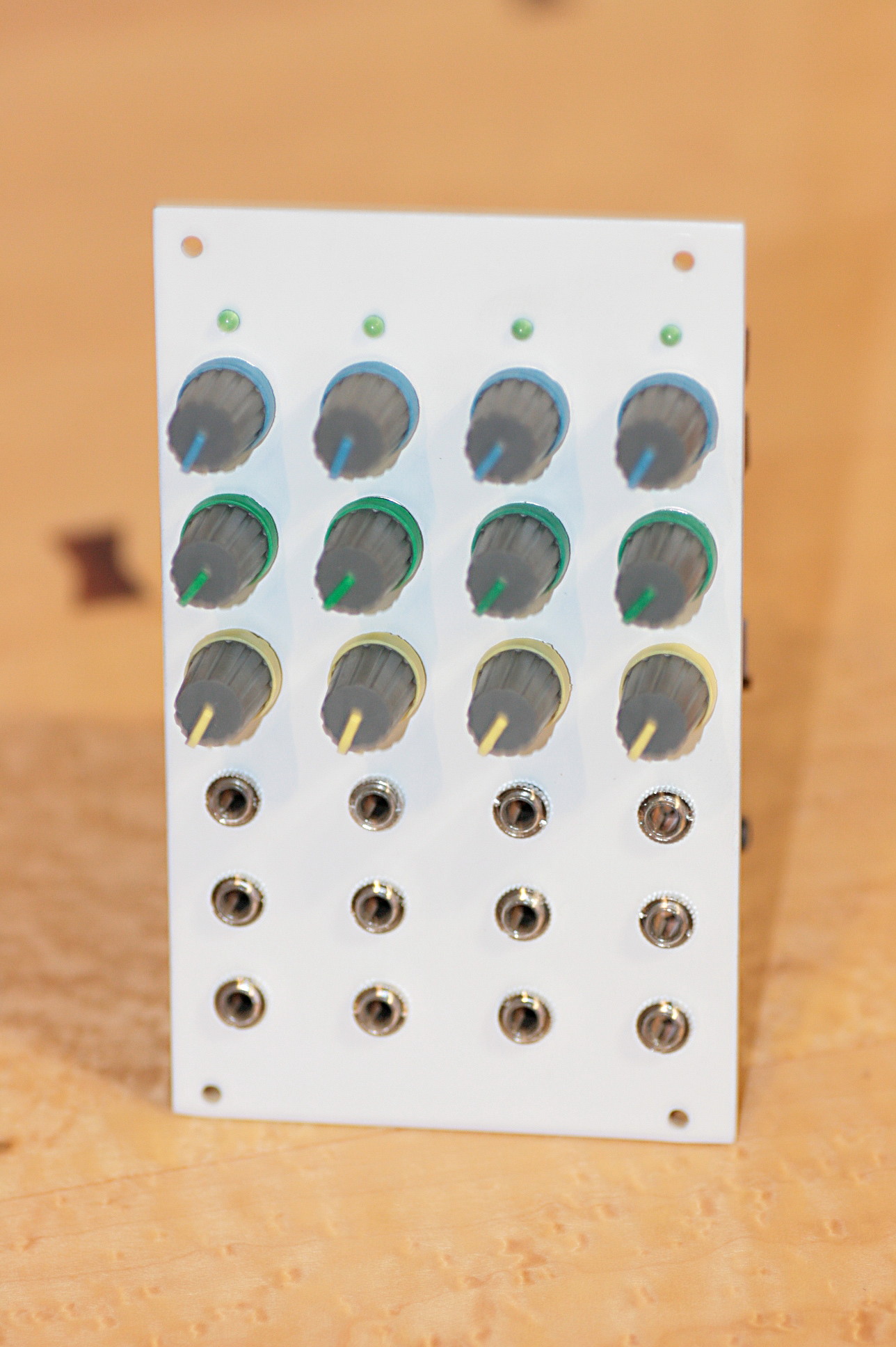

hmm is there interest in a 4HP version of the yves's simple VCA single cv input, signal input and only the 1 output , but there are connectors for the others if you want , i should get back a prototype in a couple of weeks.
this is the 2SC1583 version
did this one for myself and putting 4 behind a 16 hp panel
ask where the hell am I
as good an answer as any
01012k7
Joined: Aug 31, 2013
Posts: 25
PostPosted: Mon Mar 10, 2014 3:58 pm    Post subject: Reply with quote  Mark this post and the followings unread
Yusynth ADSR
 Filesize:  44.64 KB
 Viewed:  644 Time(s)
diablojoy
Posts: 809
Location: melbourne australia
PostPosted: Mon Apr 07, 2014 1:10 am    Post subject: Reply with quote  Mark this post and the followings unread
VCA prototype seems to work as expected
still some testing to go to make absolutely certain
some crappy pics of quad version in 16HP
really like this VCA - simple and efficient, i plan on having 30 or so eventually
