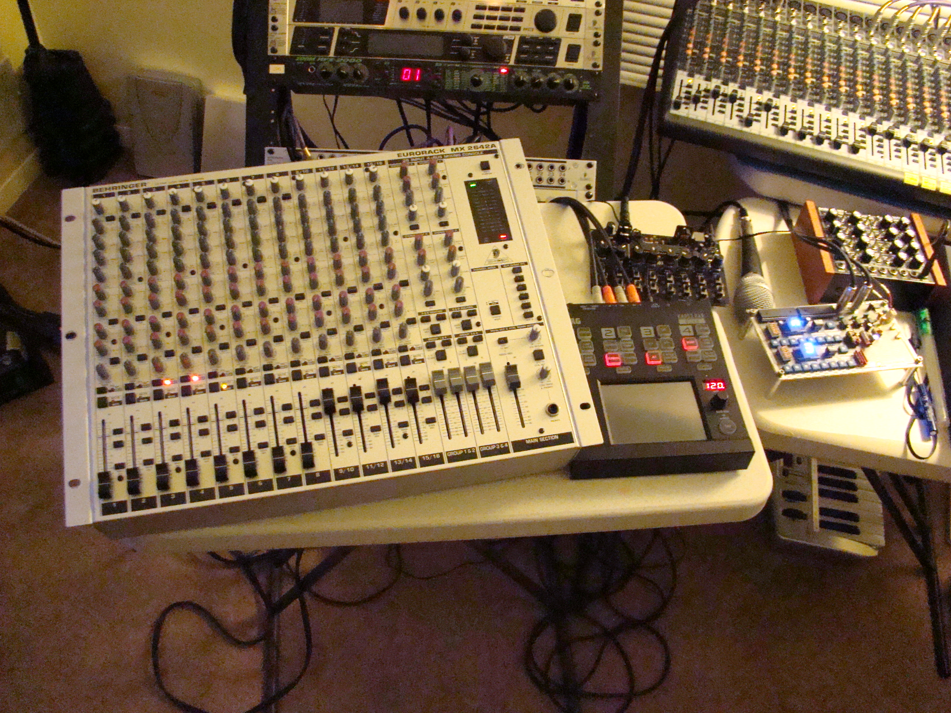

Rob
The article on feedback is very informative and well written. It is certainly a great launch pad for learning to use feedback as a performance technique. I think now between yourself and Dale, I can overcome my fear of annihilating my speaker system Laughing I will take the advice of starting with single feedback loop, massage that a while and record fro those serendipitous moments, then increase the patches in complexity by adding more feedback paths as I get more comfortable at each preceding step.
One of my mixers that I shall use has 4 buses and thus will act as a 4 x 4 matrix mixer. I can then INSERT an FX unit ( a delay for example) into each FB path if I choose to. This will allow for great flexibility.
As for doing a DIY matrix mixer, check out this one by Ken Stone. It is a 5 x 5 matrix mixer that can operate in either bipolar or unipolar modes.
Simple to build and easy to obtain parts.
http://www.cgs.synth.net/modules/cgs33_matrix_mixer.html

That mixer is exactly what I had in mind actually. Ideally it would have a short variable delay on each channel, 50 ms max. You could then combine phase reversed channels to create filters and other effects, at least in theory.
You can create variable delays from 30 to 350 milliseconds with little distortion using the Princeton Technology PT2399 Echo processor chip. I have attached the PDF of the data sheet. I have about 20 of these little beauties. This may be the perfect chip to realize the delay elements for the matrix mixer.
Futurlec has them in stock fro $1.45 USD !
http://www.futurlec.com/cgi-bin/search/search.cgi
This is where I got my chips.
Bill
