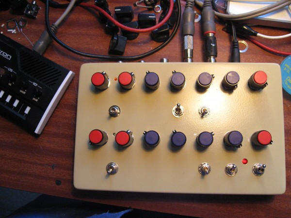

The thing is that I'm using the same pots and switches of the sympleseq... there is enough room for open jacks but I don't like the small presence of the pots in the panel. Too little space for the knobs and ugly movement.
I just need to change the knobs for taller ones. Smile

RV141F-40E3 seems a good choice. Is 25mm long so the pot will be like 1cm long from the panel.
http://www.mouser.com/ds/2/13/RV141F-40E3-18BL-BXXK-185110.pdf
The only cont is that the body is different and I have to adapt all the PCB, but it will not be a big problem.
papaver
Joined: Sep 18, 2009
Posts: 68
Location: Barcelona, Catalunya, Spain
PostPosted: Fri Feb 22, 2013 6:06 am    Post subject: Reply with quote  Mark this post and the followings unread
And it uses washer and nut, so the whole machine will be more solid.

They don't have the 100k audio value. I've been searching for 25mm long pots and there is no option for 5k 50k 100k lin and log. Mad
The only options I can see now are conitnue with the existing ones or going to something like this http://www.banzaimusic.com/Alpha-16-PC-ANG-100k-log.html. It's stronger and more solid but it means to adapt all the PCB and depending on Banzaieffects for now.
papaver
Posts: 68
PostPosted: Tue Feb 26, 2013 1:02 pm    Post subject: Reply with quote  Mark this post and the followings unread
Solved with the tapering method from geofex masters. http://www.geofex.com/article_folders/potsecrets/potscret.htm
Definetly I will go for the RV141

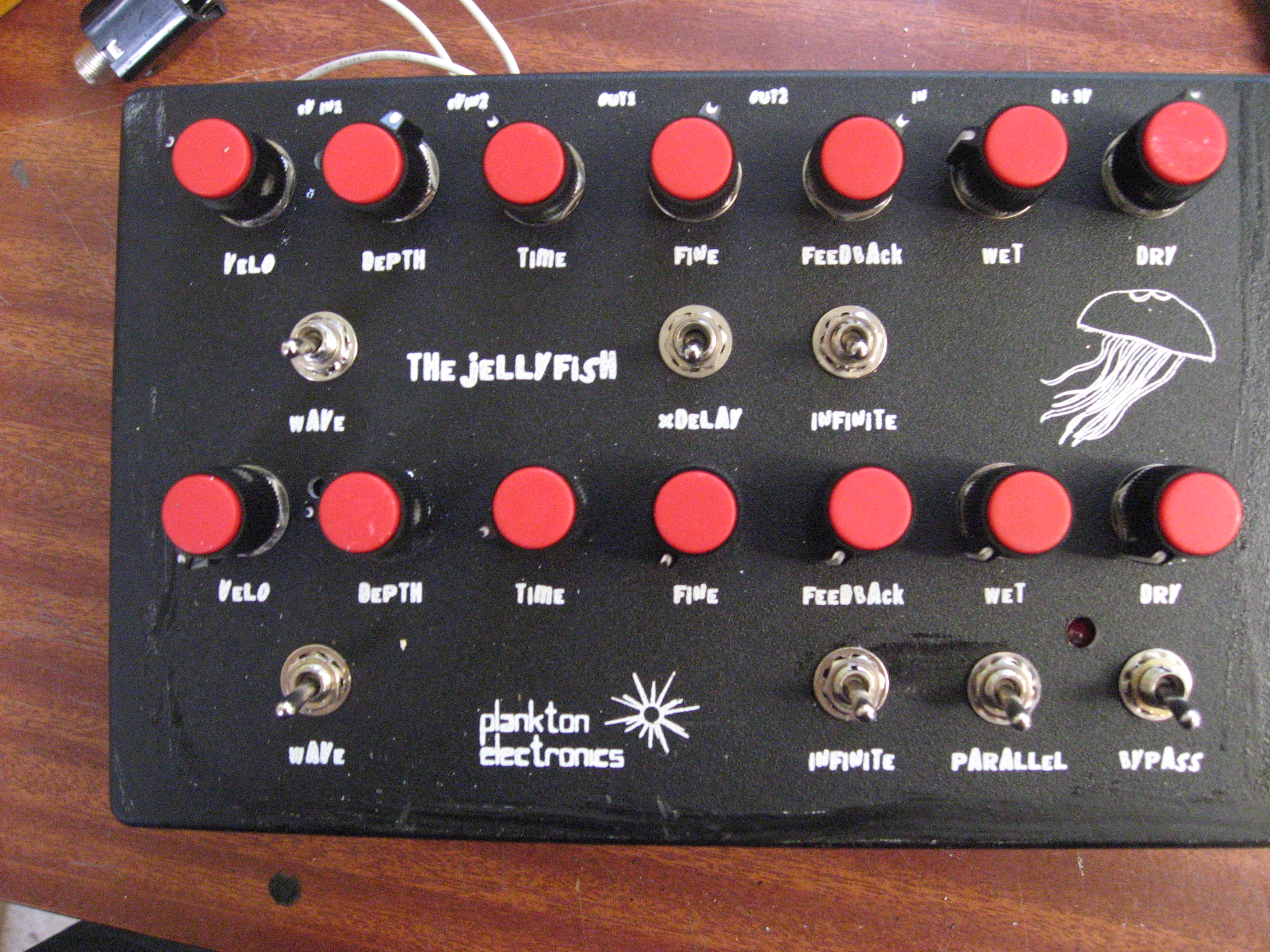

Red knobs prototype.

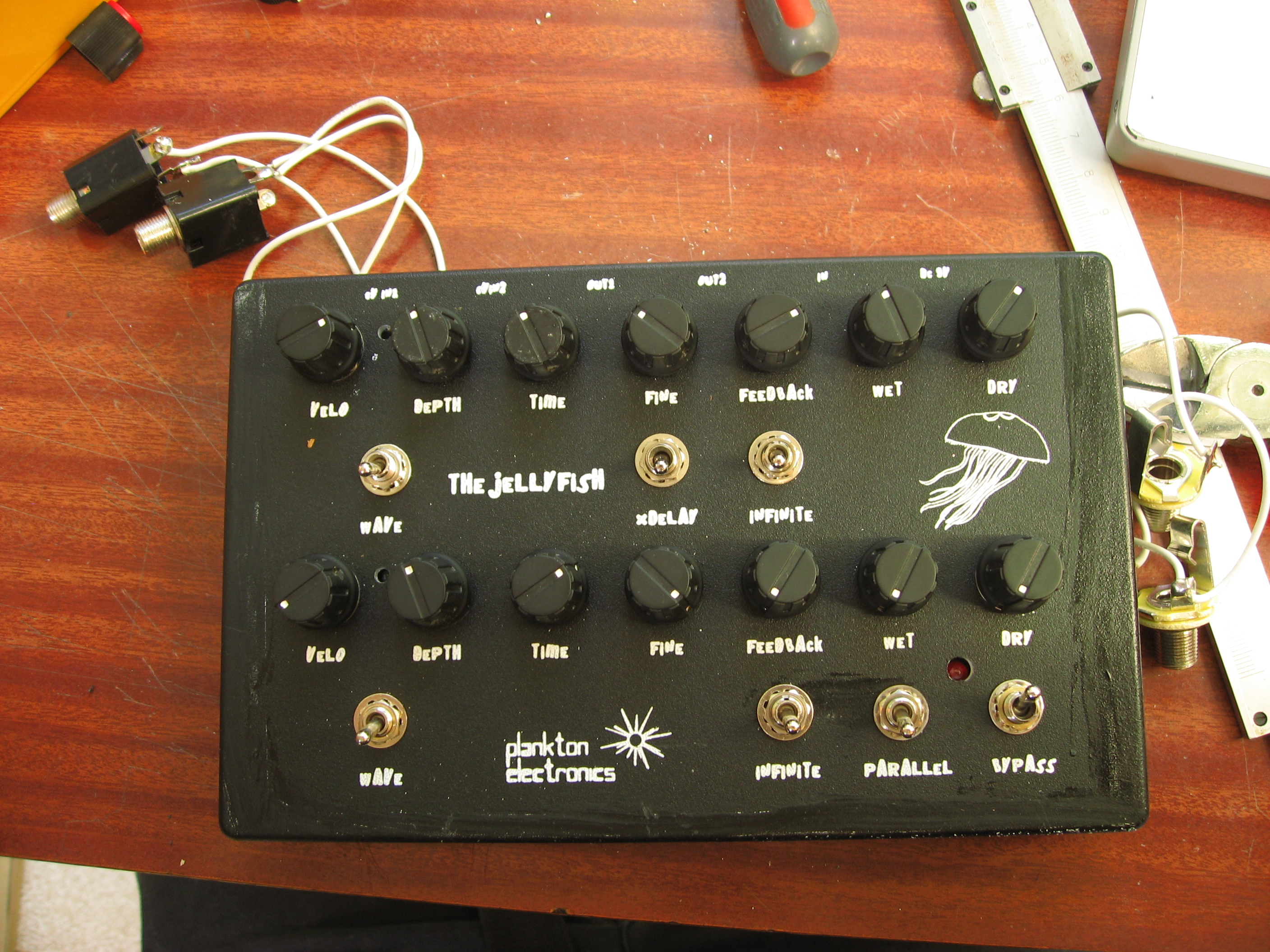

Black Knobs prototype. I love this one.
Note that I have made the silkscreening / painting myself so there are some errors here. But that's not the point now.

Paradigm X
Joined: Feb 15, 2011
Posts: 363
Location: Null and void
PostPosted: Thu Apr 18, 2013 4:06 am    Post subject: Reply with quote  Mark this post and the followings unread
Awesome, the black knobs look great.
