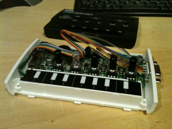

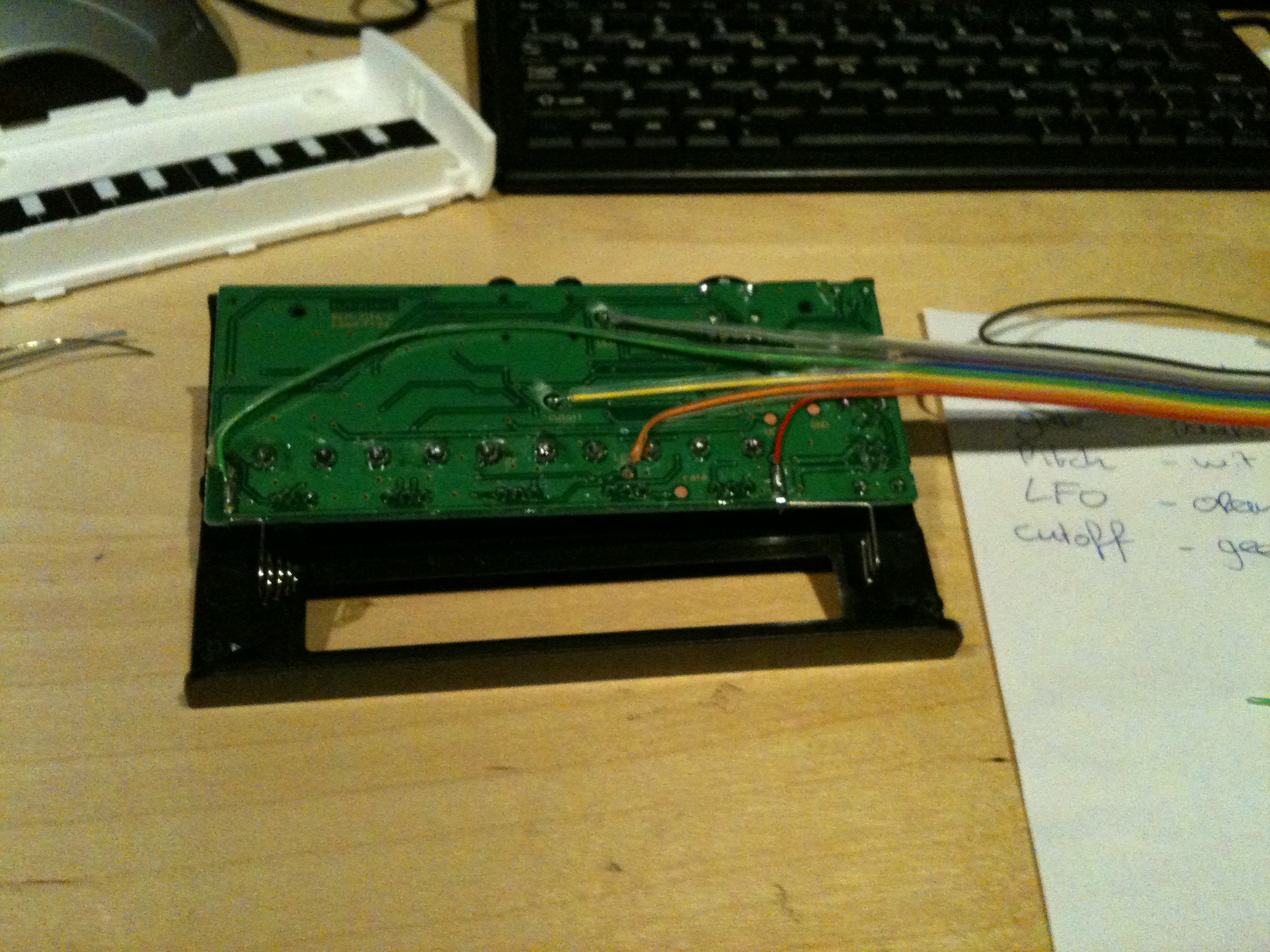

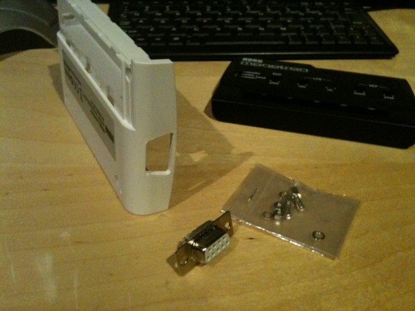

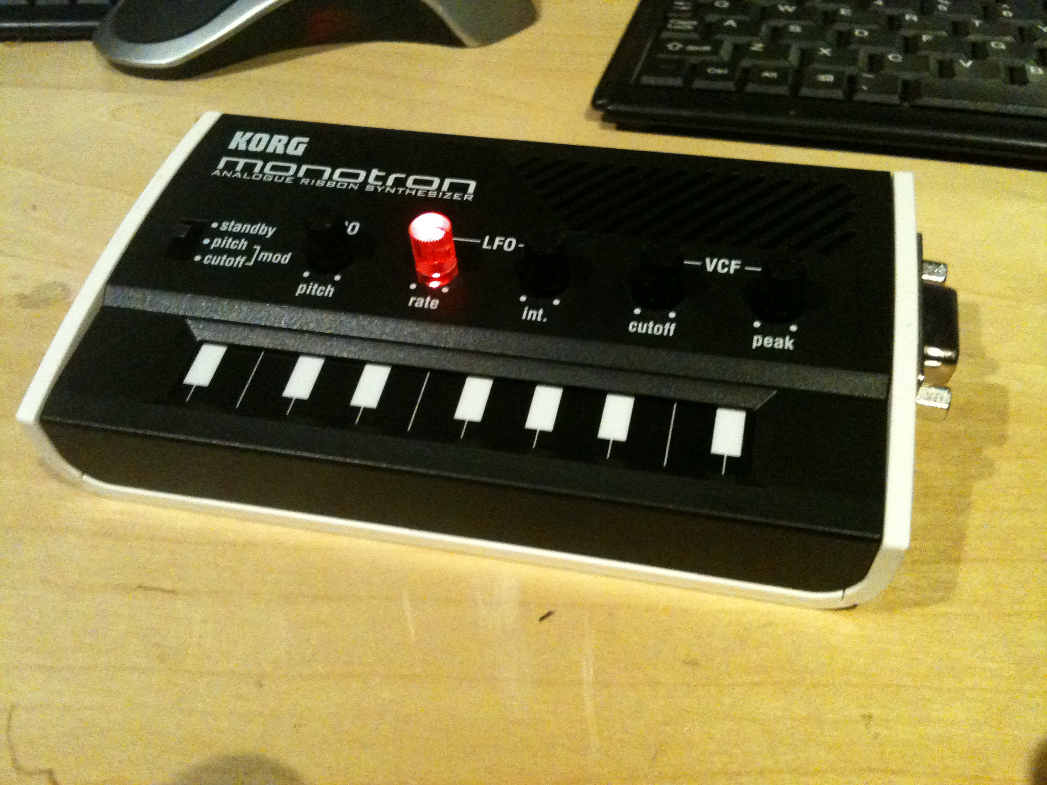

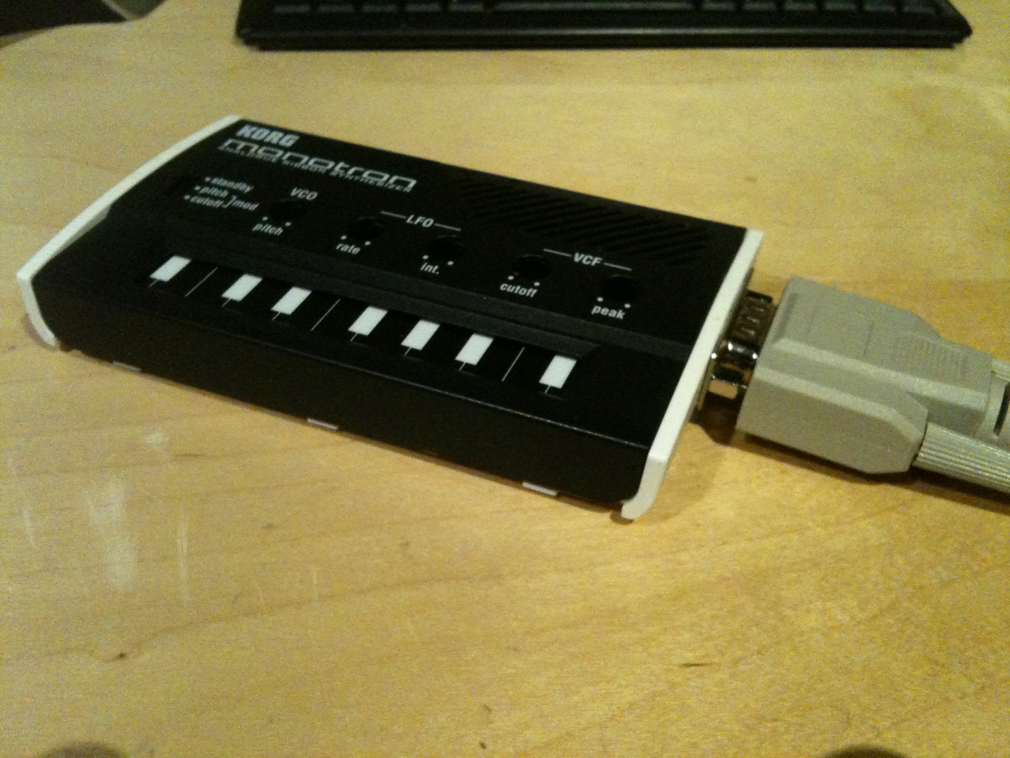

Hello !!
Just started to mod my Monotron so i can use it with my modular synth when its finished.
I use a 9 pin sub'd connector that fits just fine in the Monotron.
With a flat cable i connected the sub'd with the points i need.
(Pitch, Gate, Cutoff, VCO out, LFO out, VA, GND, Vbias)
One wire spare.
Some pictures of the result so far.
Now check some schematics and test on breadboard.

Monotron with PCB and connected subd
 Filesize:  1.31 MB
 Viewed:  1022 Time(s)
Monotron works the same as before with mods
 Filesize:  1.19 MB
 Viewed:  945 Time(s)

UPDATE !!!
Here is the schematic and pcb layout that i want to test.
VCO out and LFO out works fine. (through my mixer, mono)
Spare wire i want to use for audio out. (not on the schema)

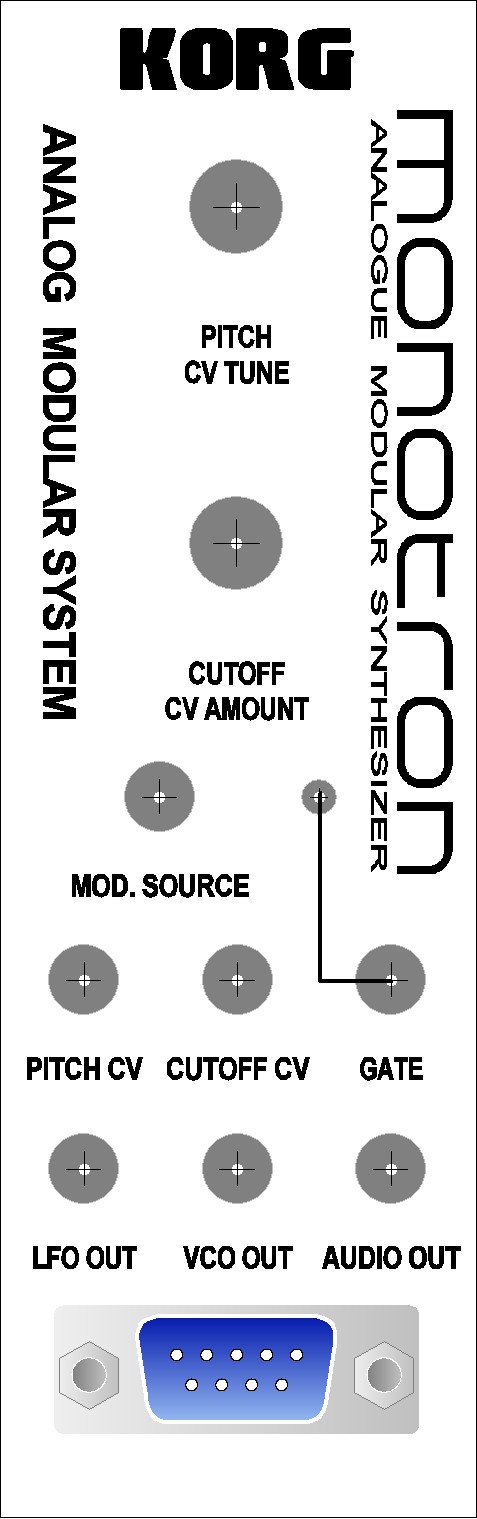

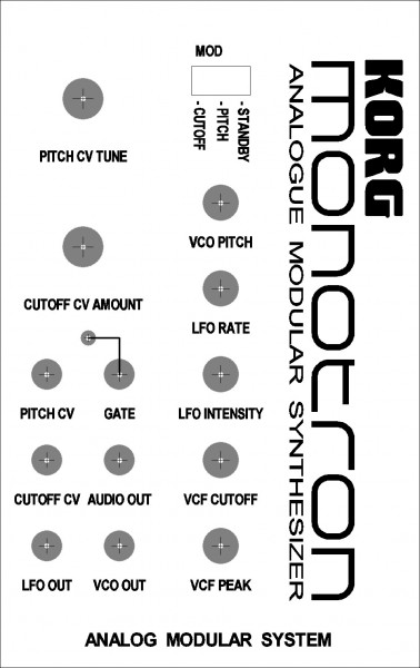

I finished the artwork for the aluminium front and is in eurorack format.
Two layouts i designed, one with the sub'd connector and one complete
with the Monotron. (no ribbon controller)
THESE ARE THE RAW VERSIONS !!
When i have all the parts, a final check.
Grt.
Chris

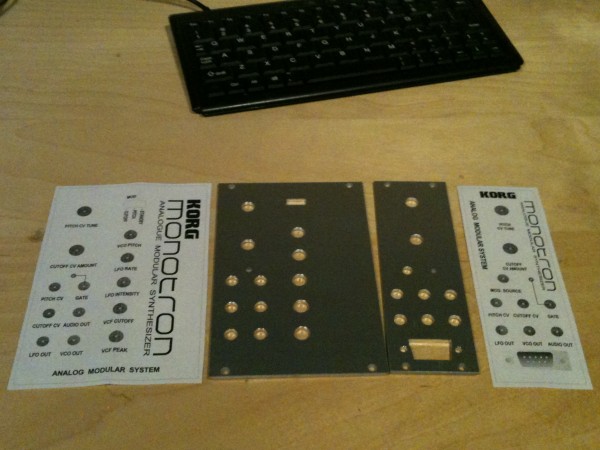

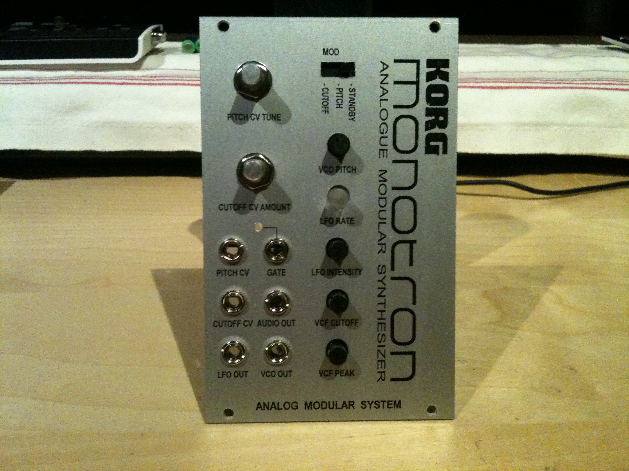

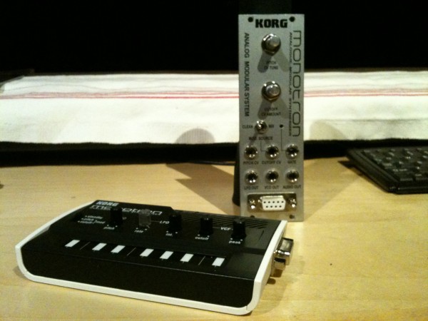

KRS1972
Joined: Sep 27, 2012
Posts: 38
Location: Amsterdam
PostPosted: Sun Mar 10, 2013 8:16 am    Post subject: Reply with quote  Mark this post and the followings unread

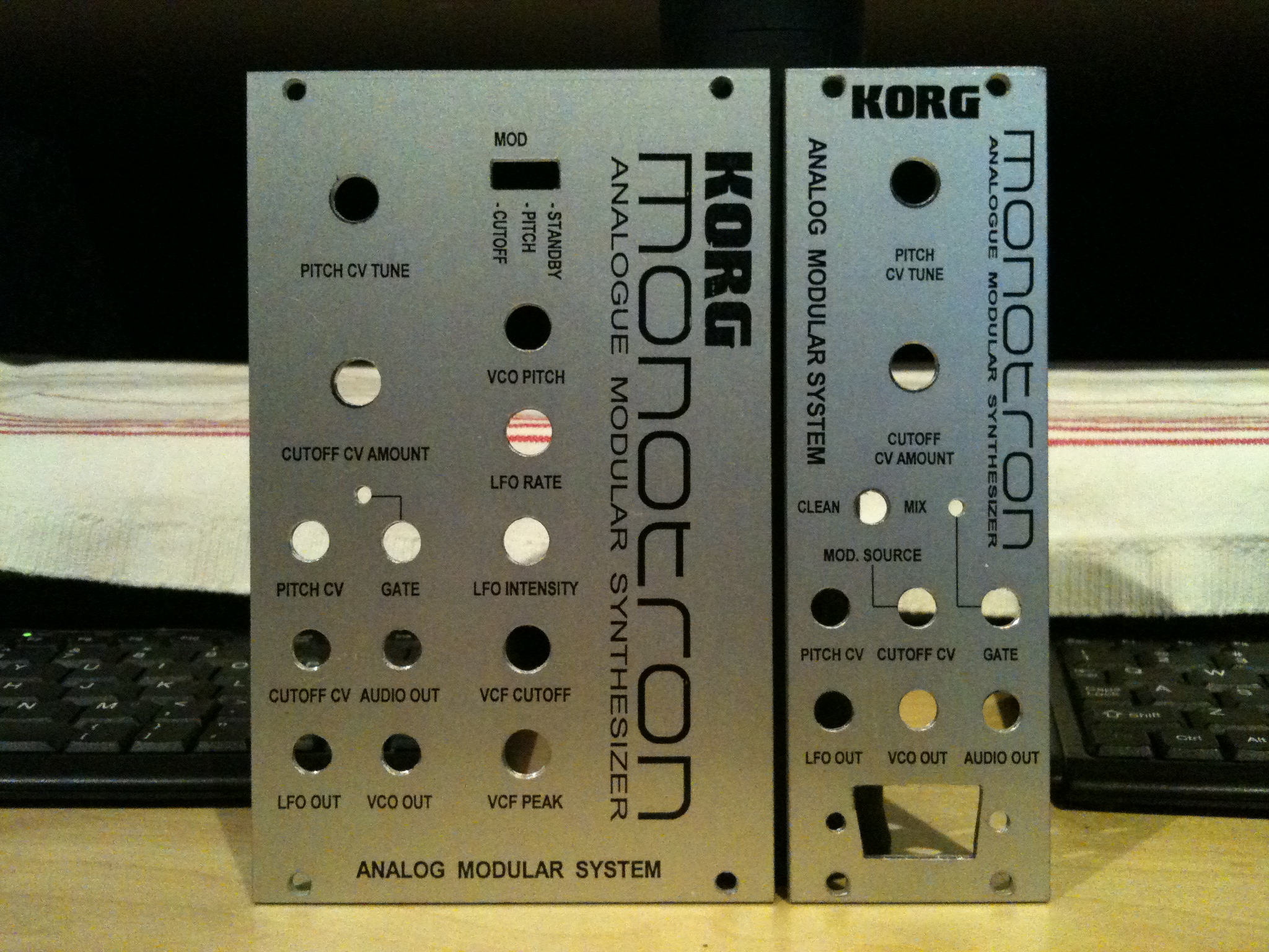

Today i finished the front panels.
Art layouts are ok, sub'd connector a little bit higher so it fits better in the eurorack.
My second Monotron arrived for the other front panel.
The ribbon controller i will use later.
Here some pictures.
Grt,
Chris
 Filesize:  1.02 MB
 Viewed:  905 Time(s)
 Filesize:  1.03 MB
 Viewed:  943 Time(s)
 Filesize:  1.25 MB
 Viewed:  972 Time(s)
 Filesize:  1009.66 KB
 Viewed:  1044 Time(s)

KRS1972
Posts: 38
Location: Amsterdam
PostPosted: Mon Mar 11, 2013 1:40 pm    Post subject: Reply with quote  Mark this post and the followings unread
For my eurorack front plates i always use anodized aluminum.
The artwork on the panel is done with "waterslide decal paper", you can get it for laser and inktjet printers.
After that i spray a thin layer of vernish to finish it.
Grt.
Chris

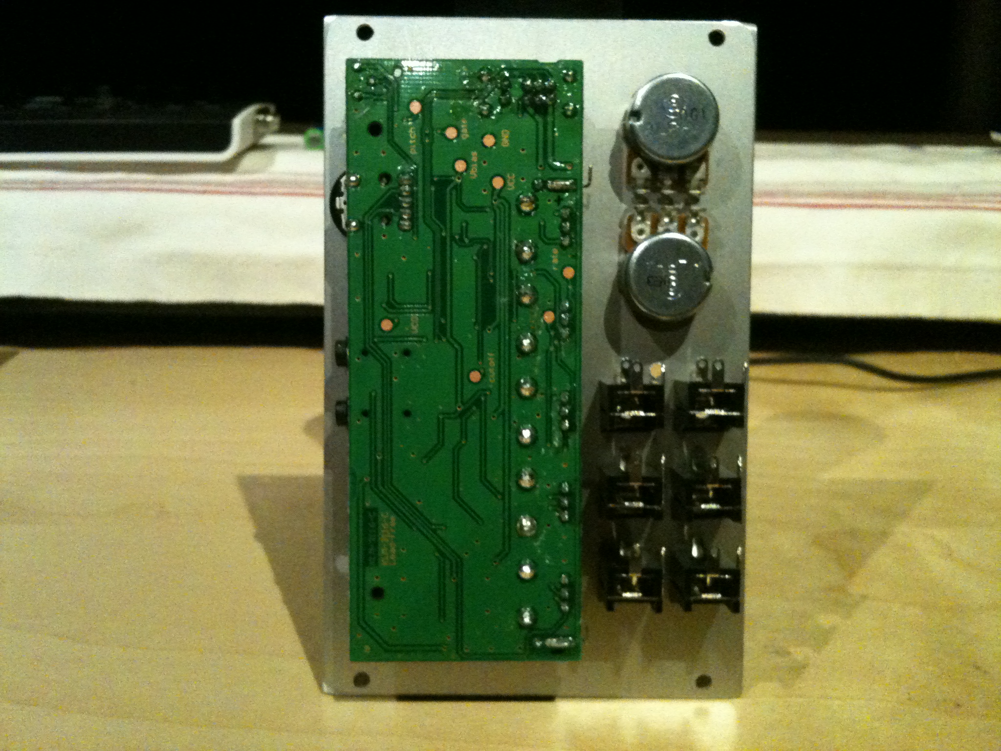

KRS1972
Posts: 38
Location: Amsterdam
PostPosted: Wed Mar 13, 2013 2:05 pm    Post subject: Reply with quote  Mark this post and the followings unread
Here some pictures of the second panel with pcb from the Monotron, pots and jacks.
Grt,
Chris
