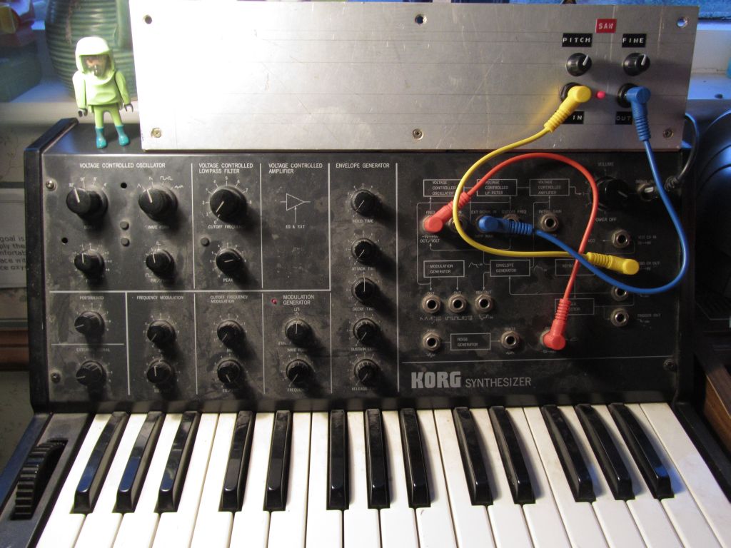

PostPosted: Tue Nov 15, 2011 2:46 pm    Post subject: Reply with quote  Mark this post and the followings unread
Works a treat with the Ms10! I added a fine tune knob to the design by inserting a 10k pot between the 100k pot and 68k resistor at the input.
After i'd built the vco into a faceplate i did a little experiment and fluked a square wave out of the circuit by connecting the saw out to a schmitt trigger inverter on a CD40106 chip. I didn't bother to do the maths as i haven't the equipment to measure the saw at the output but powering the CD40106 from 0v and +9v got me a 50:50 pulse obviously oscillating between 0v and 9v, nice and useful for some audio rate modulation! When i build it into the fascia proper i'll bring down the output to the ms10's 5v standard i reckon.
My enclosure needs work as it has no back yet. Also plan on building a +9/-9v power supply based on the one on MFOS.
