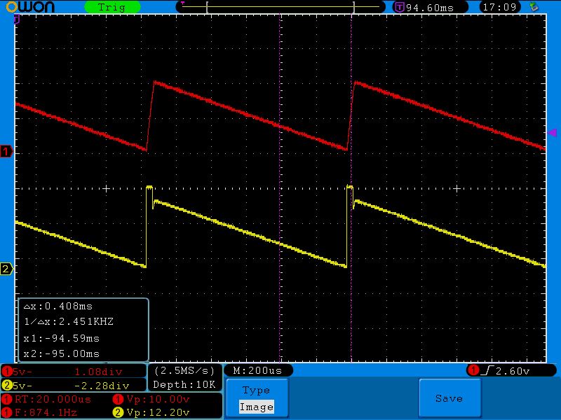

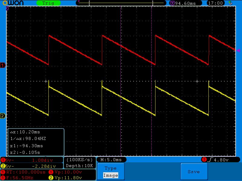

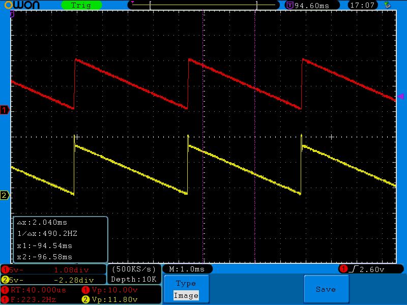

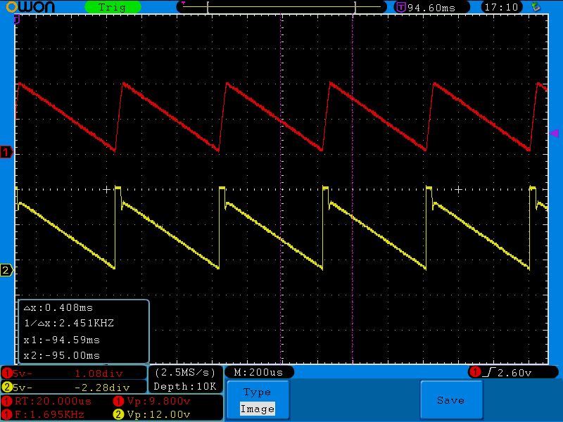

PostPosted: Tue Dec 31, 2013 8:38 am    Post subject: made some new Measurements Reply with quote  Mark this post and the followings unread
i think one of Videos is not the CS Style VCO.
Today i have made some new measurements above the range of
125mV to 8 V in octave steps.
The voltage source is not my DAC to eliminate errors in the Voltage steps.
Voltage Frequency red Frequency yellow
0.125V 56.5Hz 56Hz
0.250V 112.5Hz 112Hz
0.5V 223.2Hz 223Hz
1V 439.9Hz 443Hz
2V 874.1Hz 874Hz
4V 1696Hz 1701Hz
8V 3226Hz 3231Hz
Measured with the Oscilloscop!!
all above 3v sounds detuned.
See Update!!
The circuit was powered wirh an standard linear Power supply no Lab supply.
Greetz
Oliver
125mV

500mV
 Filesize:  85.15 KB
 Viewed:  361 Time(s)
1V
 Filesize:  84.79 KB
 Viewed:  342 Time(s)
2V
 Filesize:  84.25 KB
 Viewed:  350 Time(s)
4V
 Filesize:  87.96 KB
 Viewed:  435 Time(s)
