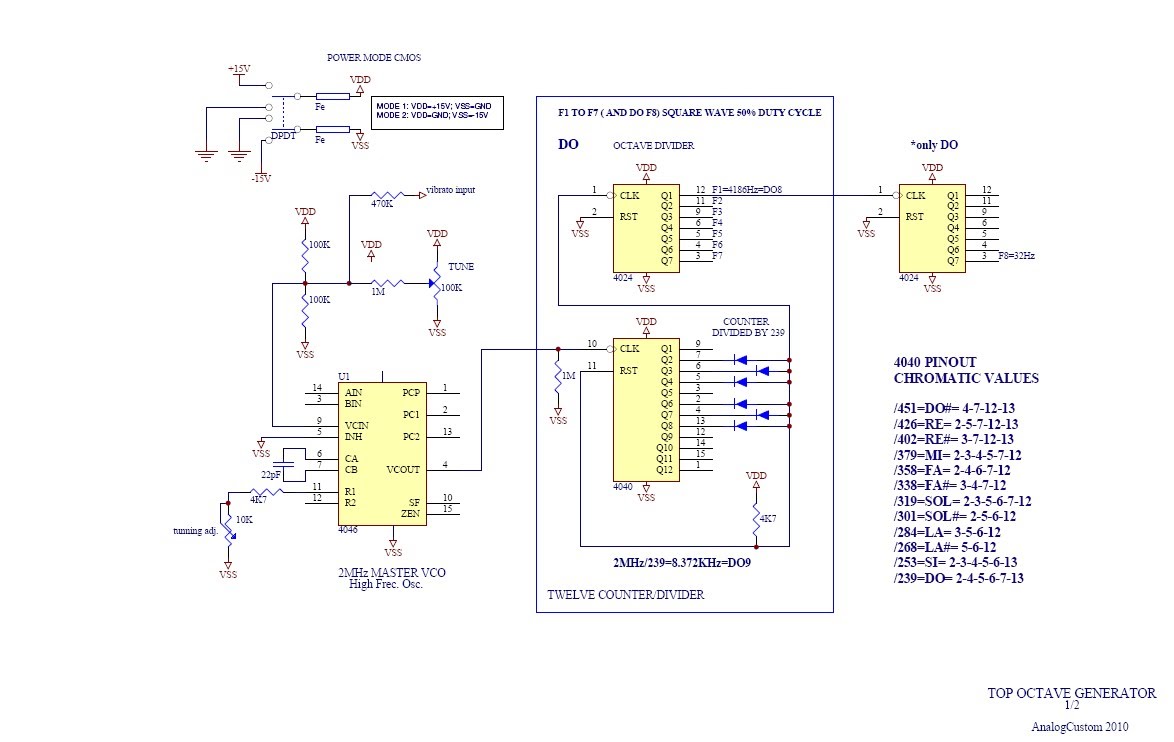

PostPosted: Sat Mar 02, 2013 2:43 pm    Post subject: Reply with quote  Mark this post and the followings unread
Seems like a lot of hardware for a pentatonic scale.
I was unable to find the post the circuit below came from. Basically, it was twelve such circuits to replace the 50240 top octave generator. Built 5 of 'em and there's your pentatonics, all in the same octave, and all of them square waves.

trav
Joined: Sep 11, 2012
Posts: 108
Location: Auckland
PostPosted: Sat Mar 02, 2013 6:13 pm    Post subject: Reply with quote  Mark this post and the followings unread
Yes 12-tone equal temperament has been done, and more elegantly. Thanks for that diagram, richardc64: very useful. The huge divisions are are why I've limited myself to 5 notes. I figure I can make this with just six chips, which I don't think is bad at all.
Rather than a rigorous TOG this is more of an experiment in just intonation and whether a few musical notes can be obtained by ruthlessly applying the same primitive (divide the frequency by three to get the next note)
