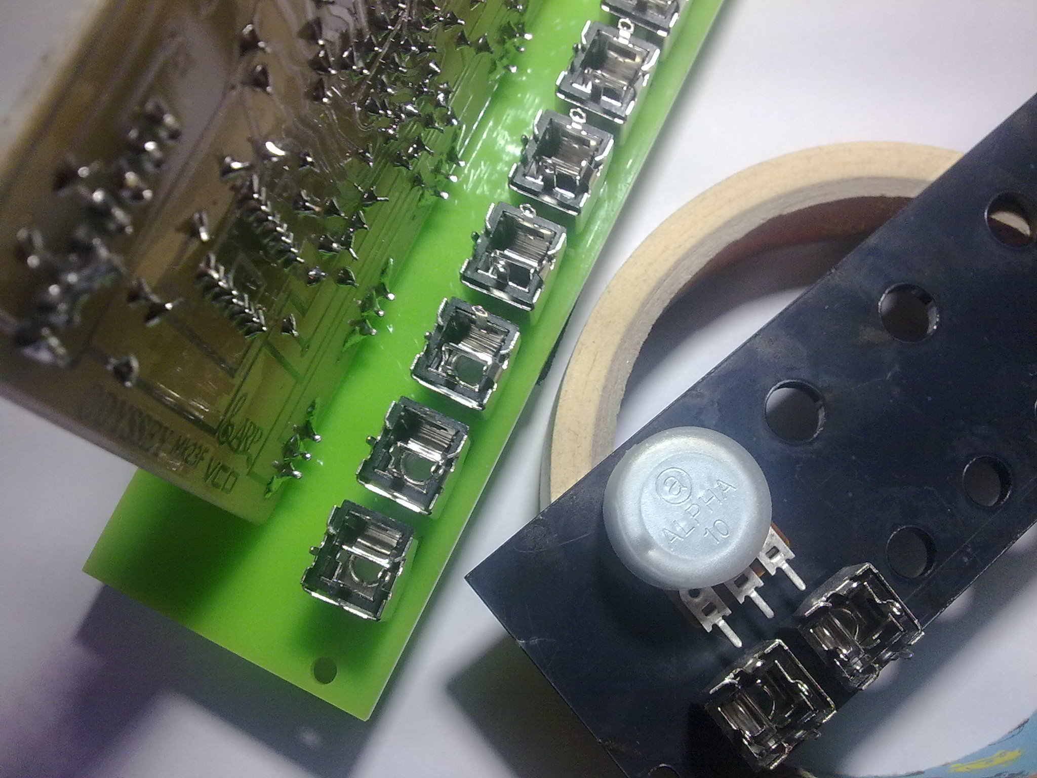

PostPosted: Mon Apr 15, 2013 11:36 am    Post subject: Reply with quote  Mark this post and the followings unread
the aluminum panels are here !! Very Happy

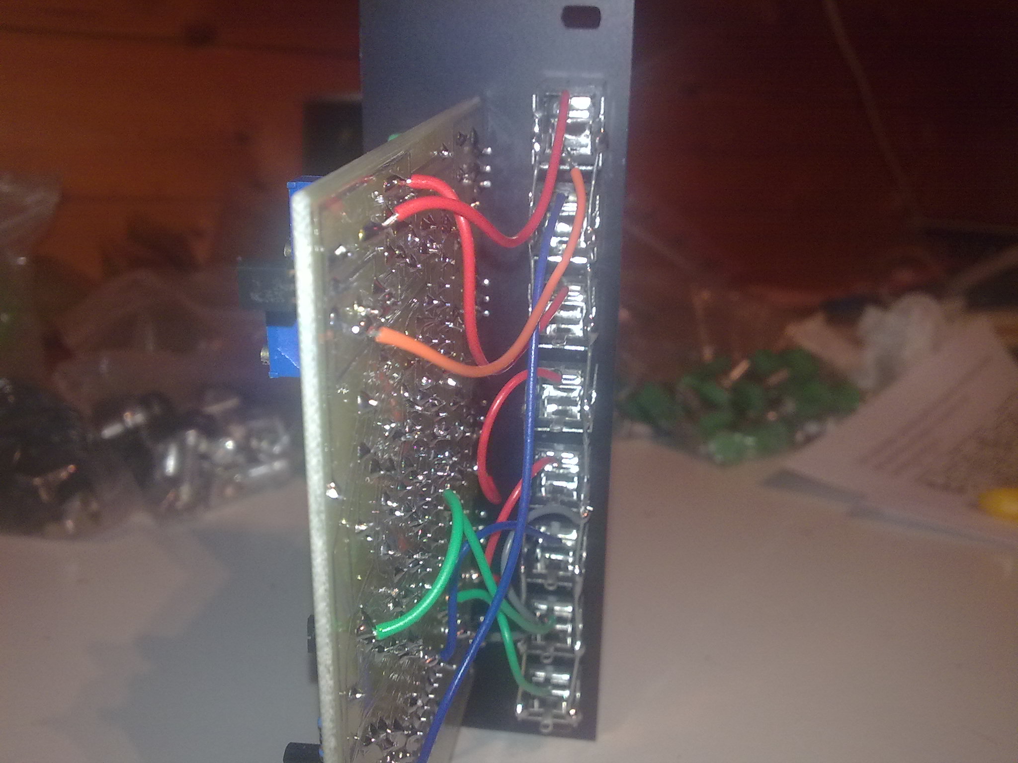

PostPosted: Mon Apr 22, 2013 7:49 am    Post subject: Reply with quote  Mark this post and the followings unread
I am so sorry everyone for my delay in answering questions... I have been working for a whole week on testing and checking my PCB... discovering that the CD4011 by NXP did not function with this PCB. The problem has been solved after I bought a ST.
The panel has enough space to mount the alpha 9 or 16 mm pots.

PostPosted: Mon Apr 29, 2013 2:23 am    Post subject: Reply with quote  Mark this post and the followings unread
Sorry for the delay in reply here too. Smile
Nice looking builds! I thought you had the Ringmod in there as well, hence why i figured it was a tight build. Plenty of room here, great.
Just figured acrylic panels perhaps wouldnt be a bad idea. To avoid the locking between the VCO's especially.
Or - have you guys solved this in any other way?
It gets a bit disturbing at times when you DONT want sync to happen. Smile

furio
Joined: Dec 25, 2009
Posts: 125
Location: Austria
PostPosted: Fri May 03, 2013 2:06 am    Post subject: Reply with quote  Mark this post and the followings unread
I too believed for three years that my dual VCO was great... Though now it just works better... by giving a close ear I would say that the auto-sync could still be improved (I do not know how I should proceed to investigate technically and/or whether I have the suitable lab equipment... I only have a pocket oscilloscope with which I can almost see nothing).
noiselector
Joined: Mar 30, 2013
Posts: 21
PostPosted: Fri May 03, 2013 8:59 am    Post subject: Reply with quote  Mark this post and the followings unread
I think you could use Nomex paper for insulating the panel from the ground board trace as an easy solution ( or you can use Furio's acrylic panels).
Thanks a lot for sharing all your experiments with this VCO board, this threat is getting hot.
Wink
