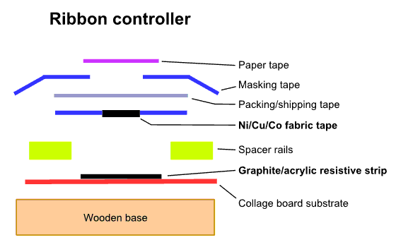

Finding materials for making ribbon controllers can be quite frustrating. None of the anti static bags or VHS tapes I could find had low enough resistivity to be useful. So I looked around for ways to make a resistive strip from scratch. It turns out to be quite easy. Most glues and paints can be loaded with powdered graphite to make them conductive.
The materials I ended up using are easy to find locally. They are acrylic ink (or paint) from the art supply / hobby store, fine powdered graphite from the hardware store and a Sketch & Wash water-soluble graphite pencil, also from the art supply store. The Sketch & Wash gives about a third the resistance of a regular soft graphite pencil.
I've done my first experiments using paper substrates. The acrylic ink also seems to adhere very well to acrylic (plexiglass) sheets, so that will be the next thing to try. The paper must be hard and flat -- any waviness will make it impossible to get uniform electrical contact. The best paper substrate I found is called "collage board". I got the Crescent brand medium weight sheets.
To get sheet resistivities down around 1 kOhm / square, as required for potentiometers under ~50 kOhm total resistance, more than one conducting layer is needed. I usually start by using the Sketch & Wash pencil to load up the paper and then add a layer or two of graphite-loaded acrylic ink. This needs to be mixed up with about 3 parts graphite to two parts of ink. It is critical to get fine graphite powder. I was able to find this at Ace Hardware. The other stores sell a kind with large flakes, which doesn't work at all. You can also find large quantity bottles online.
The paint usually needs some careful fine sanding to get uniform resistivity along the strip. To measure the local resistivity, you can do this: Take a small strip of wood, about 10 mm x 15 mm. Wrap small strips of Al foil tape around the ends to define a small square with the contacts along two sides. Then just use your DVM test probes to push the little device against the resistive strip. This doesn't exactly give you Ohms / square, but it's OK for relative measurements to check the uniformity of the potentiometer strip. With some practice and patience it's easy to get linearity better than 5%.
I usually go over the strip again with the pencil pressing hard to get a well burnished shiny surface.
For the conductive strip that presses against the resistive strip, I found a rather remarkable product. It is called "Ni/Cu/Co Conductive Fabric Shielding Tape" and is available at lessemf.com It's very flexible, has a nice fine uniform weave and has metalic conductivity. I just hang it over the carbon strip between a pair of simple clamps.
The attached drawing shows how I used layers of paper and tape to build up a controller. This is a cross section of the central part and doesn't include the details of clamping and contacting. These are done with brass bars that screw down on top of the conducting strip, and Al foil pasted to the end of the resistive strip with conducting glue made from graphite-loaded acrylic paint. The paper tape on top has a feel that I like better that the acrylic of the packaging tape that carries the conductive tape. I comes from the drug store and is called Nexcare Gentle Paper Tape (aka 3M Micropore surgical tape).
I hope all this at least gives a basis for folks who want to try experimenting with DIY ribbons.

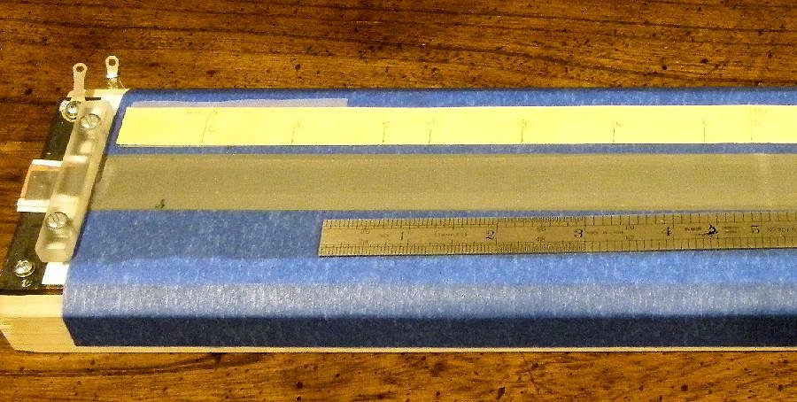

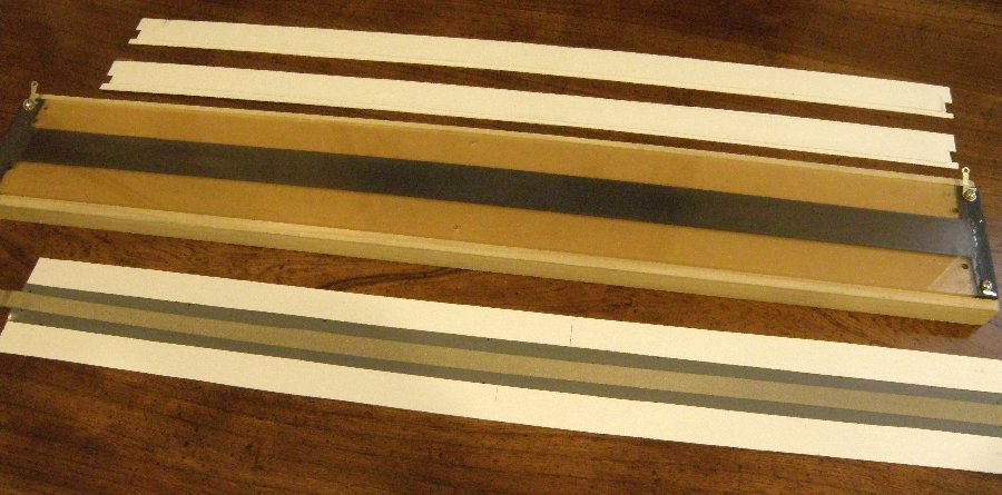

Here's another ribbon version. This one is built on a two foot long base, with an active length of ~530mm. In this version, the resistive strip is painted directly on a plexiglas substrate. It has been carefully adjusted to have better than 1% linearity. The conductive-tape ribbon is suspended over the strip by a piece of rubber cut from an exercise band. This forms a nice and wide and very comfortable, organic-feeling trough for the finger to ride in. The top layer is Nexcare "flexible clear" tape from the drug store. It has a nice tooth so you can feel your finger move without having a lot of friction or bending resistance. This device is an absolute joy to play. It kicks the crap out of the softpot with its narrow, unconfined, hard and sticky surface.
Ian
