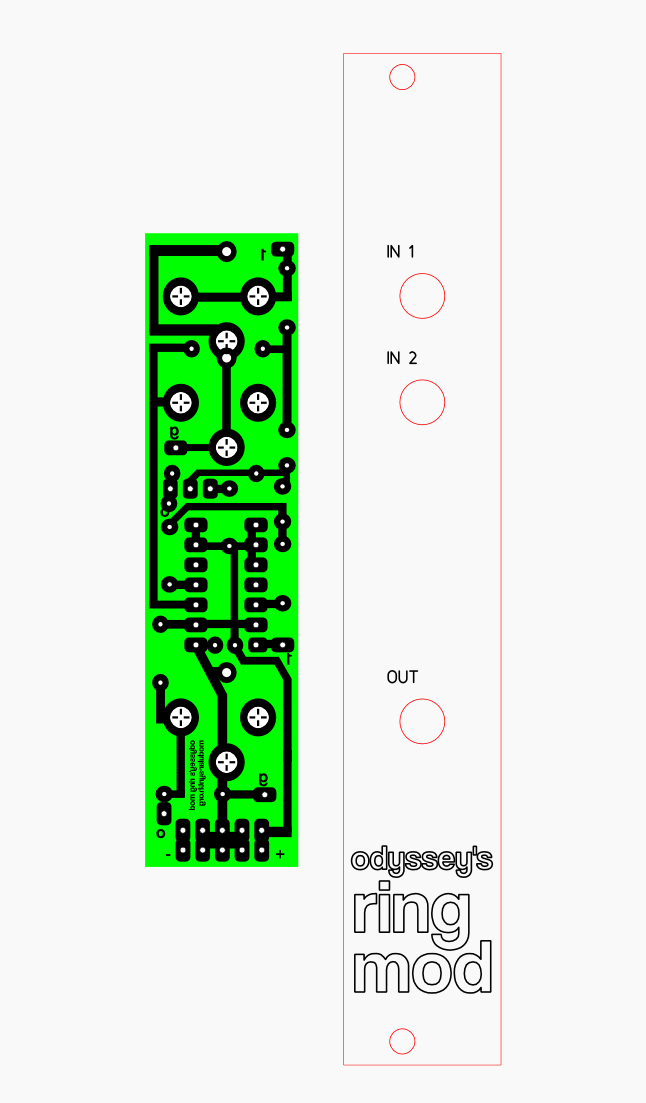

Hi everyone,
I have just finished to scketch the PCB of the Ring Modulator (version for 'Erthenvar' jacks).
If someone would like to help me check it, here is the preview ... The 150K Input2 is to be soldered on the side of the tracks .... The 5K6 and 100n capacitor can be soldered inbetween the socket in the middle/under of the CD4011. The euro power connector must be angled.
