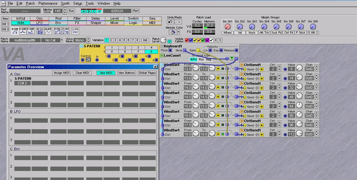

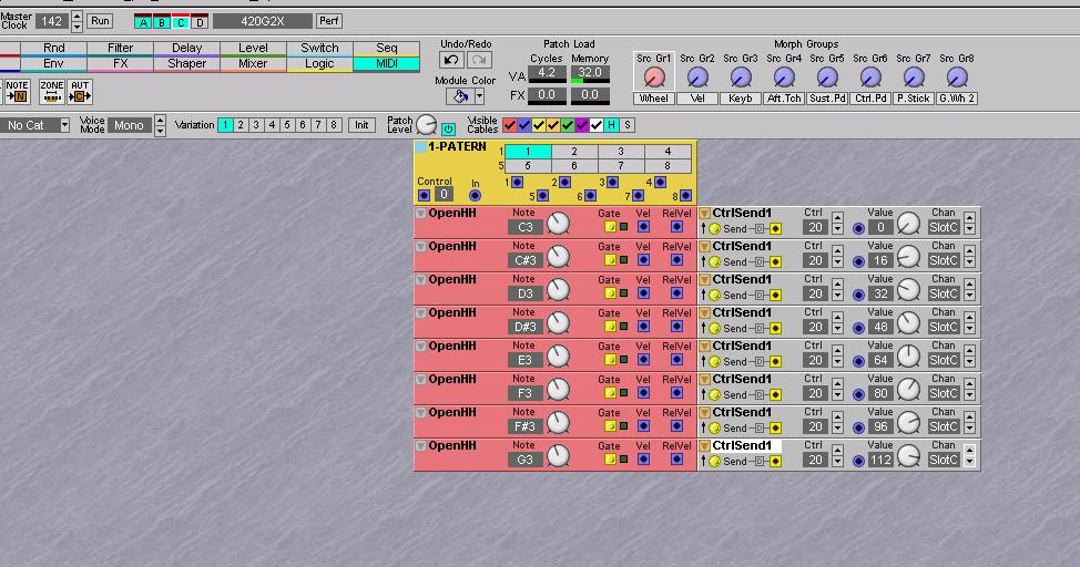

Hey!
I need to change the pattern into a switch 1-8 with the Nord Modular G2 keyboard notes.
I told myself it's will be easy to patch this. I can do it without external help. I spent 3 hours on this yesturday. I did not get a result that works well.
After that I find a patch from Tim Kleinert to Splitting the keyboard within a slot.
http://electro-music.com/forum/topic-57432.html
I edited this patch and now it works! Very Happy Look the patch KeyboardNoteToCC.pch2 or picture KeyboardNoteToCC_Good.JPG
But this method requires much memory Sad

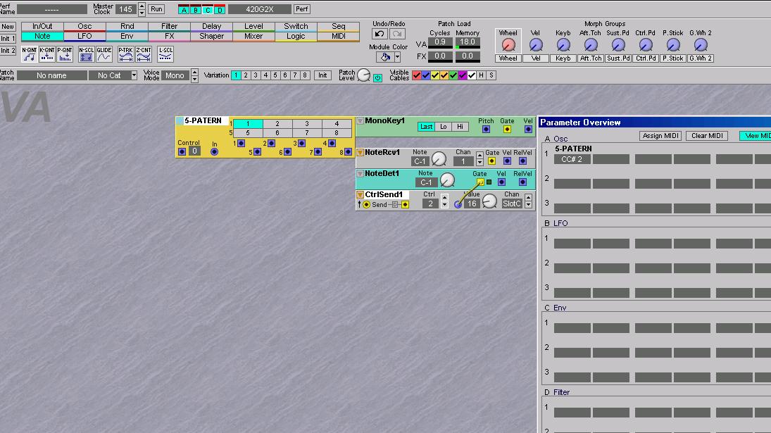

Do you know a solution to my problem that consumes less memory???
Have a nice day all!
Edit : I forgot to say that the patch is working on slot D for now. Note C-1 to C0.
Edit2 : A simple way into the picture "KeyboardNoteToCC_Good2". But memory is at 32%. It's to high.
Unless there is some reason you have to use CC, you could use a Mux 8-1 instead. This has a modulation input so can switch 1 input to 8 outputs. The attached patch shows how to isolate 8 keyboard notes and scale them to the range required by the mux. Adjust the offset control to shift the 8 notes up or down the keyboard (it is set to middle E - 2 octaves in the patch)

Oh yeah! thanks
I made a patch to control 6 MUX8-1 from C-1 to C4. Everything is working good.
I need to change the output signal to bipolar (and use a negative value) from C1 to C4 on the LevAdd module. I dont exactly understand the calculation between the module LevAmp and LevAdd.
