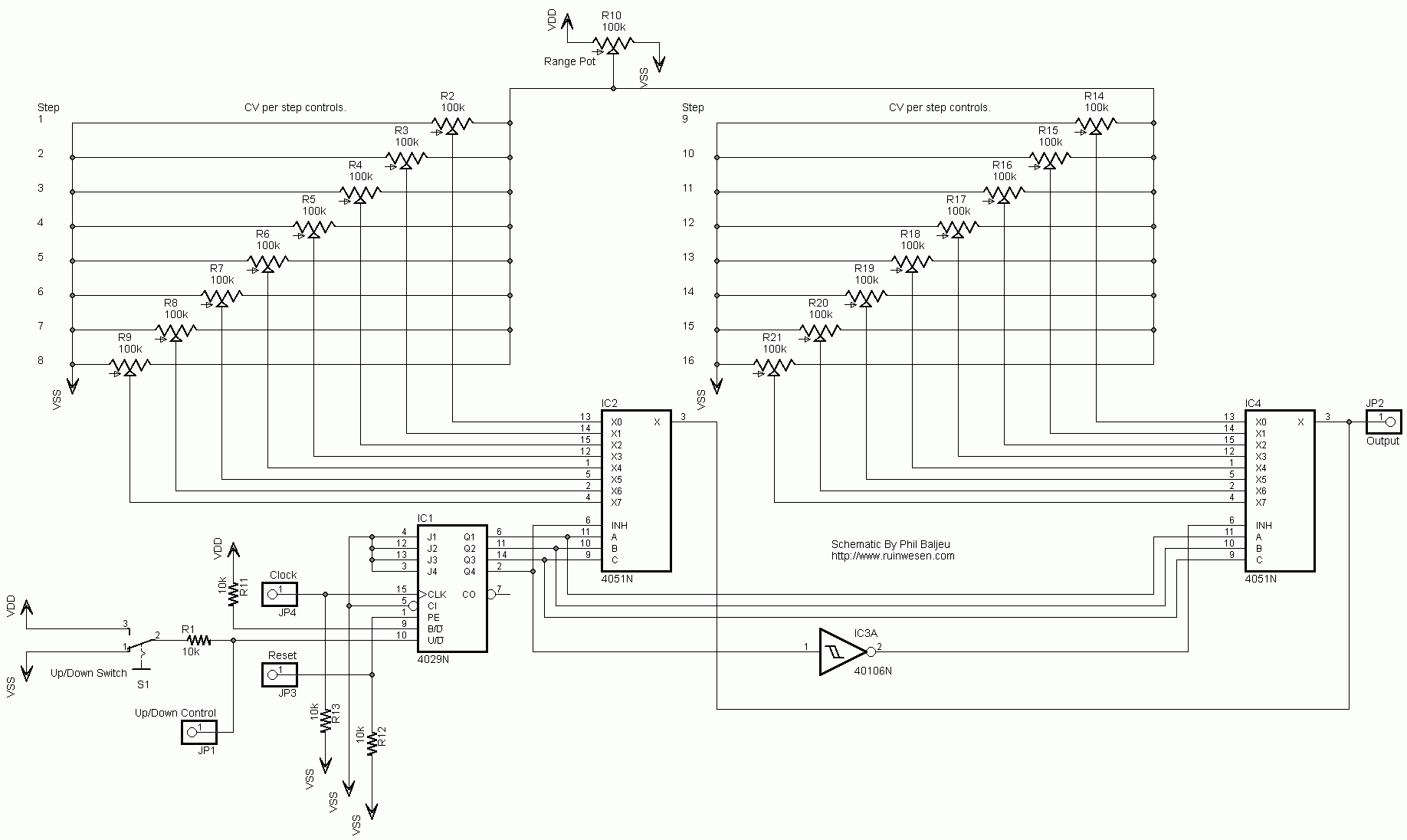

elmegil wrote:
I didn't re-read the datasheet in detail, if the inhibit puts the 4051 outputs into high impedance mode you'll want pull down resistors on the outputs to use the inhibit.
Not necessarily. Yes, if the inputs/outputs are being used to mux/demux logic levels, but if used to select/rout analog levels, as in a sequencer, the non-selected pins don't need termination. The ins/outs of the 4051 are analog switches, like the 4066, so the so-called high impedance state is more like open switches than "floating" digital inputs.
I couldn't find the original posting, but below is a schema using 2x 4051 and a 4029.
 Filesize:  32.04 KB
 Viewed:  387 Time(s)

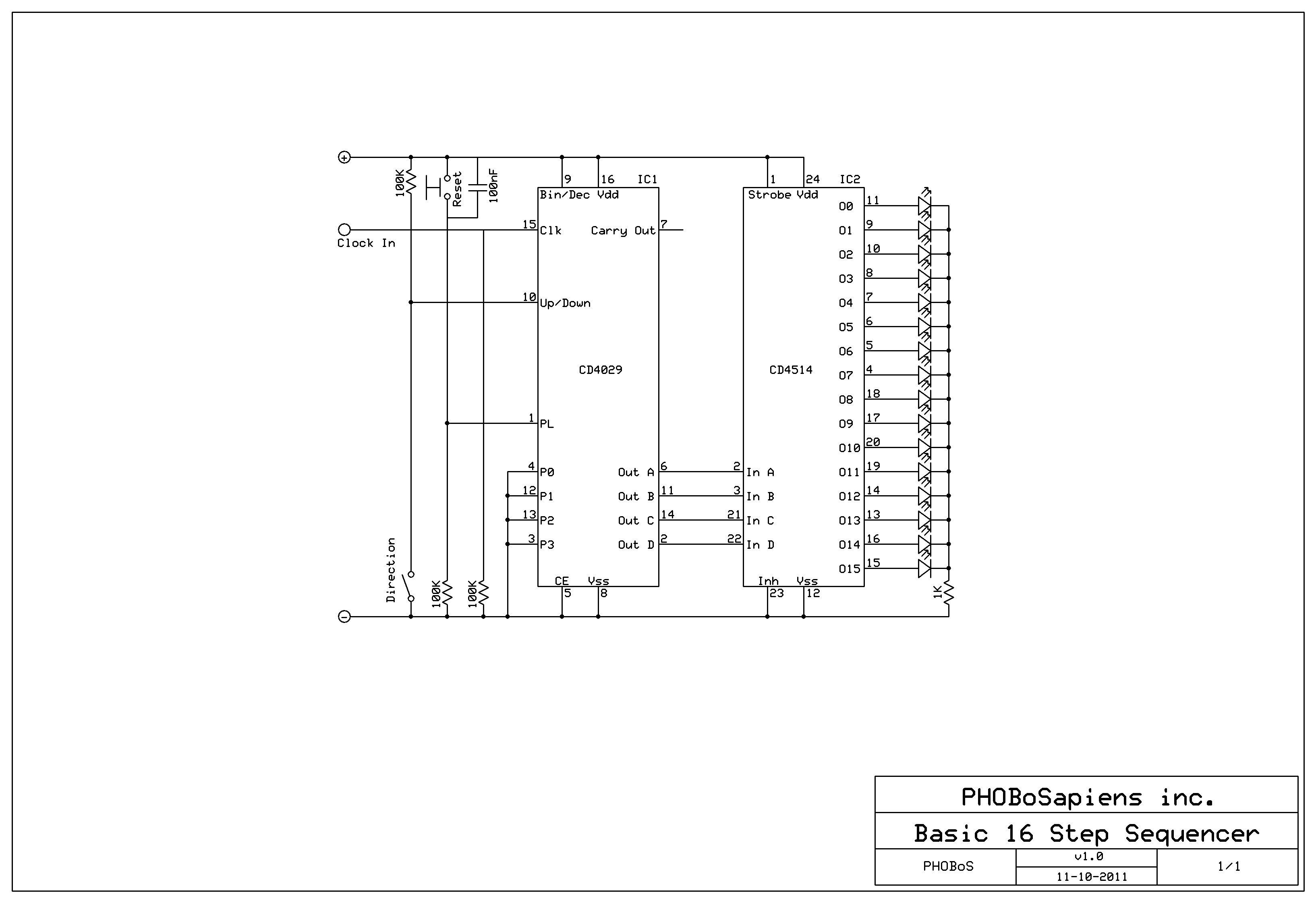

This method is much easier. Just one chip for the demux.
Phobos made this schematic for me when I made mine.
I did look at my schematic today and thought "Did I really need the 4066s?" - obviously not! I built this before I started posting here and I must have learned a few things since then...
Cynosure's/PHOBoS' 4514 solution looks simpler, but this is a gate sequencer, if I've read it correctly, so you would need to add transmission gates in order to produce CVs from this (I think). Please tell me if I'm wrong Very Happy .

The one I built was a gate, but the 4514 outputs Vdd voltage on each step. You can attach a pot to ground on each step instead and use it for CV just like you do with a baby 10.

PostPosted: Wed May 15, 2013 6:27 pm    Post subject: Reply with quote  Mark this post and the followings unread
Thanks Richard, I had my use of the 4051 going backwards, thinking I needed to wire it like the Baby-10. That's excellent.
Thanks for the clarification Cynosure. I've seen a lot of 8- (or 10-) step sequencers based on 4017s in the past, which do include a 4016/4066 switch in the CV output circuitry. I think that I had this as a default "rule" in my mind. As you say, the Baby 10 works without this, so there's no reason why your circuit shouldn't work this way.
