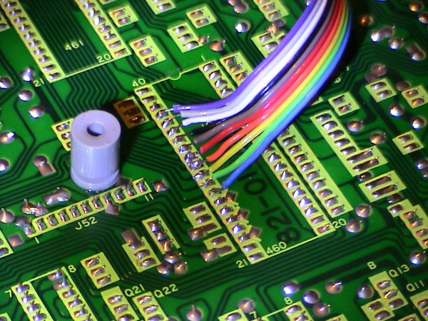

Hello all,
I have an old Hammond auto-vari from the 1980s, not the original with separate boards for patterns/sounds etc, but with everything on one board.
Using my scope I've found out where the trigger for each sound emanates from the big 450 chip. The triggers are negative going.
I just need a little help on how to connect an external trigger here as I'm far from an electronics expert. I'm sure you can't just connect the external trigger directly to the trigger out from the IC, I think I'll need a resistor or maybe a diode to stop the external signal going to the IC and maybe the IC signal going to the external trigger. Any help or hint appreciated here.
Many thanks.

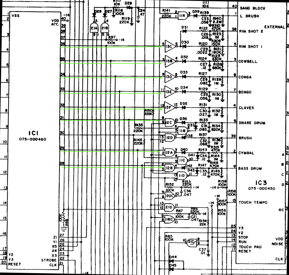

I've got the circuit diagram and service notes now.
There are two ICs that generate the patterns and send out the pulses to the sounds. One is for the main patterns and the other is for the intro/fill patterns. The ICs are connected directly for each sound pulse, or as the manual says:
The voice output of the 460 (IC1) and 462 (IC2) are internally gated so that their outputs can be tied directly together...
Logically, doesn't this mean that if I create the same short pulses I can connect directly to one of the ICs without the need for cutting tracks and adding diodes?
Many thanks.

I've attached a scan of the relevant part of the schematic. It shows where the trigger pulses come out of IC1 and IC2 and where some pulses go through an inverter and some through NAND gates.
The sounds going through the NAND gates can also be triggered externally by the bass pedals and lower manual in the case where this device is built-in to an organ.
Would it be a better idea to send inverted triggers and connect them just after the inverters and gates and before the following diode?
Many thanks again.
IC-11 and IC-12 are 14011
IC-13 is 4069
yes I would try breadboarding that
If you tap off each of the invertor and NAND gate outputs and put each of them through another invertor section say a CD40106 this will give you positive triggers that you can use , I think this is what you want ? i would then buffer each of those new outputs with an opamp
So 2 x CD40106 and 3 x TL074 plus some associated resistors and output jacks. not much more needed i think.

perhaps try breadboarding this attachment i think it should work
R2 -R3 adjust voltage level into the 40106 invertor and may not be strictly neccesary, but those values will keep it above the cmos trigger level and below the rail voltage.
you may need to play with R1 value , it determines how hard the transistor turns on.
The Led and its associated resistor is optional and will depend greatly on the trigger length as to whether it will visibly light up or not.
the diode is neccesary i think, cmos outputs will sink current if connected directly together
so you should maybe connect after each of the existing diodes on your board to avoid any fuss and also avoid having 2 diode voltage drops in line.
