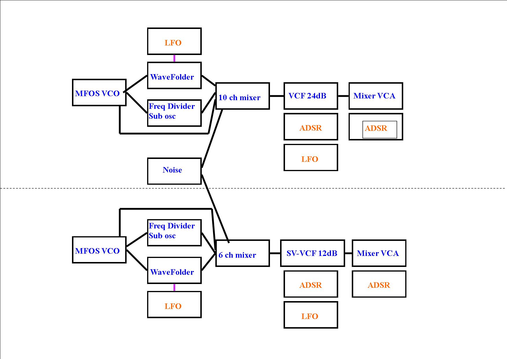

Here is a rough diagram of what i have in mind.
To be operated as .....
2 separate monosynths.
A 2 vco 24dB monosynth.
A 2 vco 12dB svvcf monosynth.
Parallel & series vcf combinations via multi-pole switches.
Once ive built the wooden box and sourced a alum sheet 600mm X 250mm , the project will gather pace Smile

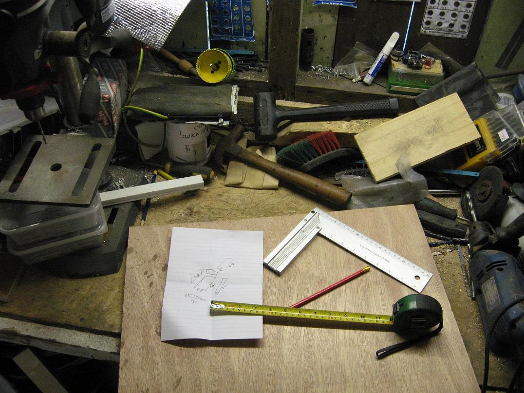

Smile Been in the shed......
I sketched out the design of plywood box to fit in the small space under the ASM-2 synth, then into the shed armed with saw , measuring tape , set square & straight edge & pencil ,pva wood glue , bag of 1" brads / panel pins & hammer. Oh , and nice plywood off cuts from a work skip Smile.
After a couple of swearing incidents and a tea break and this is what i hacked together today.
Dave.

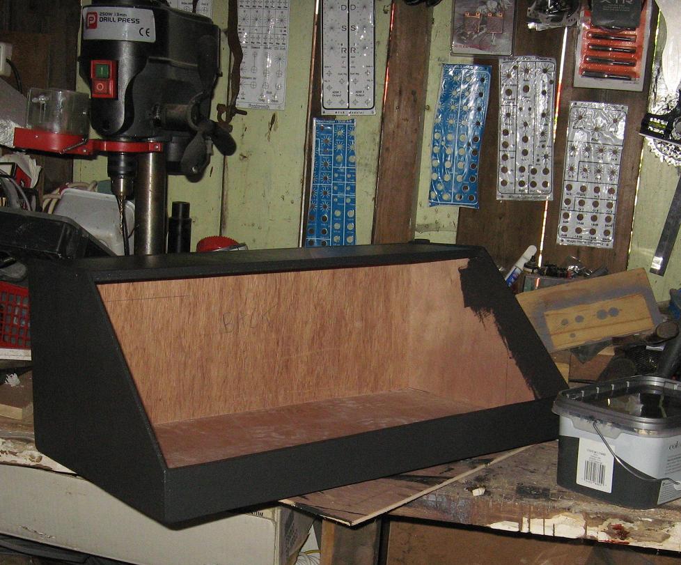

PostPosted: Sat Jul 06, 2013 10:06 am    Post subject: Reply with quote  Mark this post and the followings unread
Hullo , got the box painted with a few coats of dark grey , now ready to bond the wood fixing rails for top & bottom panel support.
Dave.

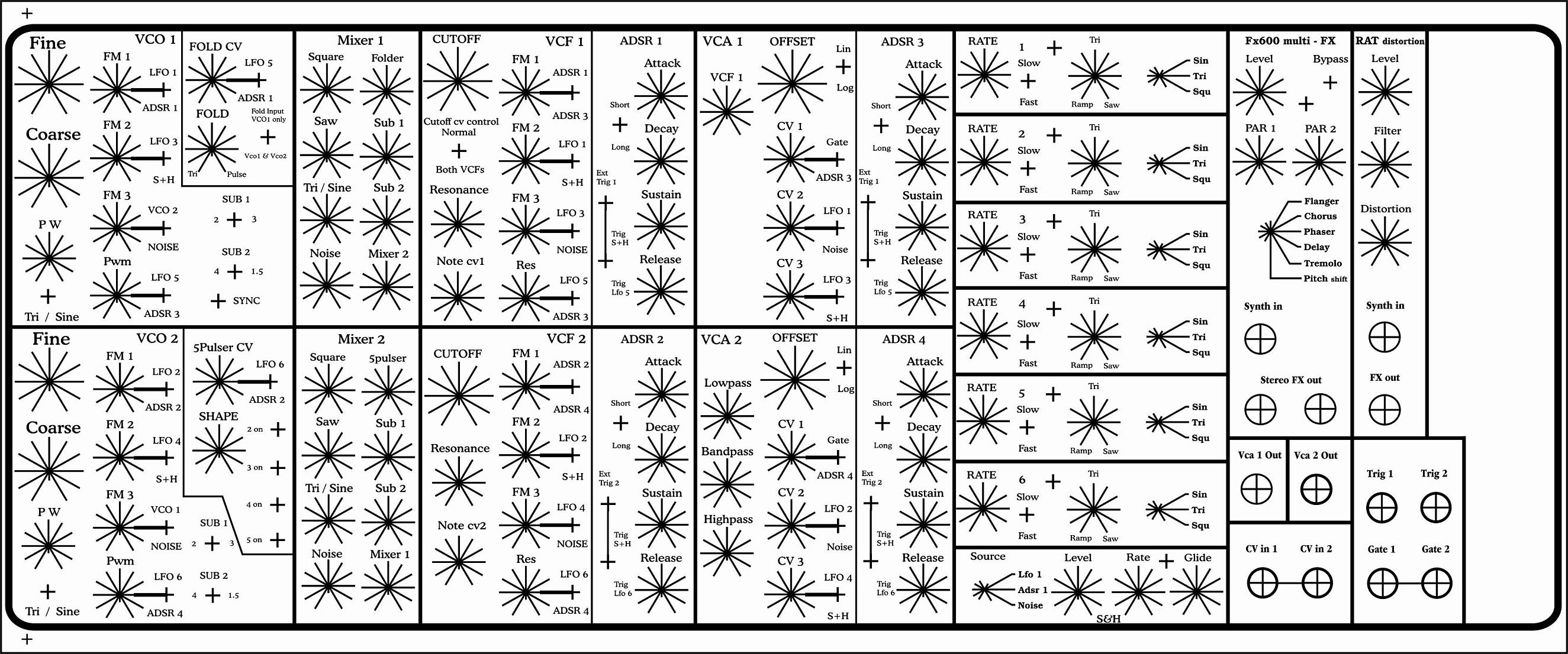

Here is my first draught of my layout for the front panel , i've got it to fit to 250mm high by 500mm wide on 3mm aluminium sheet , leaving a single module space to the right when the panel fits to the box , which is 603mm long inside.
Most of the parts of this synth will come from my main modular , so it's mainly a re- panel / re-wire job with a few extra pcbs to build in the modulation area.
To fill the space on the top right im thinking of using an multi-FX pedal and a distortion / overdrive with ken stone stompbox circuits on veroboard.
I'm going to let this layout simmer for a few weeks until i get an offcut of alum panel from a metal fabricator/engineers workshop.
i've spent a few days with the modulation sources for all the CV attenuators , making sure they are evened out over the destinations, i hope i've covered all my usual patch configurations with this layout Smile
Dave.
